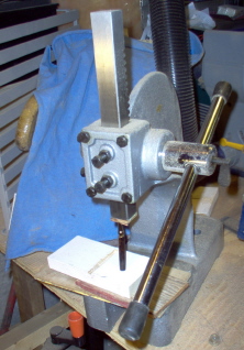

Anyone have a picture of their set-up for using the HF Arbor press.
I do not use any special plates, just blocks of softwood or softwood plywood. I epoxied a piece of plywood to the bottom of the ram:

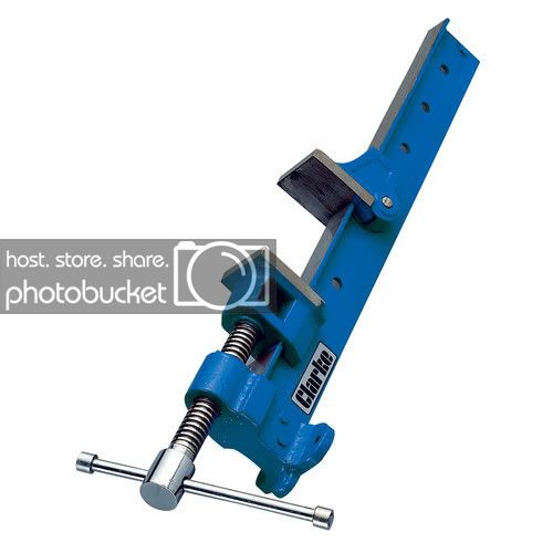

I have used a pen press, arbor press etc., but I prefer my sash clamp as I have more control/feel of the pressure I am applying. Picture of a similar sash clamp below.
