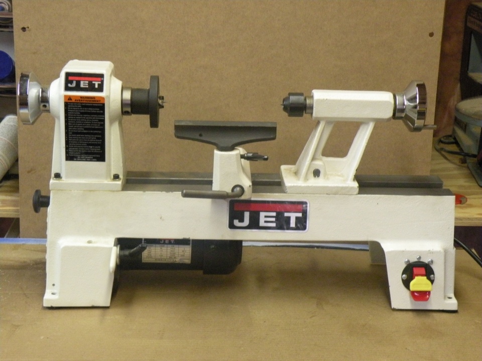

I currently have received an offer about a jet 1014 mini lathe. The guy is asking $225. This is not the variable speed 1.
anyone else have this jet lathe? I plan on going to look at it tomorrow is it worth $225 and what are acceptable run out on the tail and headstock?

can anyone tell me what an acceptable run out it is on lathes like this? I have a dial indicator I will bring with me to check inside and outside of headstock as well as tailstock and factory centers. I know that my old craftsman table saw has a runout of 9 thousands and I can notice it on my miter joints a little.
What is good or at what point would the runout be to far out of whack? The owner says he bought it a few years back it has never been used! Says his lowest he can sell it for is $200. The picture he sent me is attached.

Started on a 1014 and graduated to a Delta 46-460. If the budget is limited, the 1014 will do fine. Unless you can feel lateral movement in the headstock, I wouldn't worry about it. If it has a deadcenter, or you have one, pinch a razorblade between the deadcenter and livecenter in the tail stock. If the blade will stay in a vertical position between the two points, the alignment is perfect.

i bought the jet
Very excited about this purchase yet I have not turned anything on it yet. The plastic protective thing it's still on the jet logo in the front. Brand new! Razor blade test passed the blade tilted just a tad bit stayed between centers. Less than 2 thousands of runout on the head and tail stock.
I do notice that the tool rest and tail stock don't slide smoothly. The bed is clean because the lathe has not ever been used. Any tips on getting them to slide easier?
I apply a film of BreakFree to the bed. Can also use that on the tool rest & tail stock.
