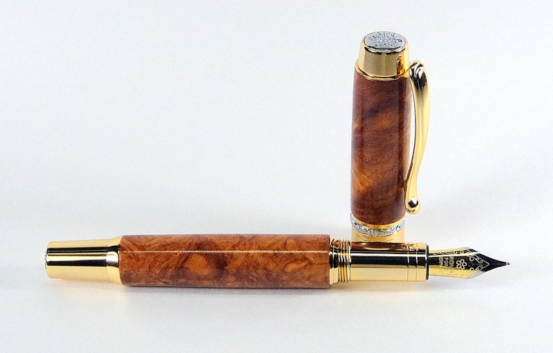

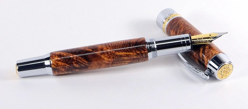

The mechanics attended to I use two calipers ,I never rely on the measurements given but measure off each end of the kit (To be sure) I have found variations.
Just finished these two it paid dividends for me.
My task for personal use two fountains ,matched nibs for different coloured inks.
Kind regards Peter.
