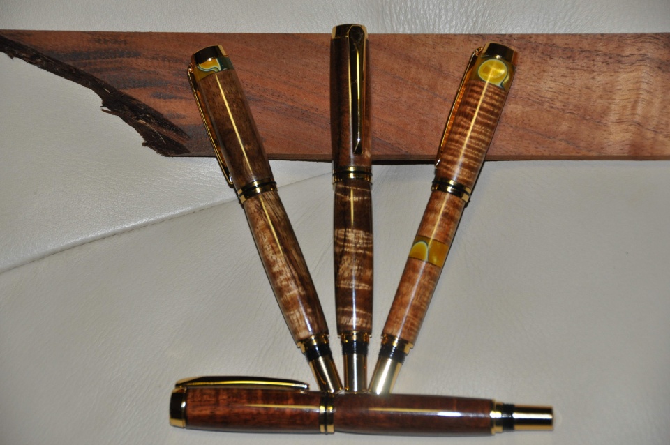

Here's what came from my time at the lathe.
