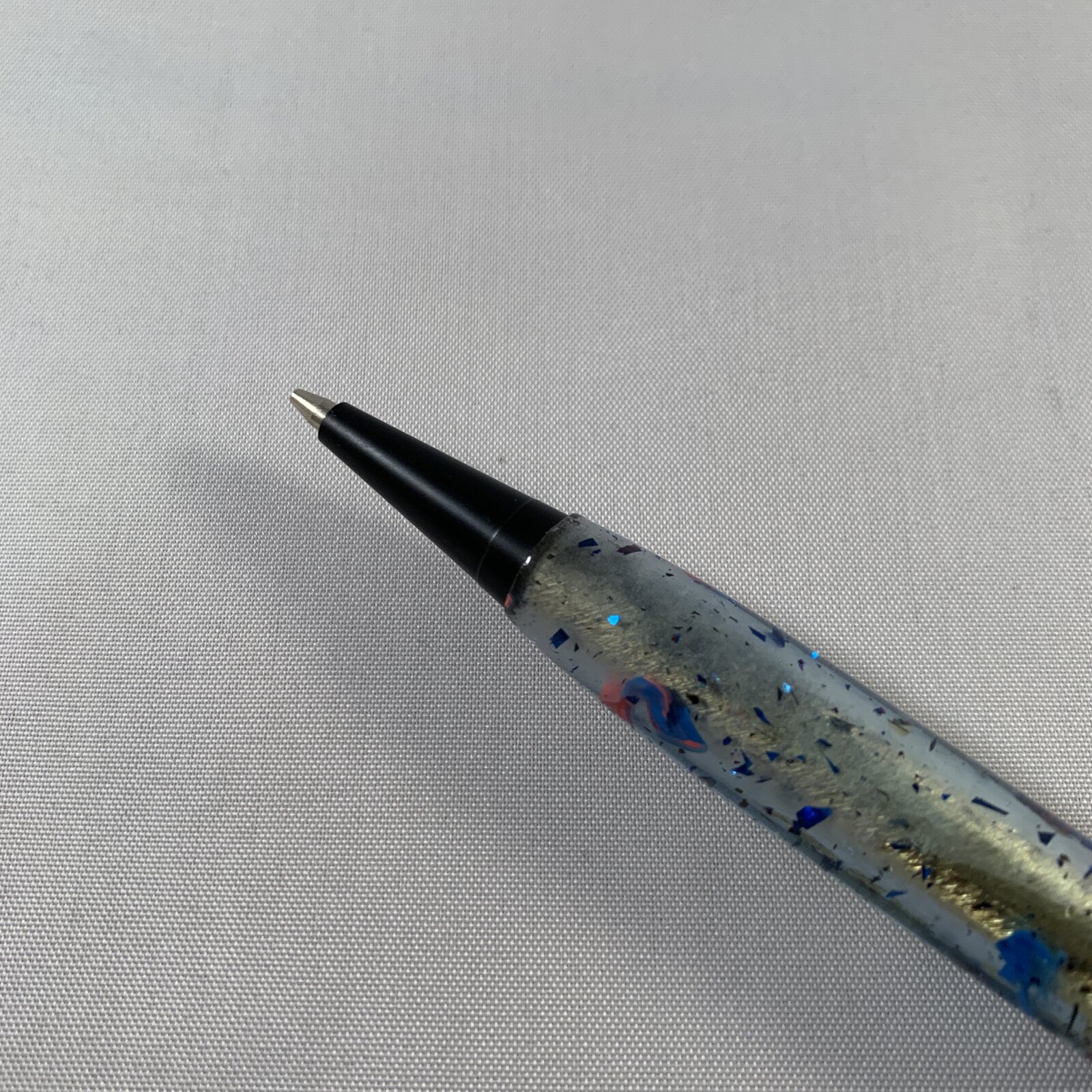

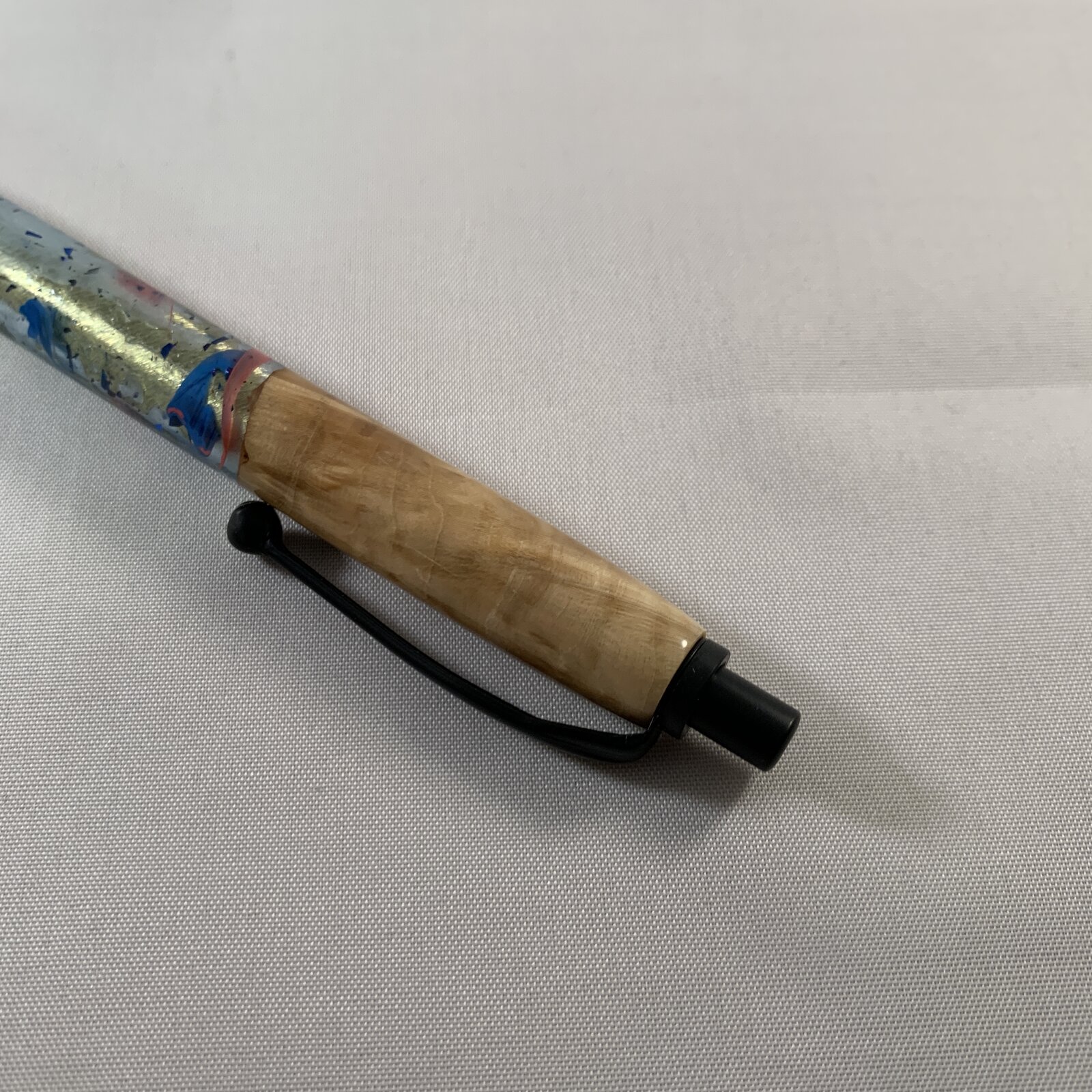

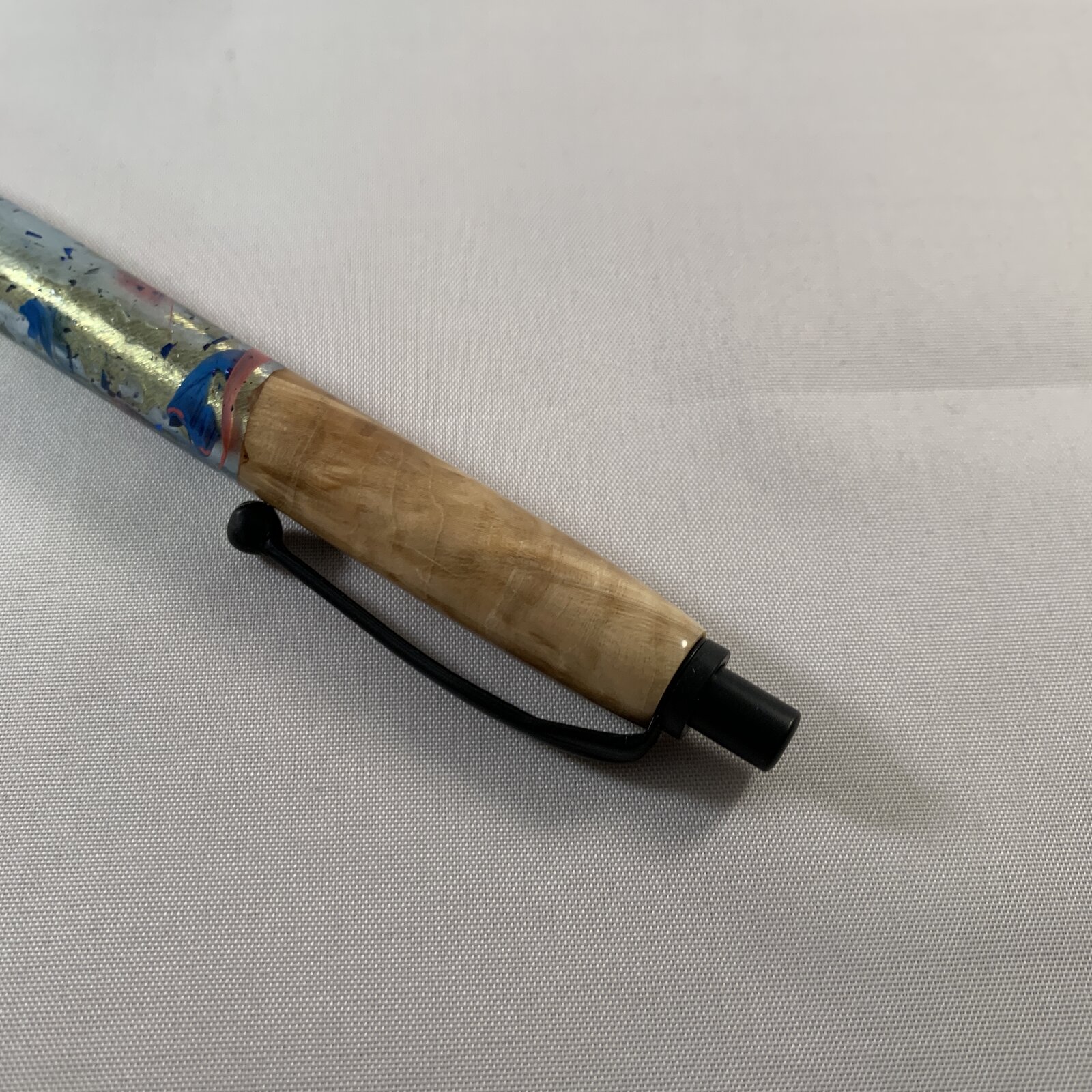

Hello, I have recently started making pens and pencils. Over the past month I have developed my method for finishing (2 coats of thin CA & 8 coats of medium CA), followed by micro mesh, and then plastic polish. This often given a beautiful finish, but seems too affect my transition from kit components to blank. This could also be my fault by not turning the blank down enough. I have a square carbide rougher, round carbide tool, and diamond "detailing" tool. Usually Ill use the square rougher to get as close as possible to the bushings, then take light passes with the rounded tool. Followed by 180-600 sanding, at this point it usually appears to me that my blank is even with the bushings. Yet, once I assemble the pen after finishing I often notice the slightest overhang from blank to cap, center band or nib. Any tips to help get the blanks perfectly lined up with the bushings so there is a seamless transition. Here are pictures showing what I am referring to. Thank you all for the time and help, I'm excited to learn!

It looks like the top and bottom are proud quite a bit. Get a caliper, dial or digital and measure the metal parts where they meet the blank and turn the the blank to that dimension or a little less. Then do your final sand and CA . Or for that type of pen leave it slightly larger and slightly curve it down to the metal. Sharp edge then is not an issue, it makes a better looking pen, I think.

I'm definetely far from being an expert, but here's my observation. I can clearly see the brass tube through the front end of the pen. Maybe this tube should have been painted before. So I'm assuming the blank is some type of acrylic. Why, then...10 coats of CA. I'm thinking finishing without CA, just MM. Back end is wood and not turned to bushings. Sounds like you have some expensive turning tools and nervous of getting close. I turn with cheap HSS, but would like to try some of these nice tools. I've never had that big of a ridge when I turn to bushings and finish after. Check your bushing diameters with the caliper as mentioned.
I've seen painting tubes once before in a watch part casting video, great tip. I also think 5min epoxy might help create a more uniform bond (as disgusted in another thread). I use 10 coats CA on wood and hybrid pens (the pictures are from a single modified pencil with a hybrid maple burl blank). I do this because I don't know how to get a glossy finish on the wood and resin without just doing a nice CA finish and MM sanding. If you have any tips for finishing hybrid blanks I'd love to know. I will defiantly invest in nice calipers soon. Again I am extremely new to all this but I got the cheapest carbide set of tools possible ($100 for all 3) I'll drop an amazon link to the product. Although shorter then most tools I'm sure you'll be able to produce so great products if you wanna try them out, thank you for the help!
