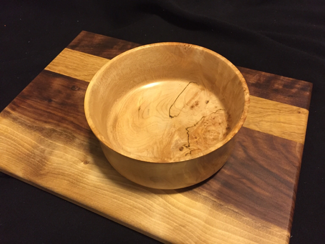

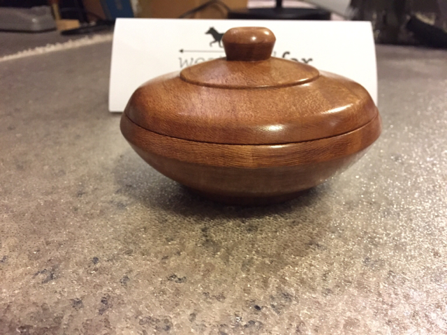

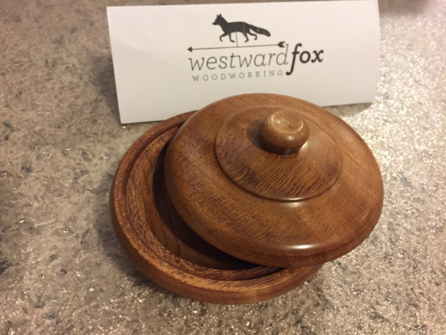

I've turned two more bowls since this post and had a lot fewer catches. Having the tool at the correct cutting angle makes a huge difference, though I'm still improving this. Also keeping it sharp helps a ton, go figure. Apparently stone wheels don't sharpen Thompson Steel very well, so I've been honing with diamond hones and this seems to work pretty well.
Thanks for all the tips!
