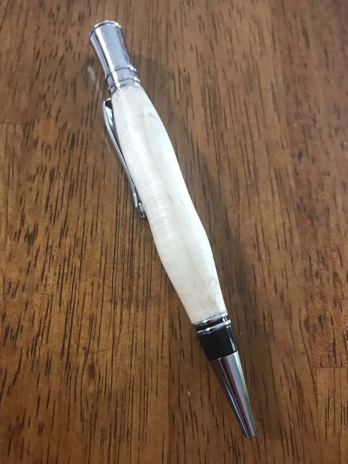

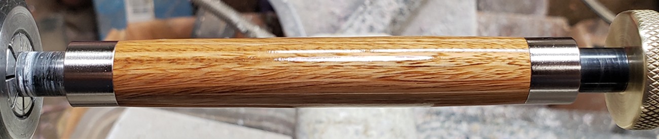

I am still experimenting with different woods to figure out what I like and don't like turning. I'm finding that when I turn a very light colored wood, I have issues with dirt getting into the grain and causing unsightly black marks when I'm sanding. It usually happens when I get through all of the sandpaper grits and start wet sanding with micro mesh. If I use anything other than fresh, right out of the package abrasive pads I get the black marks. And even then, if there's any amount of dust whatsoever in the area, I may still get them.
Today I tried aspen which was a nice wood to turn and finished beautifully, but as soon as I touched it with an 800 grit micro mesh pad it turned almost completely black and I had to go back through all of the sandpaper grits starting with 150 to get the nice blonde color back. I stopped at 600 grit so it didn't come out quite as smooth and shiny as I like.
Of course using a completely new set of abrasives for each pen can get pretty pricey, and even that doesn't seem to be a guarantee of it not happening.
Do any of you have tips for working with the lighter colored woods? I tend to prefer darker colored woods anyway, but if there are some good tips for not turning your wood black I would certainly appreciate them.

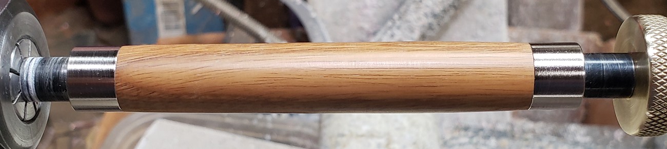

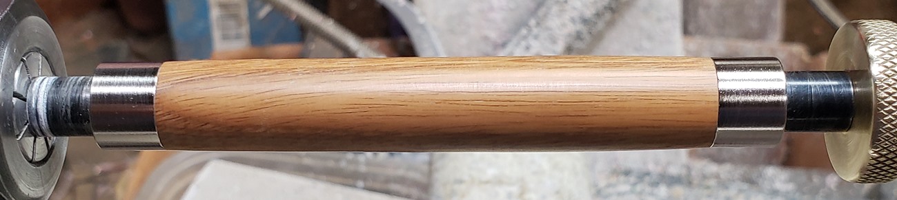

Below is the aspen pen I turned this morning.
The first question is are you sanding with the bushings still in place?? You are probably picking up the metal dust from them if you are using. Any time I use light colored woods and or combine woods for segmenting I skip sanding and just use the skew to turn to desired size and then finish. My finishing is done between centers with nylon duron bushings. Any other sharp turning tool can take the place of a skew if you can not use one. The photo is tough to see because aspen is not a clear material and that is either lots of tool marks or glare from flash and that needs to be cleaned up.
Yes, I was sanding with bushings in place. It makes sense thst removing the bushings and using nylon would make a difference. I will give thst a try. Thanks for the tip!

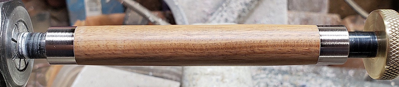

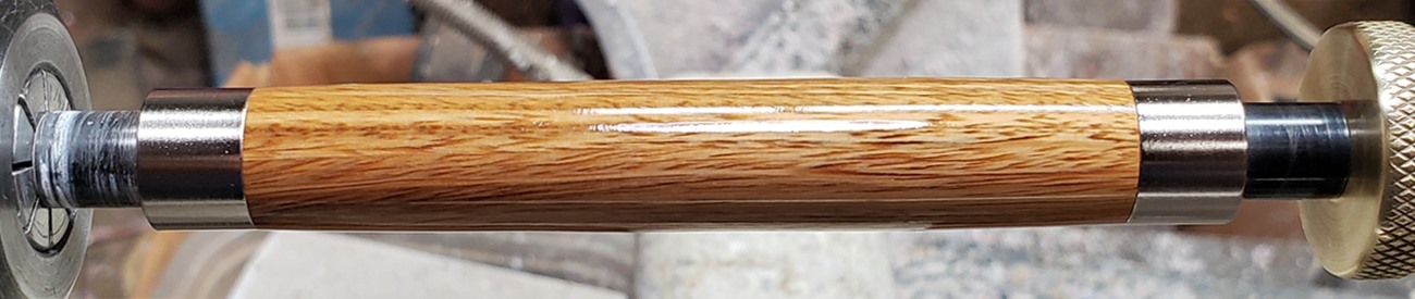

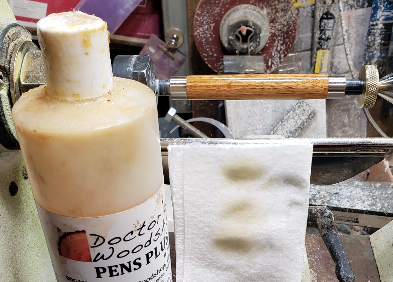

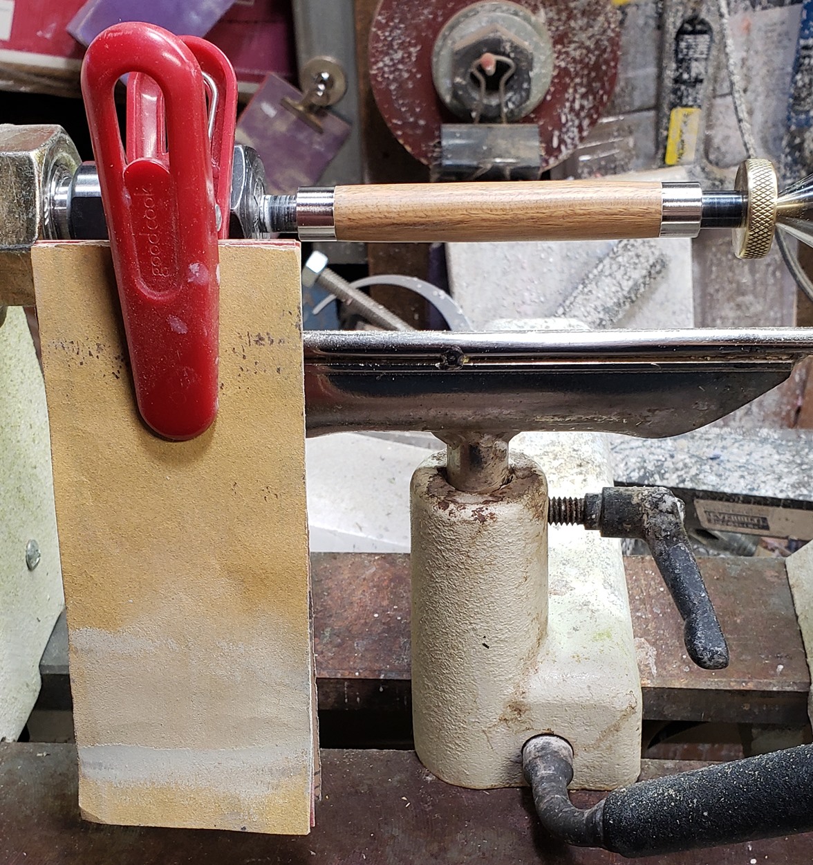

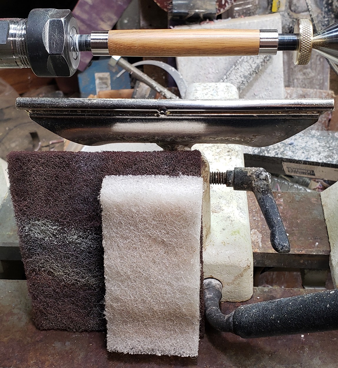

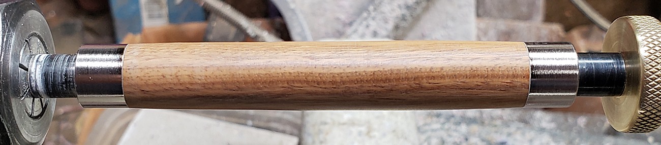

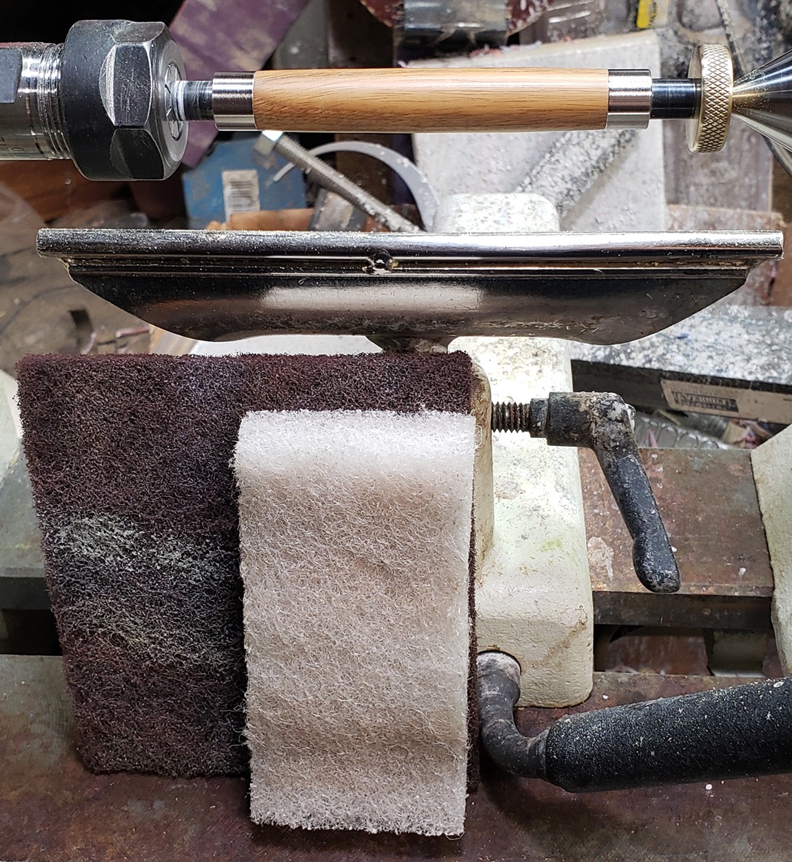

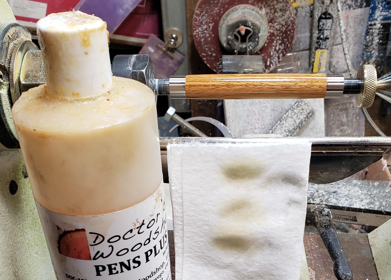

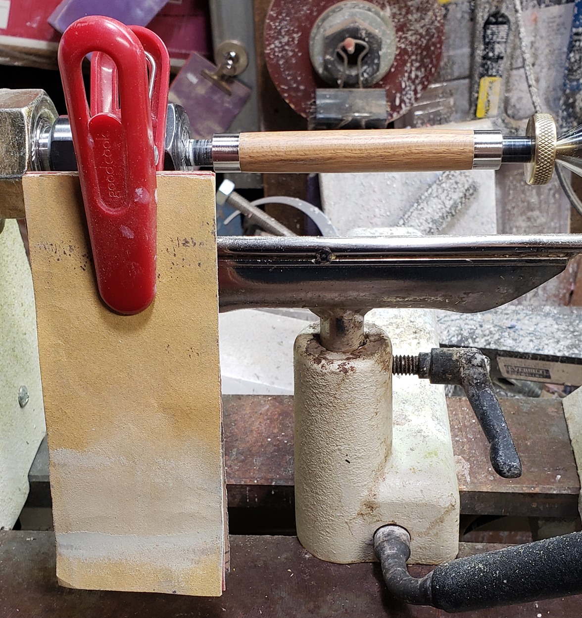

I don't use Micro Mesh on wood, nor do I wet sand wood. I dry sand with 220-400 grit, then use "synthetic" steel wool. The finish I use is Pens Plus. I'm happy with the results I get.

I was just thinking, if you're wet sanding wood, the moisture might be picking up dark powder from the bushings. Also, I've heard of some people blowing off blanks with compressed air before applying the final finish. This probably helps more with coarse grained woods.
That very well what may be happening. I'll stop wet sanding wood and try a few other things that were suggested here. I've had good luck micro sanding certain woods down to 1500 grit but maybe it depends on the wood and how open the pores are. The aspen was rather fuzzy and I couldn't get it quite as smooth as I like with sandpaper. Maybe a good candidate for a CA finished, which is something I haven't tried yet.
I agree with the other comments additionally if you don't want to use CA get some sanding sealer or lacquer and apply it before sanding, a thin wash coat is what you want. sanding to such a high level (dry) is only going to be worthwlie on hard dense oily wood that is know to polish well.

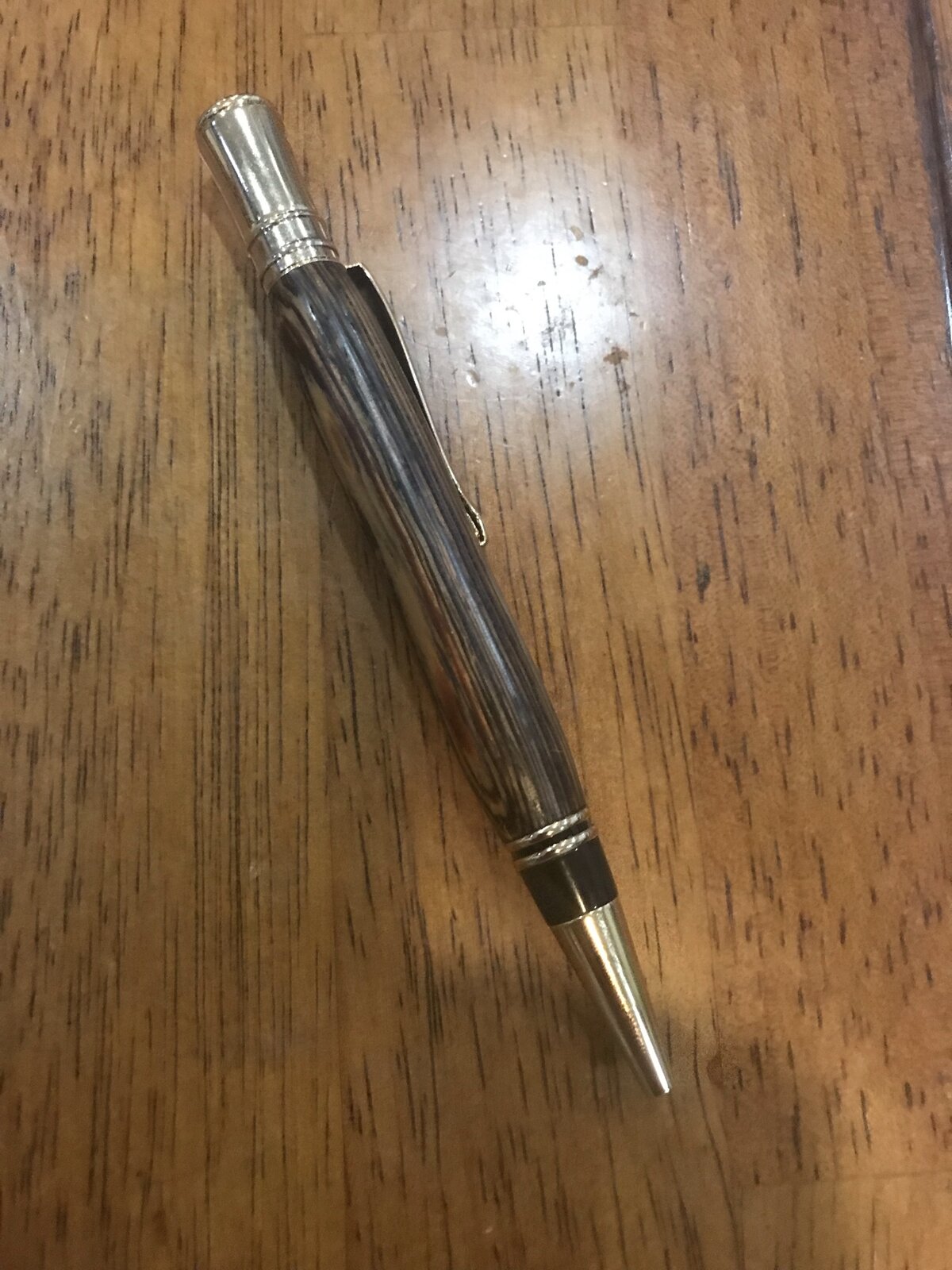

I redeemed myself with a Wenge pen this afternoon. I'm finding I like turning the darker woods much better. The aspen does have a certain beauty to it but its grain patterns are very subtle. This piece of Wenge had very striking grain.

Way late to the party, but I thought I'd chime in anyway. I often sand up through 800 grit and then at least partway up the micromesh grits on bare wood, and I don't have the issue you're describing. I also don't sand with my bushings (by the time I get to sanding, I'm turning between centers with no bushings), and I never wet sand until there's a finish on the pen.
Those two things should be enough to greatly reduce/eliminate the blackening you've described. In addition, think of light-colored woods as great practice for your choice of tool, and see if you can get a surface that doesn't even need to be sanded prior to finishing. I've only ever been able to do this on cherry, but I'm still practicing.
Since this thread has come back up, I will join in again also. Don't run away from light colored woods, there are a couple of easy ways to eliminate sanding dust from bushings, which caused the problem for the OP.
1. TBC IS SIMPLE. It is easier to do for some than it is to get their mind around it. I heard about TBC and for a couple of weeks couldn't get my mind around it, but just went into my small shop and decided to figure it out. Shucks, I was over thinking it. It was simple. With TBC, you are taking the bushings off for the final turn and sanding. Problem of dark sanding dust SOLVED.
2. Most people here are totally unaware of this simple trick, but a few great turners do use this. For new turners, it may take practicing for 20 to 30 minutes on a throw-away blank or two: When you turn a blank with the tool of choice, be it a skew, a scraper, or carbide insert, the wood is pristine. If you use a freshly sharpened skew, scraper or fresh carbide insert, and light touches, the blank will be pristine and SMOOTH, already turned to size - and you didn't even use sandpaper. I, and a few others do not use sandpaper as our tools alone make the wood as smooth as the best sandpaper can make it. Yes, a properly sharp tool can make the wood so smooth that sandpaper is not needed. It is SANDPAPER sanding the bushings that make sanding DUST that discolors the wood.
A sharp tool will clean up the sanding dust created by sanding. It works best once the bushings have been removed from the blank and then the blank has been put back on the TBC and then touched up with the freshly sharpened tool. NO sanding dust!
