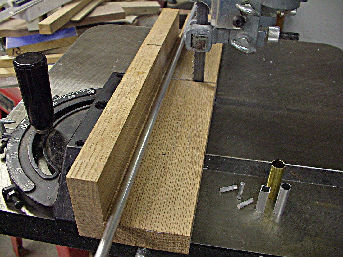

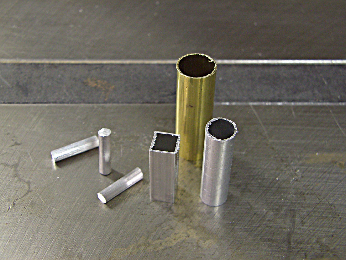

Cut them on my bandsaw with a metal blade. I cut all metals on bandsaw and use a jig. Just clean up with reamer and file if need be.

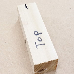

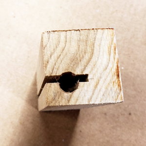

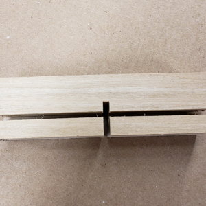

If using a barrel trimer I never trim on the lathe I hold the blank with a clamp and use the drill press. I find the chuck on the lathe and a vise on the drill press can cause the blank to reference off the sides instead if the tube. It also causes an do stress in the blank as the barrel trimmer is trying to force the blank square with the tube. Holding with the clamp allows the tube to easily stay square with the barrel trimmer in turn reducing the stress on the blank. I find it produces a much better cut for me. Also I as well cut the tube with a hack saw. If you drill a hole in a block of wood that is approximately sized for the tube then cut through that hole with your hack saw you will have a jig to cut that size tube without as much deformation.

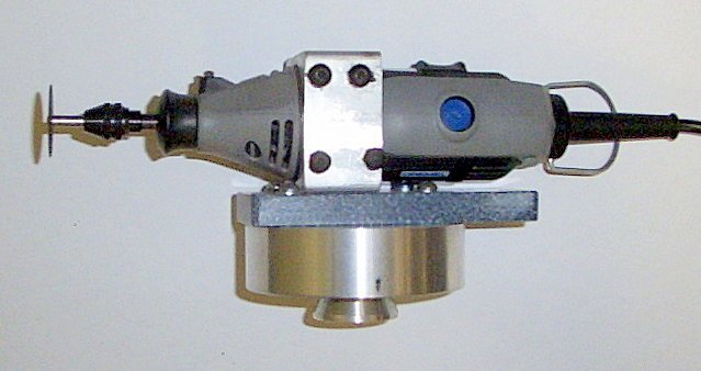

For my metal lathe (HERCUS)>Using an aluminium extrusion,turned aluminium base to fit th4e toolpost base as per pics,Quick fit a dremel with the thin black cut off blade.

I have a cutting block I clamp into my blank cutter and cut with tablesaw. Be sure to clean up the brass swarf.
Years ago I was given one of the Harbor Freight mini miter saws. Woefully underpowered. I place the tube stock in a cut off scrap of a barrel blank of the appropriate size, and clamp with built in clamp. Apply very gentle downward pressure. De-bur inside and out.
