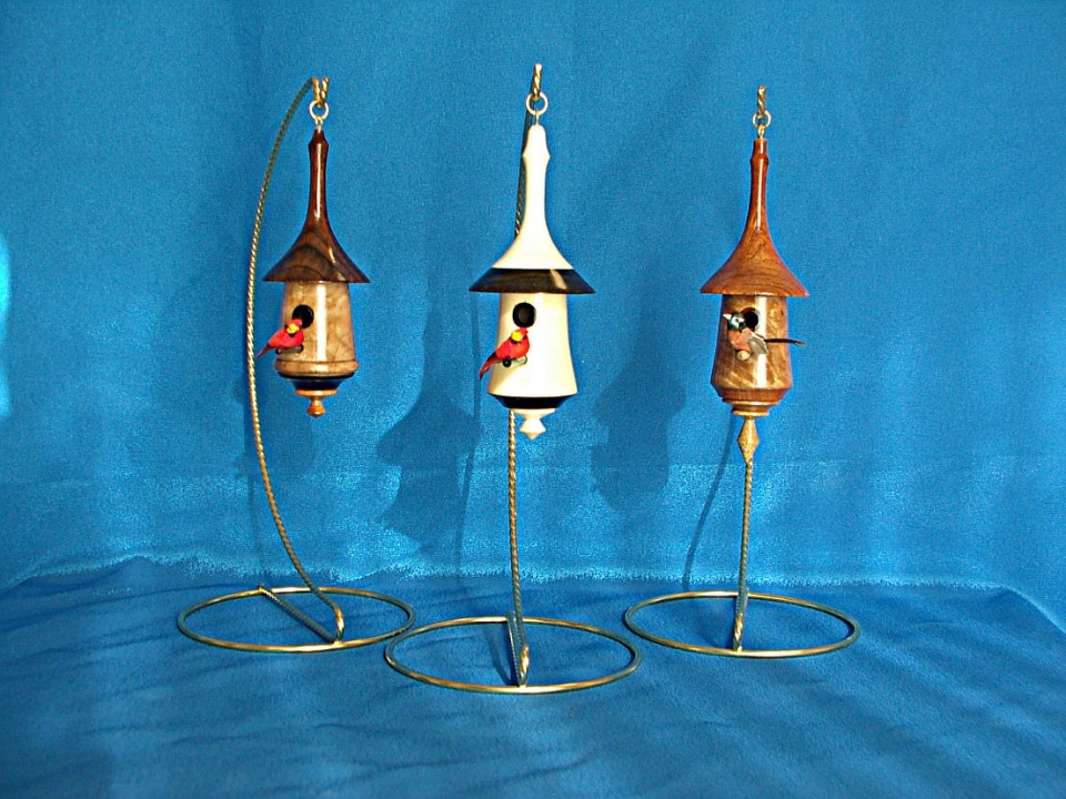

Open your mind up:smile: Let your creative senses take over. If we tell you how to do it what you have is our interpretation and we might as well stamp our names on them. So many ways you can go. You can do some segmenting and build your blank that way. You can do sections and cut and use dowels to secure pieces together. The base will be the largest diameter piece so why buy that large a blank and turn away all that waste unless you have a source for such wood. Mix in different woods and add character. You are stepping into turning larger items other than a pen but the technique is the same. Do a google search for examples of shapes and sizes. There is no right or wrong way to do them. I will caution you if you plan on using real candles then you better put in a glass container to catch wax. If using battery candles then have at it. the sky is the limit. Surprise us and see what YOU come up with.
I know these are not candle holders but the use of different woods worked into the design to me gives the piece character. Unless the wood is a beautiful burl then I can see the entire holder being the same but for fun I would mix it up.
