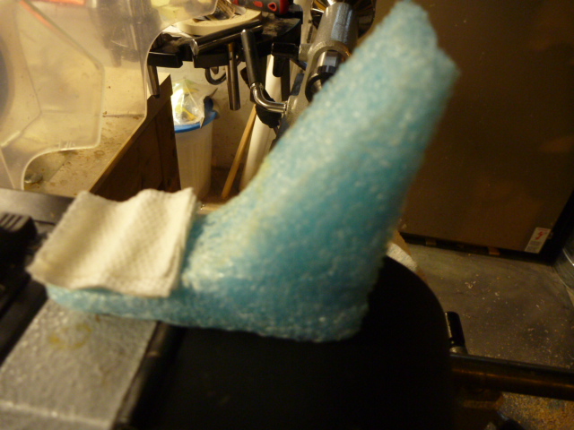

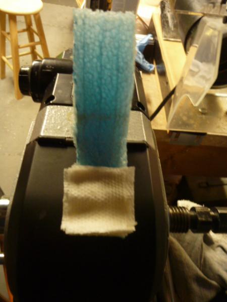

My paper towel squares fit very nicely on my CA jig (LOL!). This is a block of closed cell polyethylene foam packing material which is kind of shaped like an L. See the PIX. I just put the first paper on there and hold it in with my nail. After the first one I just stack a new one on top of the old ones. I use the tip and the base so I get two swipes for every towel square. I usually hold down the towel for the application furthest from me and only hold the jig for the one closest to me since the towel is now glued to the others from the first application.
Applying the CA is simple. The first application is directly on the blank spinning at 100 RPM. I want the CA to completely cover and soak into the wood as much as possible so I give it a good dose. As I put it on I have the jig UNDER the blank and move it quickly from side to side. I am talking 3 or 4 swipes and that is all. Just enough to smoothly spread out the CA from end to end... one tube at a time.

I was tired of getting CA all over my fingers and was looking for a way to hold the towels. I used to hold a stack of used ones putting a new towel on top. But I would always end up with CA finger tips. This was has cut that back dramatically and cost me nothing. And I got to use some of that packing scrap for a worthwhile purpose! Ought to be some kind of Save the Earth award for that! LOL!
