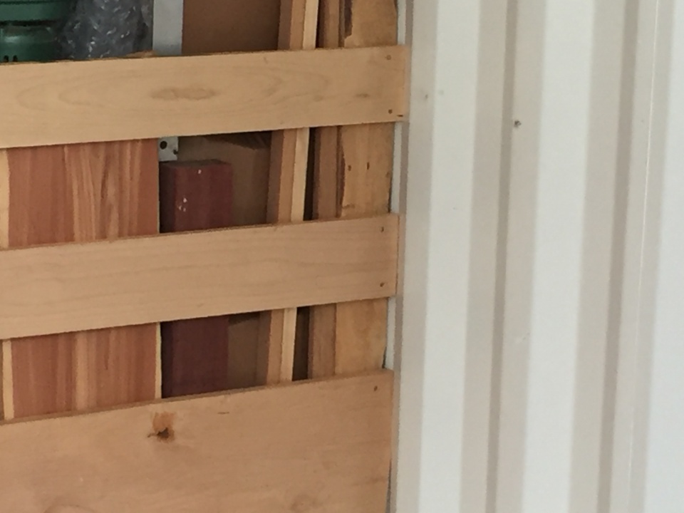

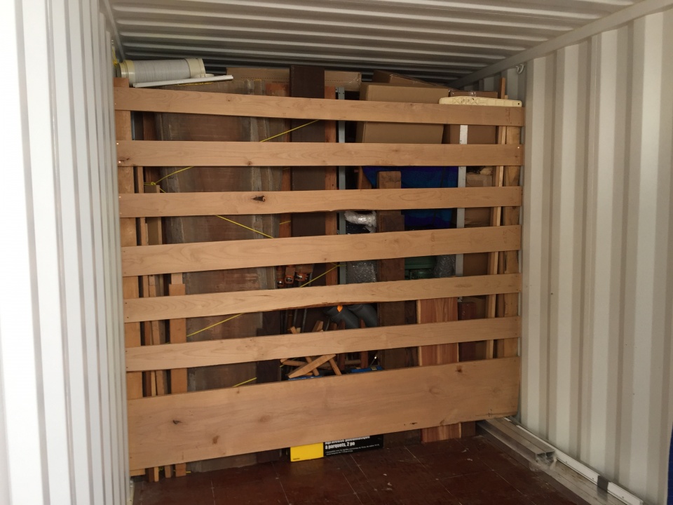

A year and a half ago when we decided to move from the west coast to Saskatoon I decided to rent two 20' shipping containers and load them with our belongings including the workshop tools, machines, and wood. Mainly because I could be sure the tools were packed right and would be safely stored until we were ready to move in.
Now when you rent a container you can't modify them with more tie down anchors or screw things to the floor. That leaves you trying to lash everything down using the provided anchors, 5 along the top and bottom on each side. We'll that just ain't enough. So my tip to those of you that may choose to move this way is to build a wall / fence at intervals that suits what you are loading as you go. Once you place a table saw, bandsaw, and compressor for instance you pack in and around them and on top. Then place a board just long enough to slip into the metal folds and screw it to a couple vertical ones at the ends. Add more and pack and stuff as you go. If you cut a slight angle at each end it is easier to insert and drop them in place. When done everything in that section is going to stay put when they drag the container onto the truck. Put a fence up every 4' to 6' until you reach the end. Another advantage of the walls is that you can tie things to them to hold the in place. Everything I packed stayed put in both containers after being picked up, trucked here and dropped off at the house. It wouldn't have without the walls.
Let's see if the pictures come out without laying down. ;)

Mal to be honest I took 2 pictures with the phone held vertically and then 2 more the same with it held horizontally. When I previewed the post the it was the vertical pictures that laid over, so I deleted them. ;)
Hank we bought a couple hundred boxes from Uline in a couple sizes and with single and double wall thicknesses along with a couple rolls of buble wrap. I also in my last few weeks of work grabbed all the foam and bible wrap I could lay my hands on. Everything was well wrapped and having most of the boxes the same size meant they stacked well and were manageable to lift. We also bought a bundle of 10 or 12 moving blankets on Amazon or Ebay, who remembers, that were great for bigger things like chairs. To be honest I'd rather skip doing it again and just flog everything and buy new.:smile: Way easier on the back.c:wink: I'll remember the foam plate trick if it ever comes up again.

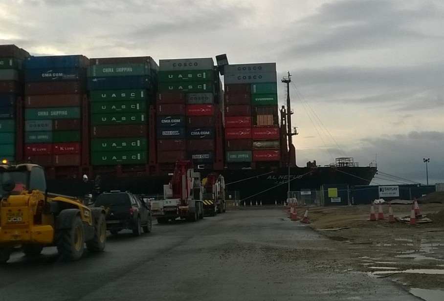

Here's another reason to make sure you secure your precious possessions...:wink:

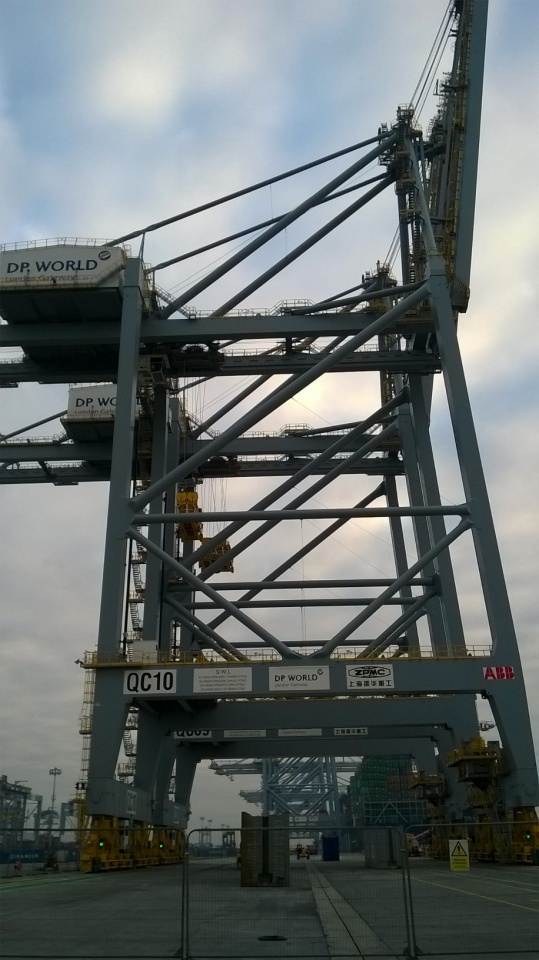

Just before Christmas I had to go do a job at a new container port on the Thames estuary near London. My job was in the machine control room at the top of 12 of the cranes. These have a lift up the 11 flights but the client was a bit of a dick and switched off the power for the stuff I was going to work on, before I could use it, so had to walk up the outside stairs with all my tools and stuff. Even though I nearly had a heart attack, I wasn't going to give him the pleasure of seeing me struggle.....I insisted that he come up and prove the power was off, so he only was a dick on the first one....
But sorry, I digress....:redface:
At the same time, UK had just endured Storm Barbara . You can see the container that the storm lifted, turned on it's side and emptied and then dumped back down on the top of the other containers.
Fun, fun fun :biggrin:
