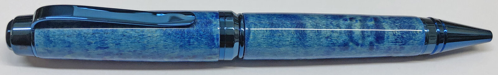

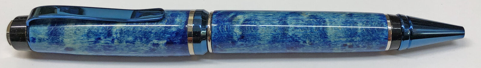

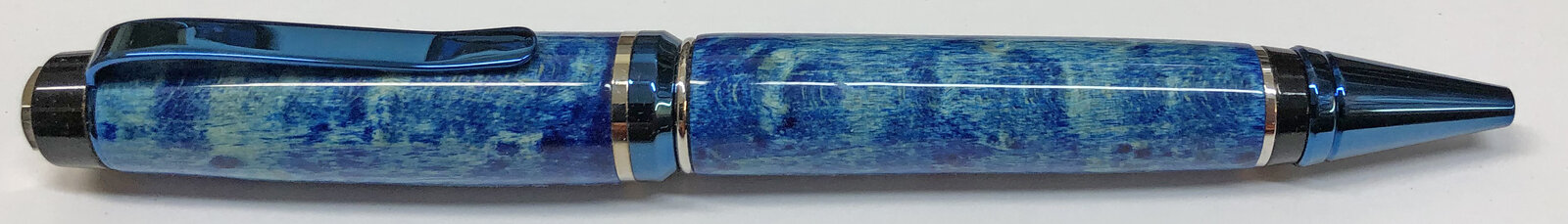

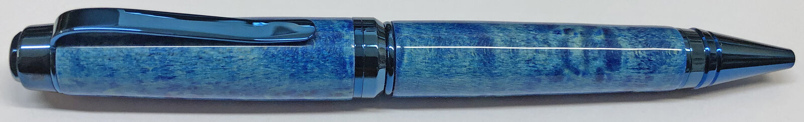

I've had success with dye by gluing the tube in, turning, and dying just before applying my CA regimen. I can't remember what dye I used, but I think it might have been an alcohol ink. The wood was birdseye maple. I've attached pictures of a couple of them below. I am very curious to see what process you wind up using and how yours turn out. - Dave

DC, what dye did you use? Eye-catching pen. BTW, I like curly maple's grain and pattern, no matter what color. Thanks for sharing the photo.

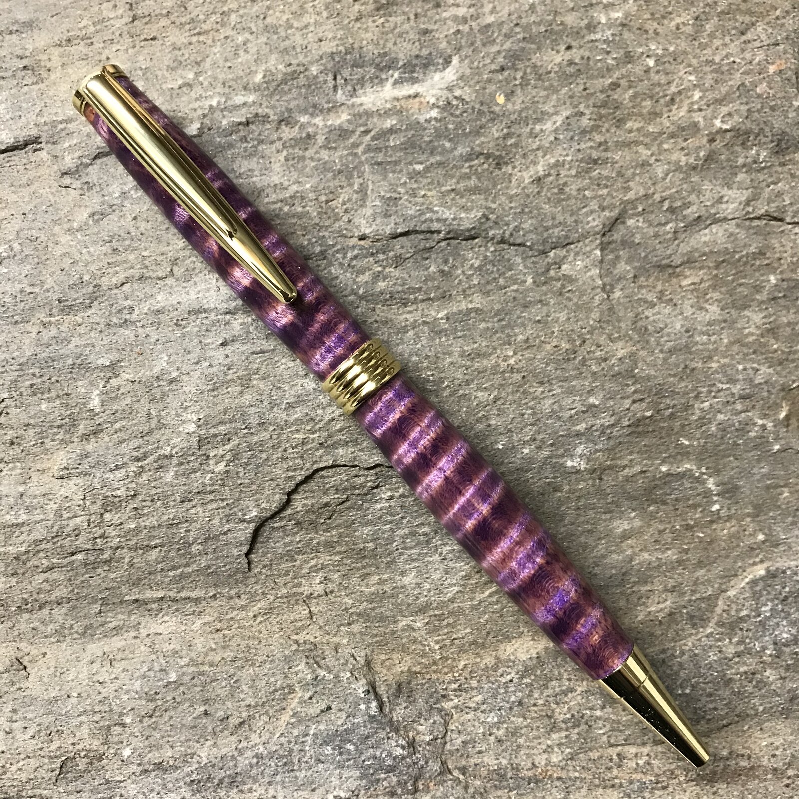

I added some Ranger alcohol ink to a little denatured alcohol then applied it with a QTip to the shaped and sanded blank. It usually takes 2 coats. CA finish after it dries. Purple and gold on this one because it was for an LSU fan.
