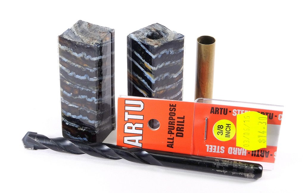

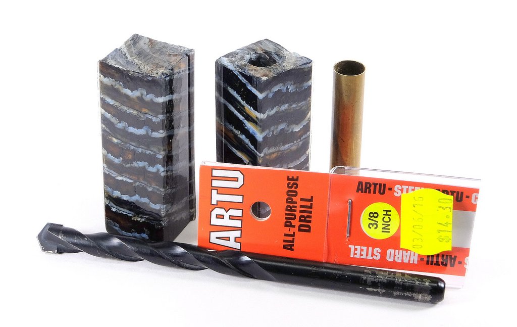

You can buy these in the states they are magnificent IMHO I used this one on Mammoth Tooth went through so well ie rock and a hard place through those light coloured bands of Silicon read Glass. Peter.
are they maybe titanium carbide ?
