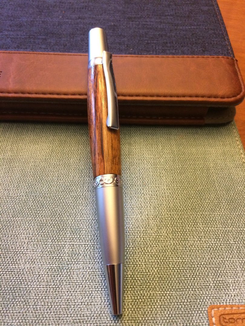

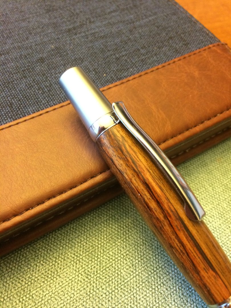

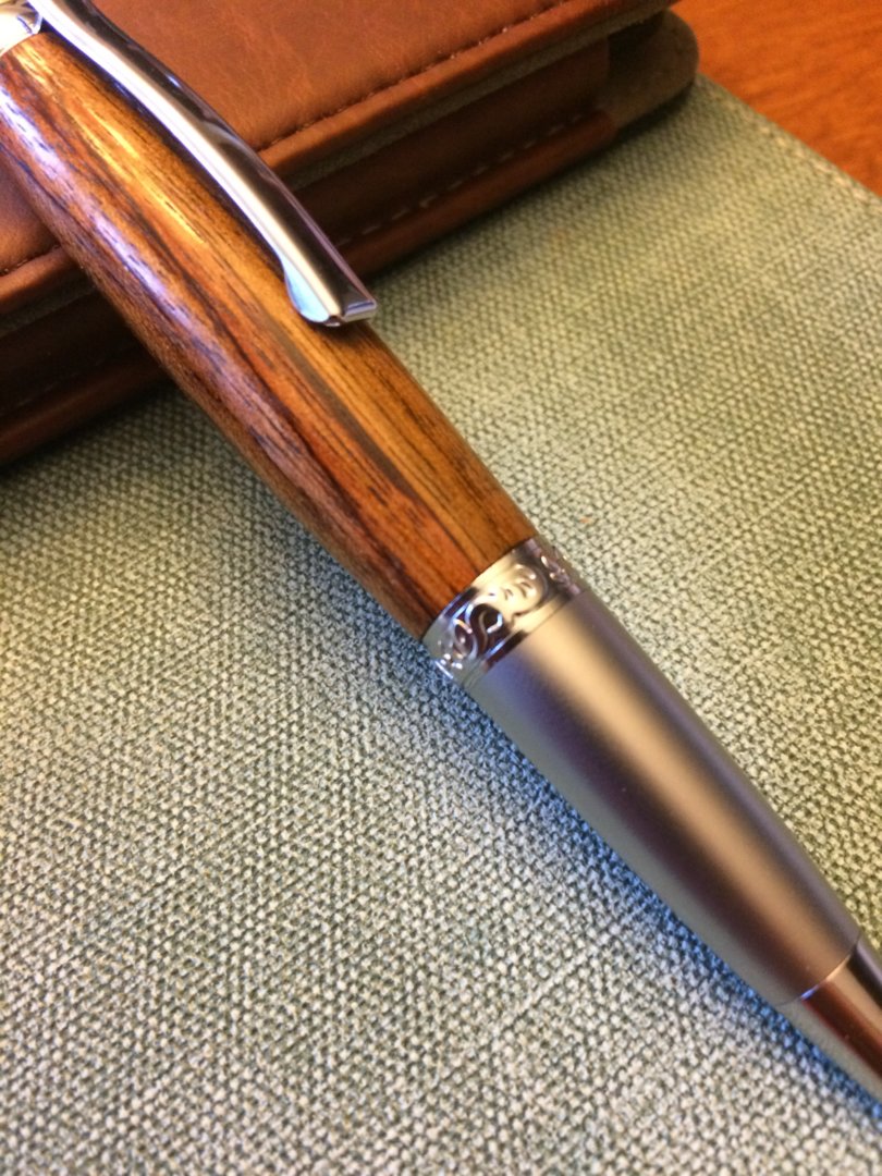

Just finished turning and assembled this Manhattan pen. The wood, has many common names; Goncalo Alves, Tigerwood, Jobillo.
The sanding lubricant was walnut oil, and then applied 5 coats of Pen Plus. Top coat of wax was then applied.
Wood was a little darker than I anticipated but thought it turned out well.
87E7145E-8B6C-4526-BECB-241BFB3AE9C6.jpegE14CF034-99B8-4150-8197-AC60574AB71F.jpegBFB95A83-9A90-4F63-ADDB-E835CB2FCDB4.jpeg
Sure does look really nice! You wet sand with walnut oil?
Yes, starting at 1000 - 12000 grit is where I start wet sanding with walnut oil as my lubricant. I do a dry sand to 600 then use denatured alcohol to clean the blank(s) then start the wet sanding.
Beaut pen, Tom ... I am going to try your finishing technique ... how long do you wait between consecutive applications of Pens Plus ?
... a few minutes ? ... several hours ? ... or ?
I put 5 coats and wait 3 minutes between coats. The recommended is anytime after 45 seconds. Then I top it off with a wax that I buffed in. Hope this helps.
