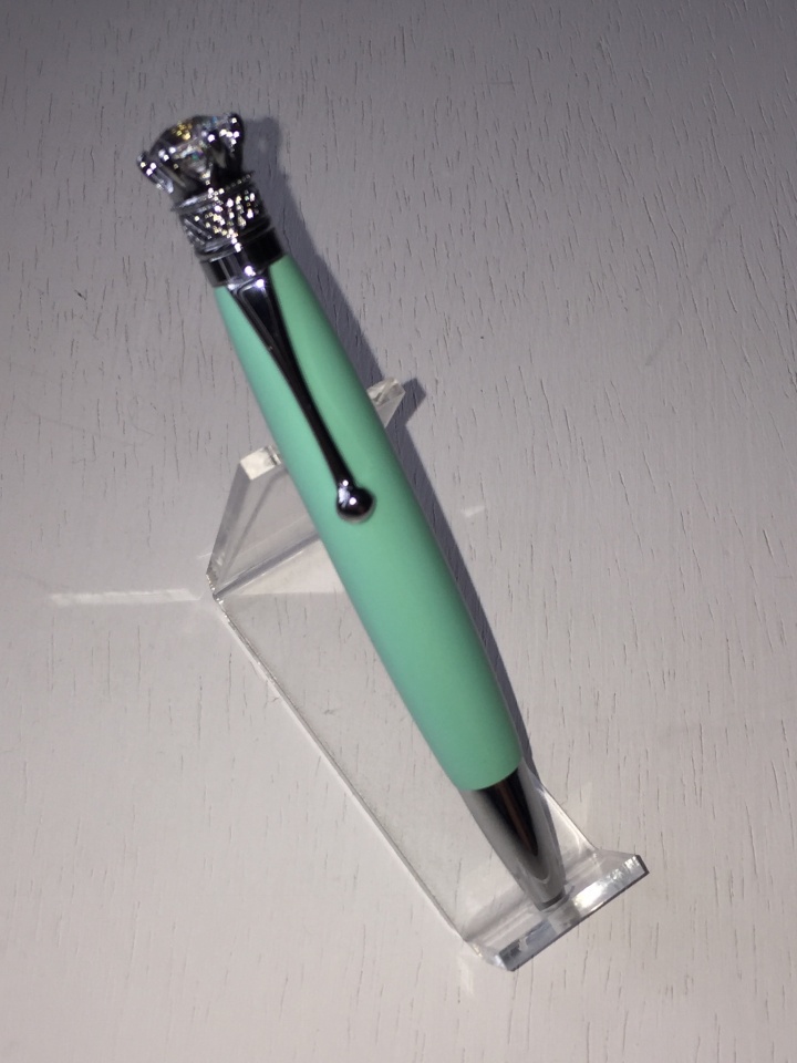

Hi Amber,
now don't laugh but green PVC sewer pipe is real close. hope this helps

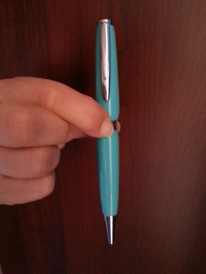

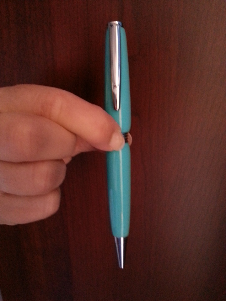

I found one 4 years ago when I first started, and made it for my niece. This was probably the 10th pen I ever turned. I have had several requests for the same. I had one of our suppliers try to make them for me and every one of them cracked when when insert the parts.
This was just plain AA, but don't remember where I bought it. I would buy some if I can find these.
