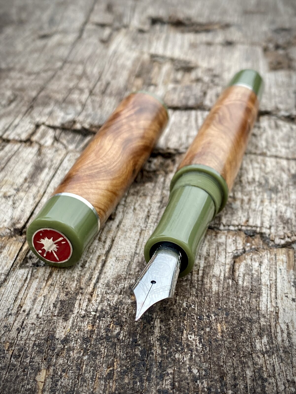

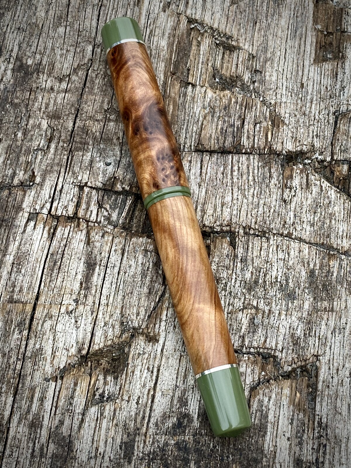

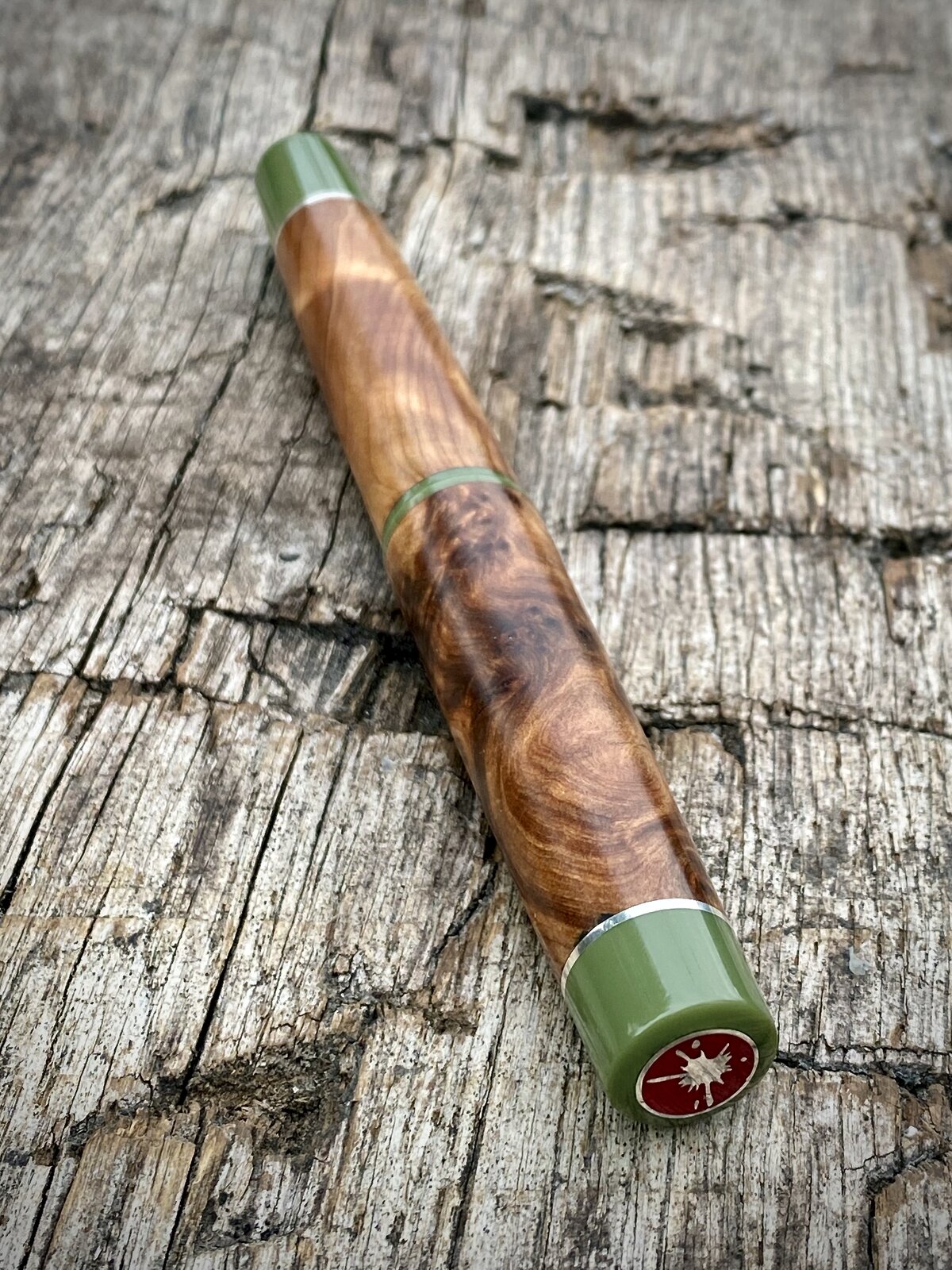

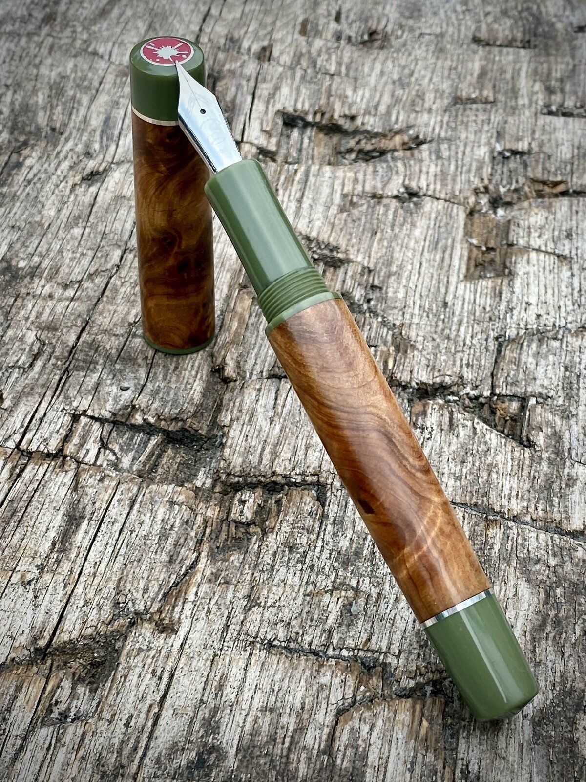

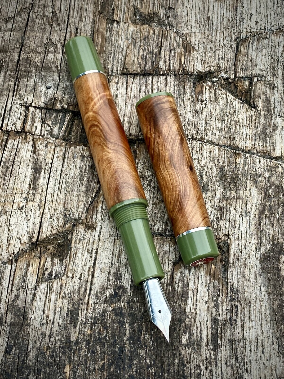

First pen I've made for a while. This is Thuya Burr/Burl with sterling silver and accent rings and green acrylic finials and section.
I have been playing around with the cap lengths on the pens I make, purely from an aesthetic perspective. This is a little longer than usual and I'm still considering whether to keep this length.
The pen is 145mm long closed, 132mm open.
Cap threads are 13x0.8 made using a tap and die.
It has a Bock No6 nib.
It is finished using melamine. It gives a very nice natural looking (and feeling) protection to the wood. If you haven't tried it then I recommend giving it a go.
Cheers
Ash

Looks awesome Ash. I don't mind the longer cap. It doesn't look out of proportion to me. Flawless work as always. That thuya looks lovely
magpens
Feb 2, 2011
15,911
Canada
Beautiful pen !!!
The cap length is fine . . . In the process of making it longer, have you also slightly reduced the length of thuya in the body ?
From the appearance, I get that impression.
Valleyboy
Jul 2, 2019
341
Wales
Beautiful pen !!!
Thank you.
I kept the barrel the same as usual but I may make it a fraction longer next time. I usually try to incorporate golden ratios in the various relative proportions, but I did this by eye. That wasn't easy for somebody with my levels of OCD 😊
