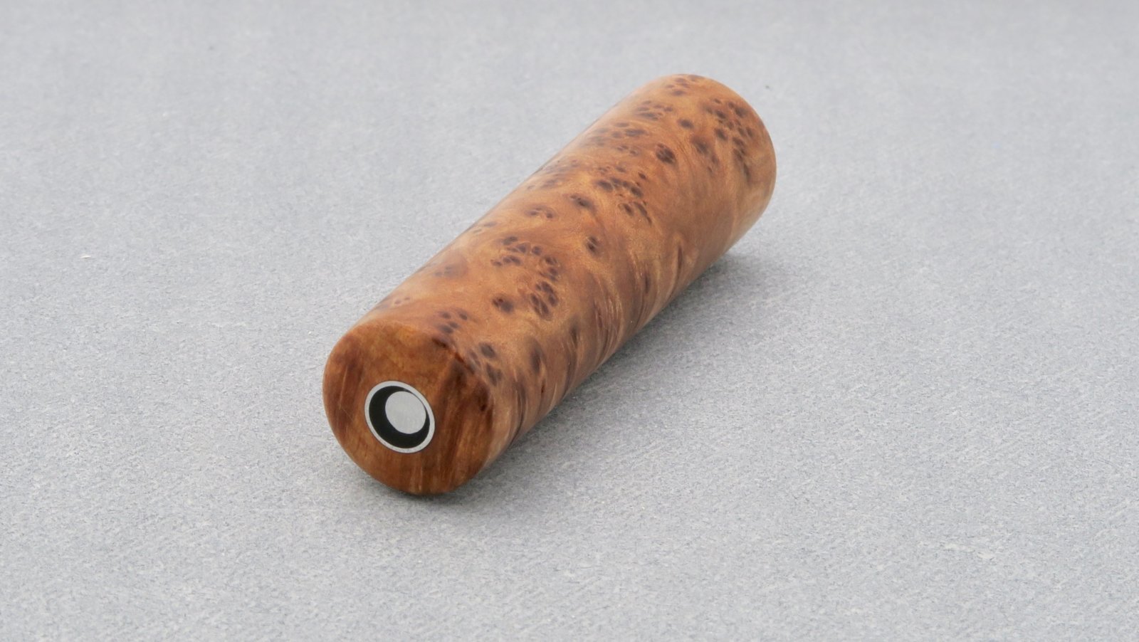

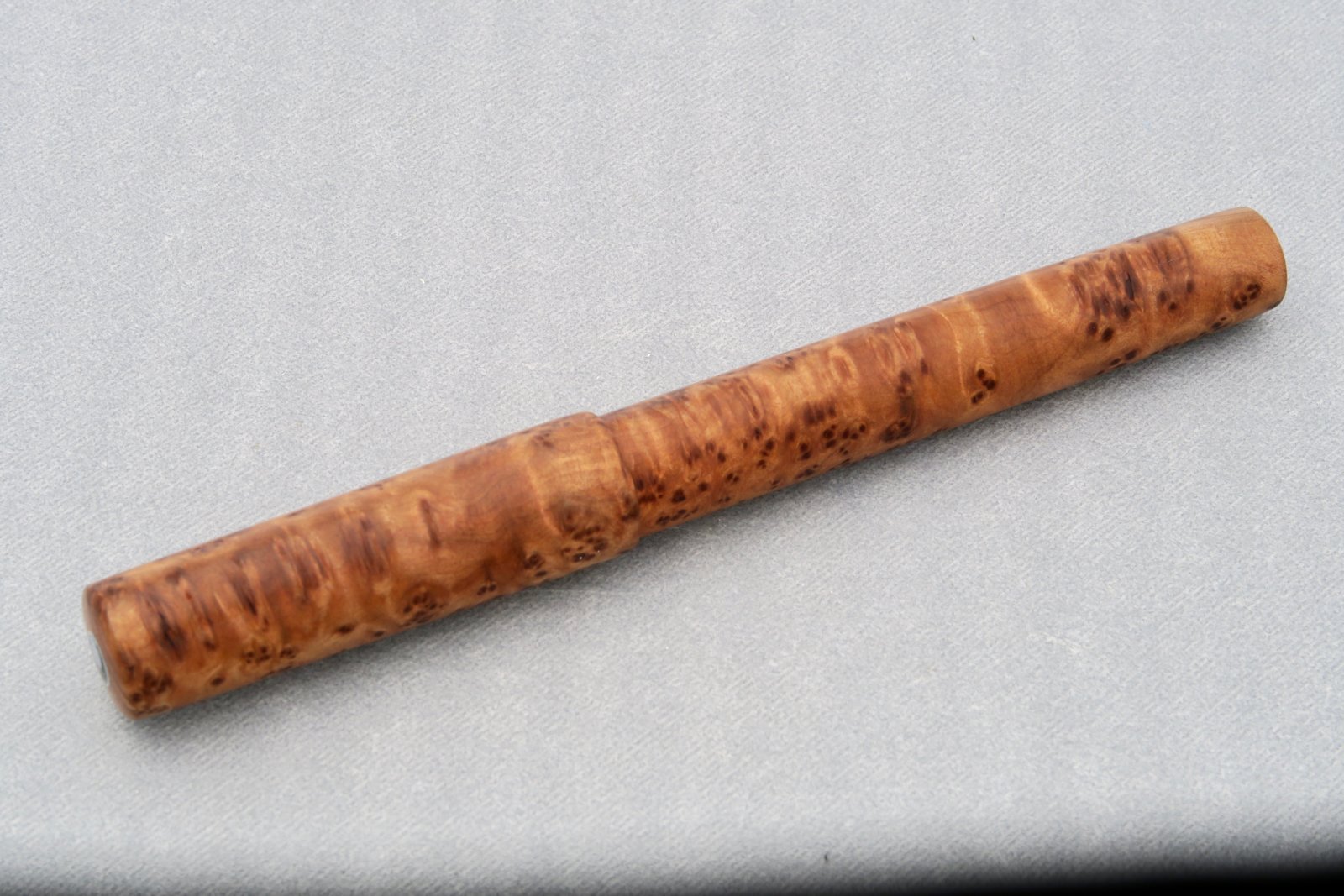

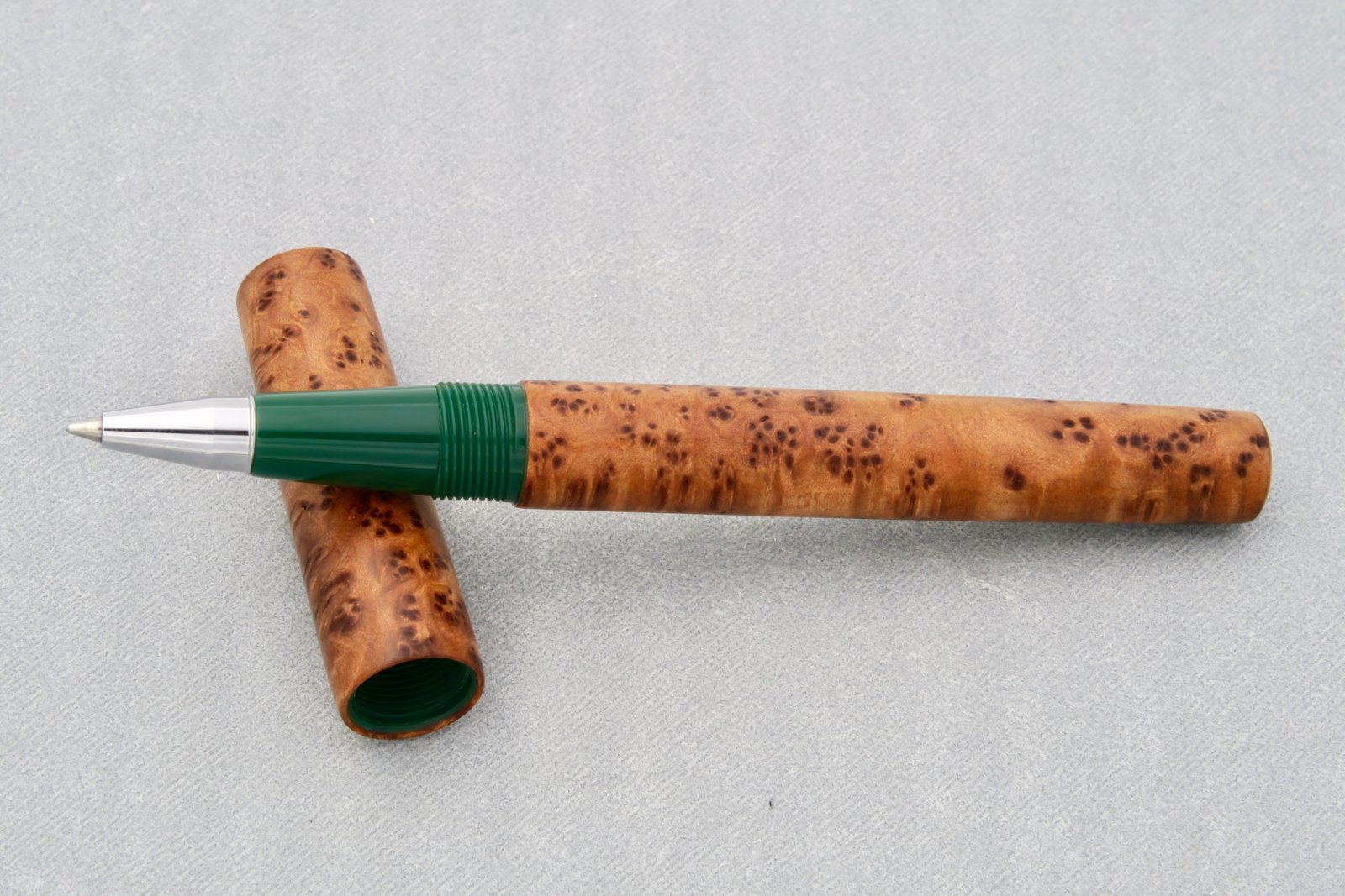

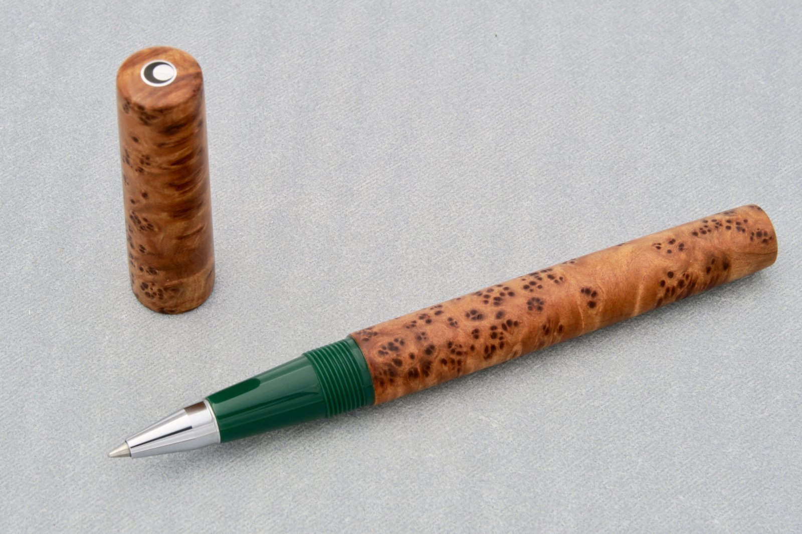

Latest kitless rollerball. Thuya burl and semplicita acrylic, finished with BLO and sanded to 8 000 grit 3m polishing paper. Did not want to put a CA finish on this one.
I have also incorporated a crescent moon logo on the cap that I will use on all my kitless pens. Logo is made the same way knife makers make mosaic pins.

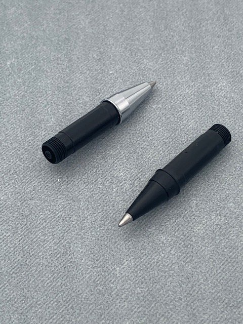

I like it. Very nice section - so often I see kitless rollerball's where the section just looks fugly to me. This one is great. Did you make the metal nib? Stainless?
No, I do not make the nib only the section, the nib is a unit much like a fountain pen nib unit. It uses the same fountain pen ink as well and is made by Schmidt. they are available in black and chrome.
