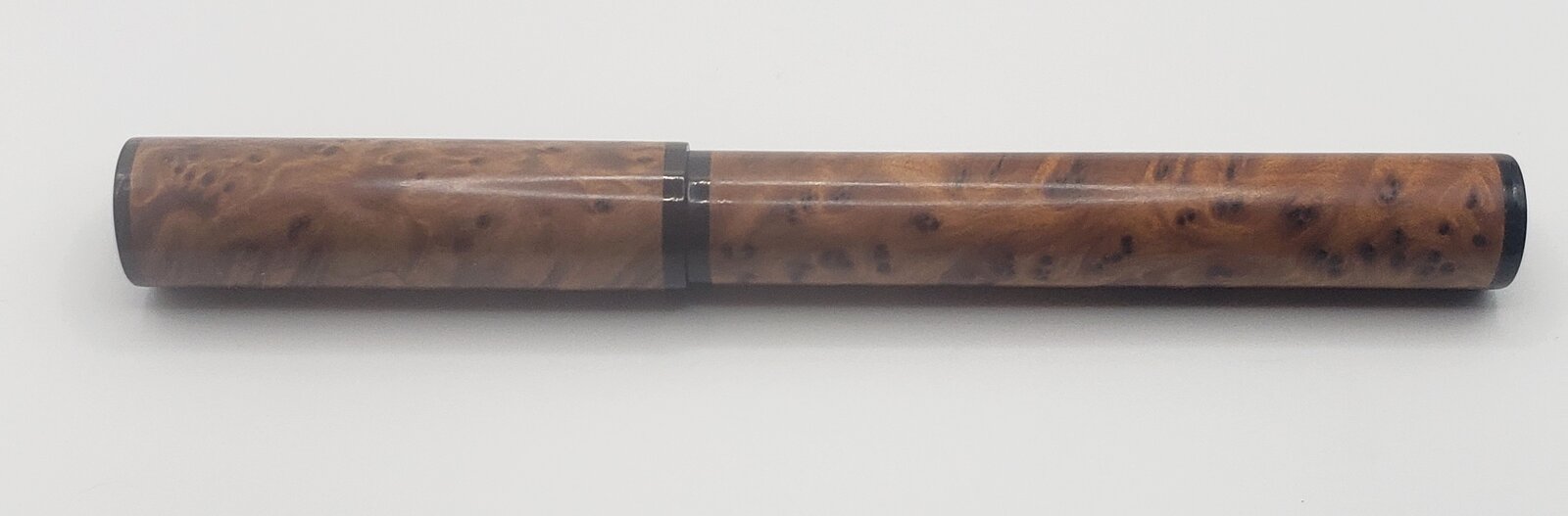

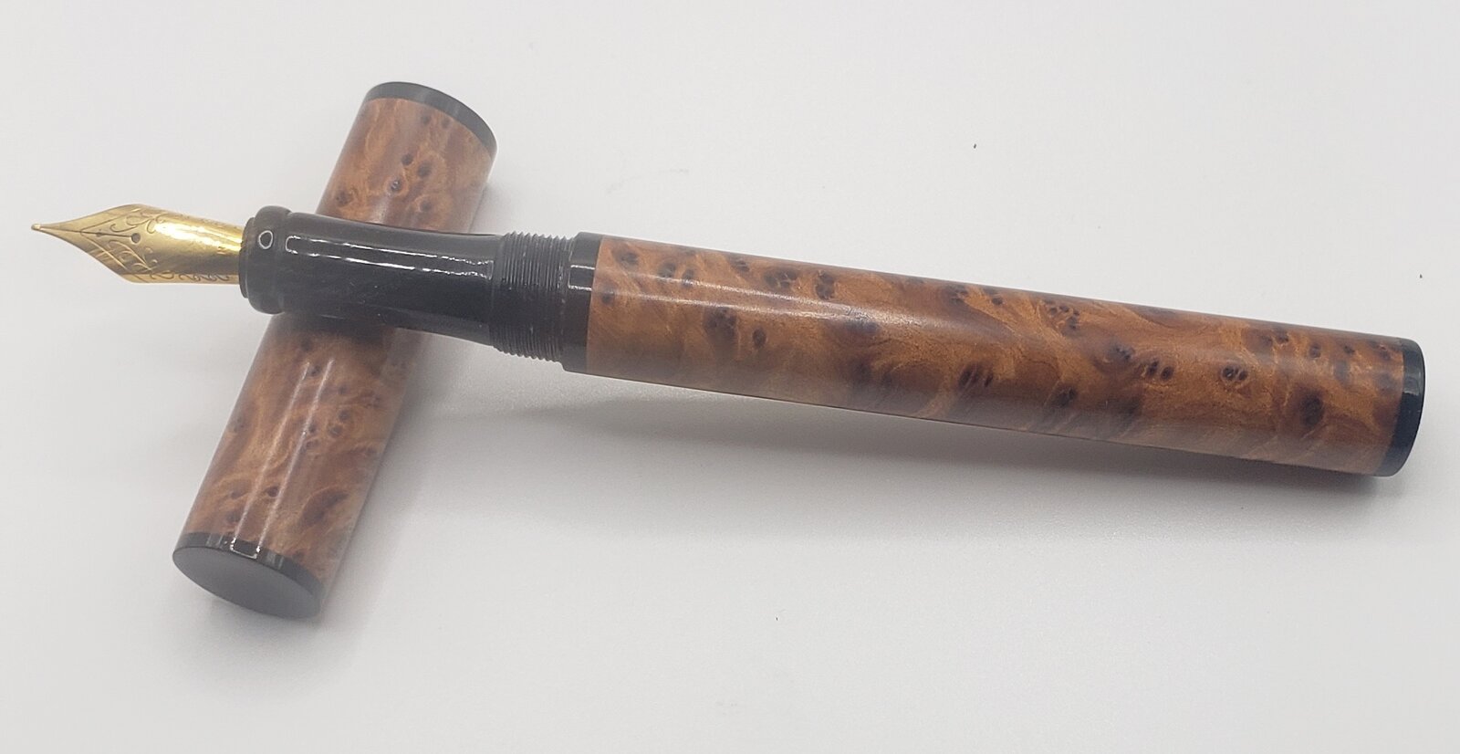

Take your pick on the terminology. I tend to like the term artisan pen.
Thuya burl. Cap and barrel lined with acrylic acetate. M14x.8 TL cap and barrel threads. M10x1 section threads. Barrel diameter .608". Cap diameter .675". Cap length 2.5". Barrel length 3.675".

Beautiful creation Don. Like the fact that you post some wonderful details(dimensions) as this is very helpful to determine what taps/dies that you use in construction. I do not make custom FP but if I did then this type of info would be great to know. Thanks for sharing.
Thats a beauty Don, and I like 'Artisian Pen' over the others also. Very nice. Was the Thuya difficult to finish? I have found mine the be very oily and a challenge. Thanks for sharing. 👍 👍

I am super envious of everyone that can make a pen such as this without the use of a kit. I think it is a beautiful pen and very artfully custom crafted.
With that being said and not to hijack a thread about a very talented pen maker and his glorious creation I am glad you didn't use that, too often misused word.

Looks great and I as well like the "artisan" Is the finish CA?
