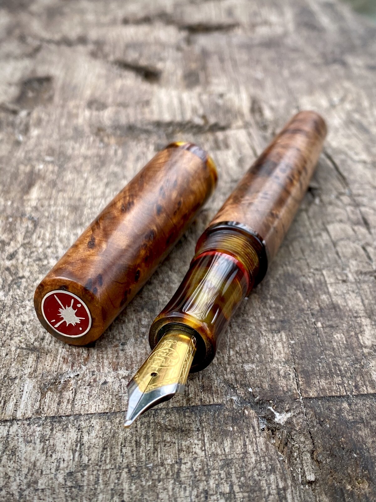

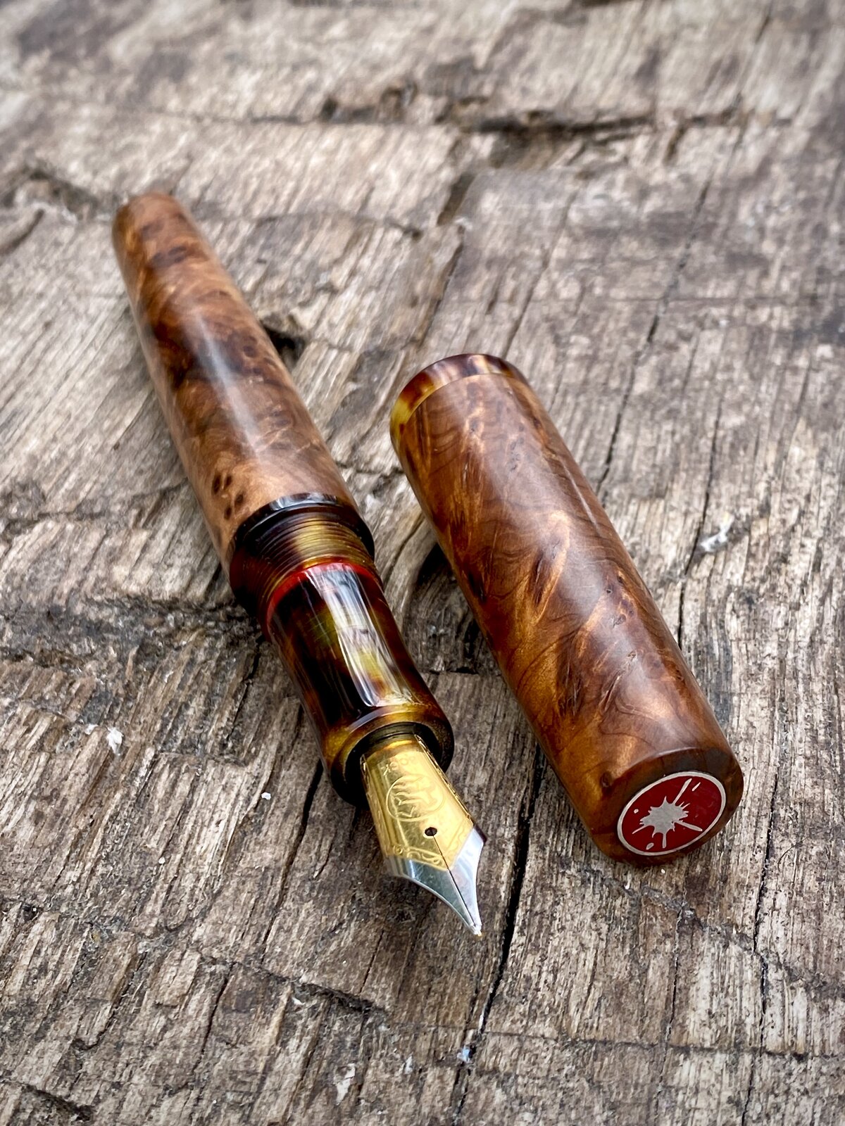

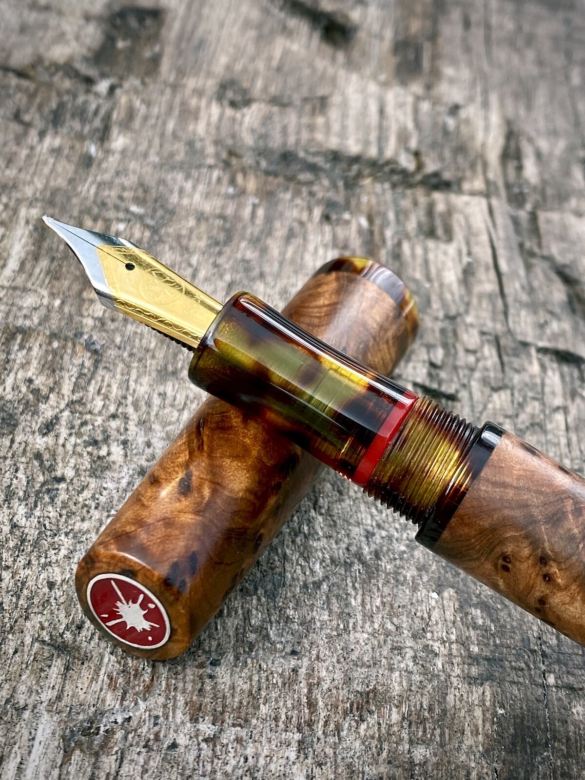

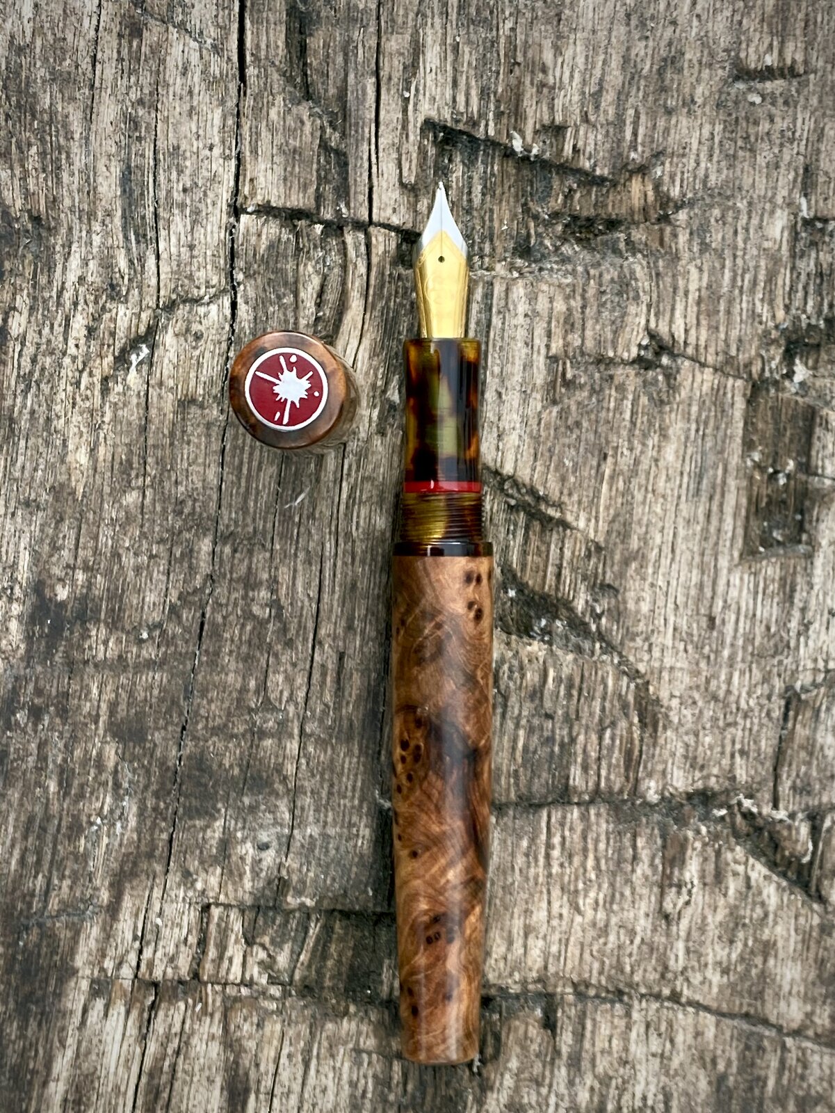

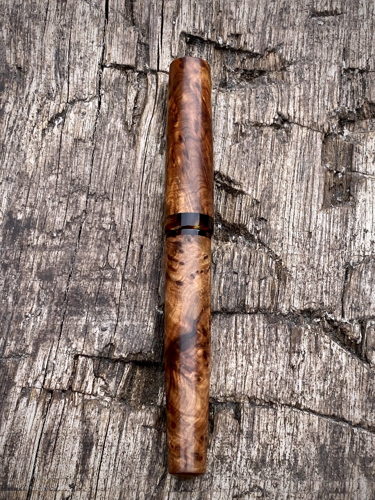

Really like this wood. I've used tortoiseshell cellulose acetate for the threads and section.
It has a Bock two tone number 6 nib and is finished with a sterling silver cast ink splatter logo coin in the finial.
cap threads: triple lead 13mm
section threads 10x0.75
Length closed: 140mm
Length open (doesn't post): 134mm
cheers
