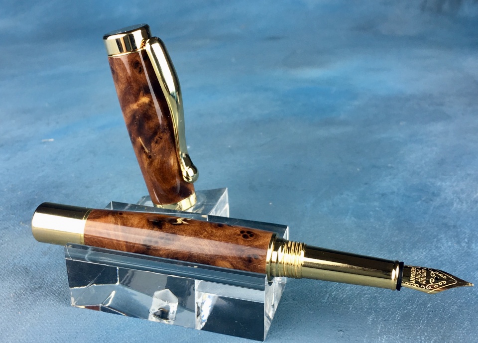

Here is the completed pen. As you can see I agree that thula burl is a great wood and that CA glue makes it look great. I also know that many of you have had success with it and have shown stunning pens.
What I asked about is how to be sure the oilyness of the wood did not interfere with securely gluing in the tube. It could be I bought wet blanks or extra oily blanks. I was hoping one of you had this issue and had suggestions for me.
