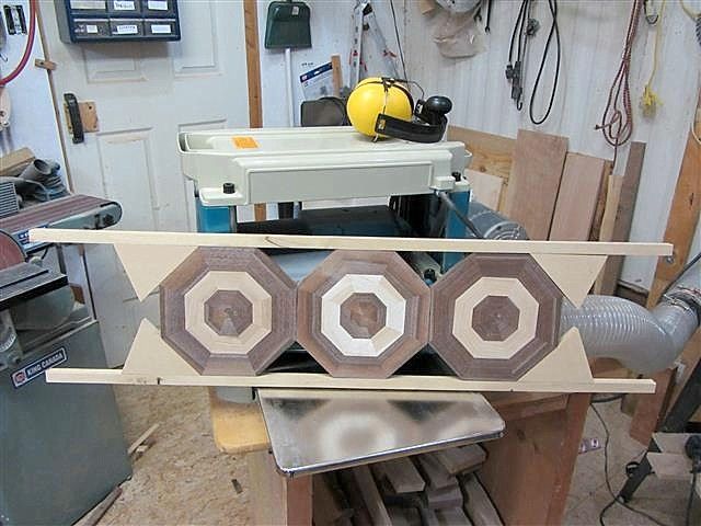

Cut and glued up some white oak and walnut segments into boards and ran them through the planer to look like this. The sacrificial strips are to eliminate any chance of snipe so each blank is identical thickness throughout .

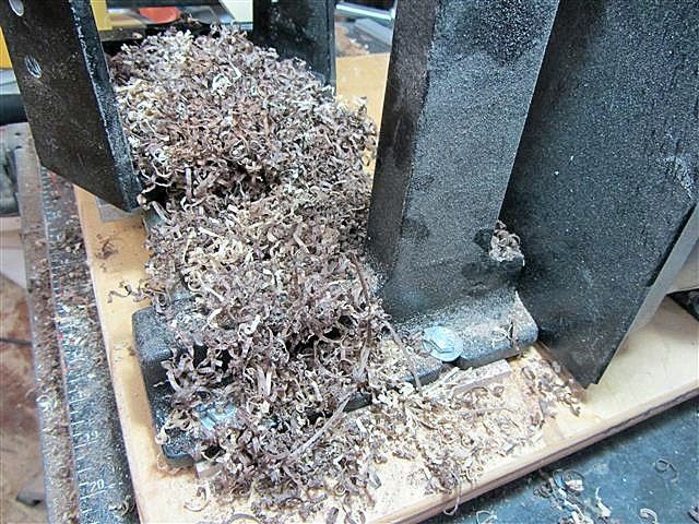

Gotta love the nice curly shavings that come off segmented ones like this because there is no end grain to contend with which also makes for easier sanding and finishing . Easy clean-up . I just suck them up with the shop vac .

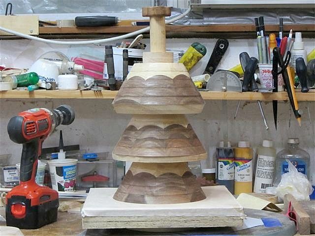

Here are those three boards with the rings all cut out and glued and in the press .

Wish I had made a 'glue-up' jig that looks like this. What a space saver!

I too was impressed with your glue up station. Space saving idea. As usual, your bowls are terrific. I always enjoy seeing the bowls you make. They are beautiful. Do you have any problems when sanding, as the sawdust from the walnut is pretty dark? Does it darken the oak, or do you have a technique to keep that from happening?

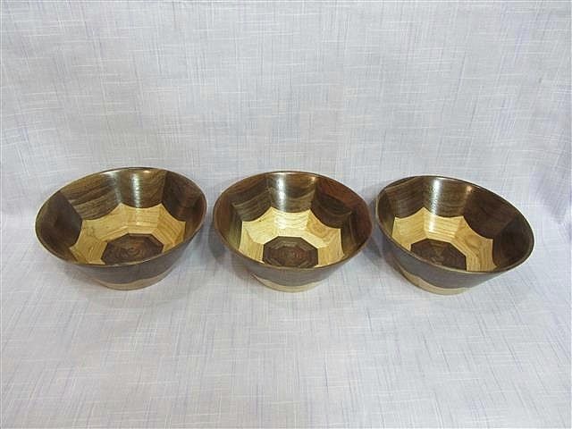

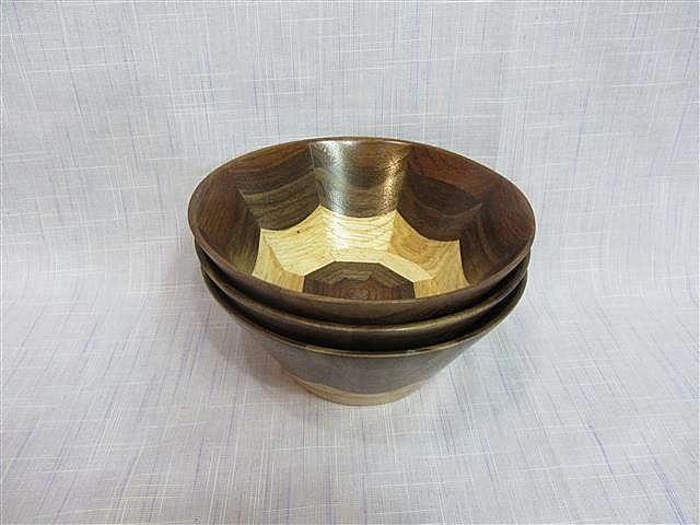

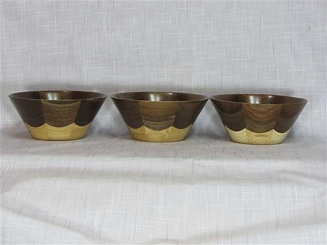

Sanded them to 400 grit followed by fine synthetic steel wool then sealed and set up my HVLP gun and sprayed them with four coats of WB lacquer.
Here they are hot off the press . . . .lol . ..

1 These are naturally square bottom bowls correct?
2 will you try to sell these 3 as a set? I do understand that if someone makes the correct offer for one piece the set can be broken, but wondered about your intention since you took. the time to make them all be the same

By square bottom I presume you meant flat . They are round with a concave in the center so they sit flat on any smooth surface without rocking .
I doubt if they will sell as a set but of course if someone wanted to purchase them that way I would certainly give a discount.
The only reason I make two or three the same is because the laminated and segmented ones are my best sellers so I know I will never be stuck with them and it saves a lot of time compared to if I were to set up to make them individually . It is all about being able to save time and be able to offer them at a price that will sell in a particular area .
I will price those at $35.00 each = $105.00 but would likely let them go for $85.00 to $90.00 for the set .
