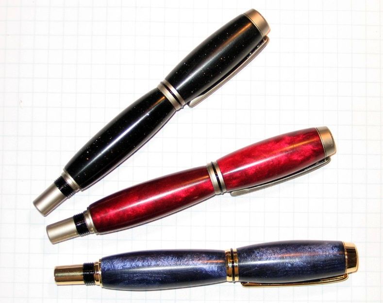

This material is new to me. I generally don't like drilling or sawing round blanks and this has done nothing to change my mind. The other "joy" of this stuff is that it ribbons way, way too well. I had one that I stretched out to a few yards before it broke. Loves to wrap the mandrel, bushings and the turner!
But they are shiny, ostensibly tough and I am sure someone will want them, all in Barons, the black and red in satin nickle, the purple in upgrade gold.
Ooops.. three strikes in bowling is a turkey.. hope that isn't an omen.

They look great! Did you have troouble getting all the fine scratches out? I have found it takes a lot of elbow grease and scratch remover to get the shine back. What type of finish did you use and please address the scratch comment. How did you get your finish so nice. Thanks
Again very nice looking!!

I just turned a few bowling ball blanks as well. I bought the blanks from PSI. When I first called Woodturningz to order them I was sort of discouraged. They said that bowling ball blanks were difficult to get a shine on. I found that not to be the case at all. They polished right up and look terrific.
They're great to turn .. plus you get lots of material to work with for larger pens. I need to call Ryan and let him know about the great results I had.
DocStram
Feb 16, 2006
3,429
Pittsburgh, Pennsylvania
One more thing about the bowling ball blanks ...... when I first got mine in the mail I was a little worried about the colors of the blanks. The "Crimson Red" looked kind of plain and boring. But once that thing starts to get polished .... jump back! You're gonna be very surprised at how beautiful it turns out. Just take a look up there at Steve's!

Very Nice work with the bowling ball blanks. The pens look great!
I have turned alot of BB and I have found it very sensitive to scratches when final finishing, also the issue with the air pin holes....how are you dealing with the air holes please...
