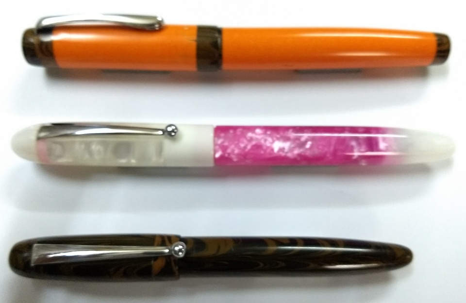

Three kit-less pens completed this evening.
See more from sanyalsoumitra
Apr 27, 2013
261
Kolkata

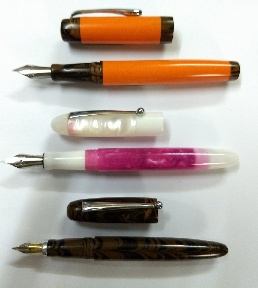

Completed these three pens this evening. The smaller one took some extra caution. The pink one is made from other blank leftovers. The orange one is very close to another pen shown recently, with a different clip. I am happy the way the pens turned out . Hope you like the design. Welcome comments and criticisms.

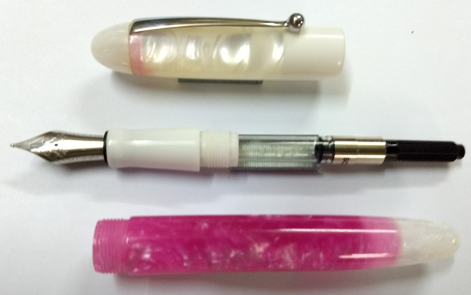

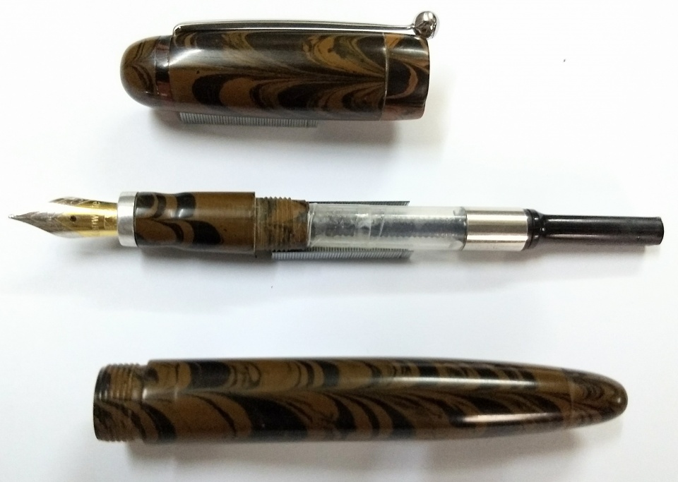

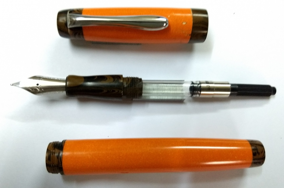

I use 0.8 mm pitch metric thread for cap to barrel and barrel to section.
( I do not make any threads inside the section, just glue in the sleeve of the nib unit. However I will be receiving the 7.9 mm tap for.Jowo units very soon. By gluing in the nib unit, nib unit complete are not swappable while on the other hand I can make the section n much slimmer yet strong using support of the sleeve.)

I do not like to use taps and dies for the thread making, instead I make the threads on the lathe. So in theory I have no diameter restriction that way. However, l use mandrel s for turning the cap and barrel. I had made three sets( pairs) of mandrels 13 mm, 12.5 mm and 11.5 mm in the barrel to cap diameter. Generally I remain in these confines but that is not a binding. Mandrel making using my small and weak sieg clone lathe is a bit of a tedious work. My lathe is no good for working on hard steel rods, for wood and plastic s it is ok.
