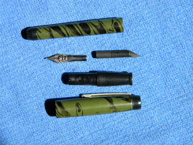

I see people wondering about what taps, dies, drills, etc. to get so they can start working with kitless pens and being inhibited by the cost of everything without knowing if the will like doing it.
So here's a simple solution, you probably already have everything you need to make a kitless if you do it a bit differently (which does not mean doing it second rate).

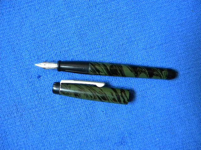

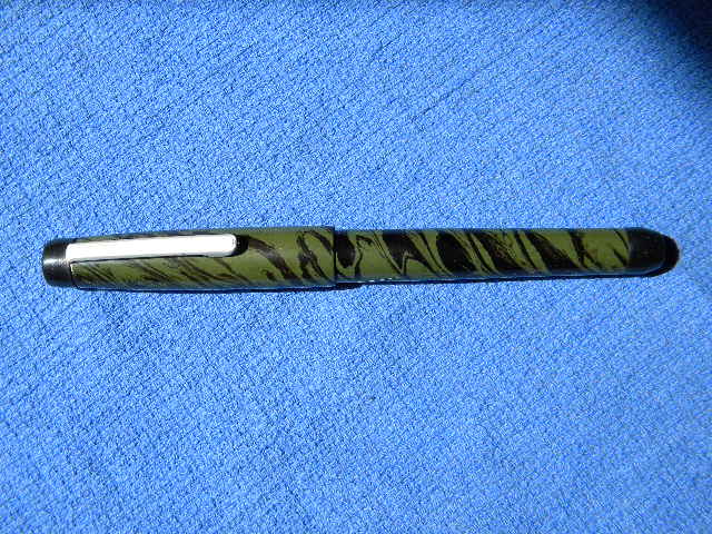

Here are a few pictures (my horrid photography as always, which is why I rarely post pics). Everything here is done with nothing other than drill bits and a lathe, no thread cutting. The section, cap, finials, etc. are made with drill bits and are all hand lapped to a perfect friction fit with no threading.
Everything is made from some leftover pieces of Ebonite I had and the feed is also Ebonite (a sort of generic 6mm feed available from a few sources and used on a number of commercial pens, about 5 bucks or so). Clip is left over from something I don't remember and nib is a Jinhao 6mm medium nib (about 2 or 3 bucks). these are the only metal parts on the pen. I made this quickly and didn't put much effort above minimal quality to finishing, but the pen actually looks a lot better than the picture.
It can be made from anything you want and have on hand, just experiment some and have fun doing it. (A note: if you friction fit the cap well enough, you may need to drill a very small hole in the finial to let air in when you take it off and avoid sucking too much ink into the feed with a vacuum effect.)

Yeah, it's an eyedropper. That's about all I make anymore, I like the larger ink capacity and less filling with an eyedropper.
Hand lapping is custom fitting the parts to each other by very carefully sizing them to their final fit by the use of abrasives. This can achieve perfect fit or a slightly tight or lose fit as you desire instead of being tied to the size of drill bits and machine tolerances. YouTube gives examples, but they need to be adapted a bit for use with a pen instead of machine shops fitting metal parts and such (it's actually easier for pen materials).

The important dimensions, the ones that are lapped to very close fit so there is no leakage, are the ones that count, are internal and they don't need to be polished since they aren't visible. (they can still be removed for filling since they are just short of being a press fit and can still be pulled apart (think about a stopper in a bottle that just barely fits tight enough to be leak free). Silicon grease aids in keeping them freely removable, especially with Ebonite, but a lap fit shouldn't leak.)
For an eyedropper filler you remove the section and fill the body with ink using an eyedropper or syringe. You can get 3 to 5 times the amount of ink contained in a cartridge or converter that way, depending on the size of the pen, and it makes it easy to use the last drop of ink in a bottle.
There's no reason you couldn't design one to use a cartridge or converter instead if you wanted, just a little more complicated to do it that way. I like simple.
Ok that certainly makes sense. Last question, I think :biggrin:, where can you get the filler piece? I've never seen one loose like that. Or should I just buy one of the assembled ends from one of our great vendors and take it apart?
I assume you mean the section, or the feed? If not let me know.
The section is made by you, the feed (I used an Ebonite one since I far prefer the performance of Ebonite to that of the lower cost plastics that are common now) if purchased since it is a real challenge to make them. They are available from a number of sources on the Internet and can be found once in a while on Ebay.
For the 6mm feed use a "G" drill for Jinhao and some similar nibs or a 17/64 for other ones if they are too tight with a G. Fairly close and tight fit is important for the nib/feed to insure proper ink flow without dripping or seeping out the end. I drill the feed bore about 3/4 inch deep with a smaller hole behind it so that the feed sets to the correct depth each time it is removed and installed with a little flexibility in the nib depth to adjust how wet it writes. I drill the through hold around 3/32 and use a longer stub since I've found it holds just enough ink in it to give an instant start after being stored upright for a while (I only made this a few days ago and haven't stored if longer than 24 hours so far and it starts instantly after that time). You have a very large amount of leeway to experiment with here and you don't have to make and fit an entire pen to try out different drill and size dimensions since you can just make experimental sections from scraps and put a drop of ink in them then cap the rear off to try out different ideas.
Glad you're interested, I like people that want to do their entirely own design and encourage you to give it a try.

An addendum, when you are experimenting you don't have to take the time to fully shape the whole section, just use a round rod and leave it like that till you are satisfied how it writes then turn the outside shape of it to something you like.

One thing that might or might not be worth considering: Ron Zorn of Main Street Pens is a pen repair man and restorer who often pops up at Fountain Pen Network. While the use of silicone grease on the threads of eyedropper fillers to prevent leakage is almost universal, he recommends beeswax for 2 reasons. The first is that silicone grease works only because it is hydrophobic, but doesn't really seal. The second is that silicone is a lubricant and encourages over tightening the section and cracking the barrel threads. Would the lubricant property make a lapped joint more likely to come apart?
Beeswax might be a little bit too sticky to work in this situation, although with a little heat, maybe.
I would still like to see some sort of positive stop though.
FWIW
Bill
I hadn't thought about Beeswax, but I think I'll try it.
I use a little silicon grease on the stub as a lubricant to facilitate removing it for refilling, not to seal it (my joints don't leak). Ebonite can be really difficult to pull apart if not lubricated since it is actually rubber against rubber and tends to have a lot of friction resistance. I'm going to try the Beeswax to see how that works, and maybe make one with a acrylic or resin body to see how that works using an Ebonite section (I love Ebonite) both with and without a lubricant or sealer.
FWIW, the entire rear stub of the section is a tight slip fit up till about the last 3/16 inch which is slightly larger to form a very tight fit. It works like an O-ring to both form an extremely leak proof final seal (I did try O-rings but decided it just complicates things) and gives the section a very firm and solid mount in the body.
FWIW, it is tight enough that without the lubricant it is very difficult to remove and even with lubricant it takes a definite intention to pull it out so there is no danger of it accidentally coming out. It is every bit as solid as if it were a threaded joint, maybe more solid, not loose or wobbly or something.
I'll probably try a looser fit on the next one I make, if I get around to making another, to see if it actually needs to be that tight of a fit for the full length or if just the last fraction of an inch needs to be tight to fully hold it with some silicon or Beeswax making the seal on the rest of the stub without it being tight (which would be easier to fit without spending much time doing it).
