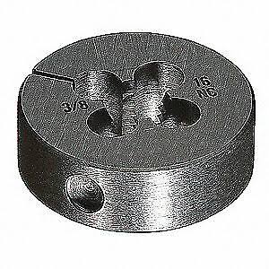

Another thing you can do if your dies are adjustable like this one is open it up and work it back down to correct size.

Also, make sure you have a good set of dies intended for cutting threads. Some less expensive dies are only intended for thread chasing (cleaning up existing threads) and won't cleanly cut new threads in many materials.
