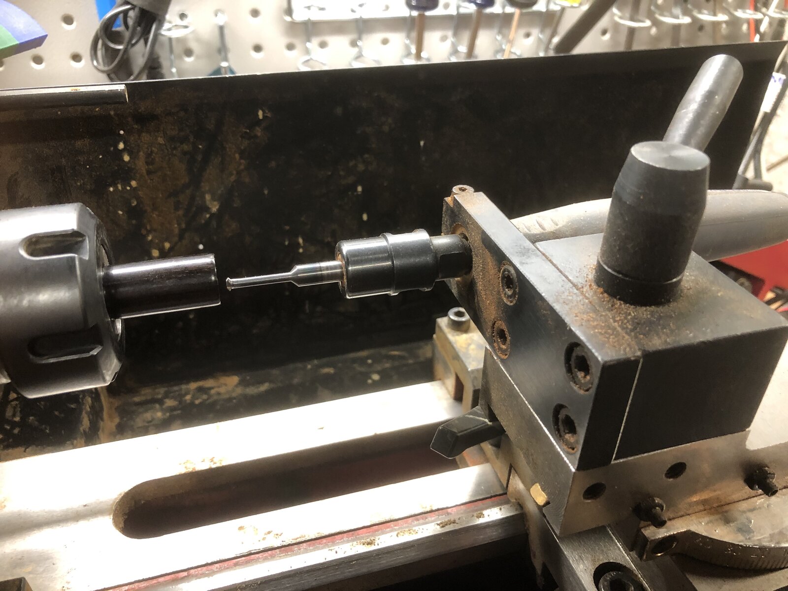

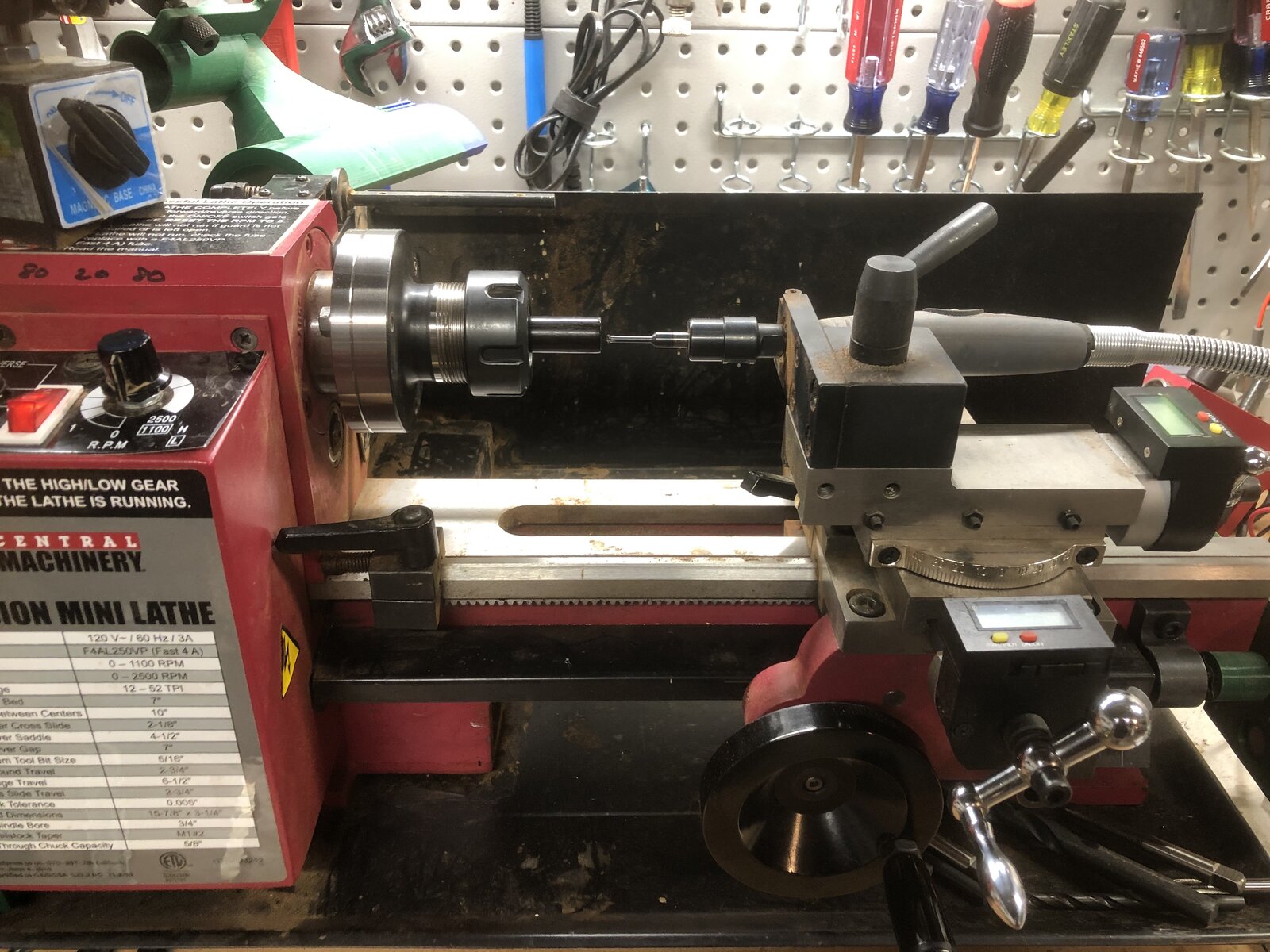

@Pierre--- uses a shop-made custom standalone threading jig using a home made cutter. I use a jig that attaches to my metal lathe and uses a dremel to turn a high speed thread mill. Tiny thread mills are available (I use Micro 100 thread mills from Amazon; they cost anywhere from $45 to $80 or so). This way you can cut tiny threads in any pitch that the change gears on your lathe will allow.

Sure - pics of my setup:

I made one a few years ago, it was basically based on the various commercial units.
I used a camera 4 way rail for a cross slide https://www.ebay.com/itm/2X-Rail-4-...201085?hash=item3b58e0d8fd:g:AesAAOSwKThgRZ3Z
I used HDPE blocks instead of aluminum to construct the parts. I also used a mounted Foredom handpiece as my cutting power source.
The had part was the cutting blade, I never found one small enough for pen making. But I did use it for making boxes.
