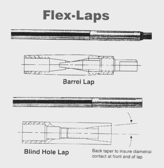

What do you think about using expandable brass cylinder from "Expandable Brass Cylinder Lap" that we can screw on our mandrel?
It'll make it easy to insure good tight fit. With this barrels you do minute adjustments to make sure it's not too loose or too tight.
It'll require us to thread the end of our mandrel to accept the brass barrel.
In other words our mandrel has about 3/4" long threads for nib holder and then instead of long unthreaded part will have a short threaded end(just like on the shank on the picture below) to accept brass cylinder.
These brass cylinders are very accurate and stay concentric when expanded.
Cost of a barrel is $4 and they come in small size increments.
You can find them on www.mcmaster.com
Expanding barrel:
Adjusting screw:
(you rotate this screw to expand barrel)
Whole lap assembly:

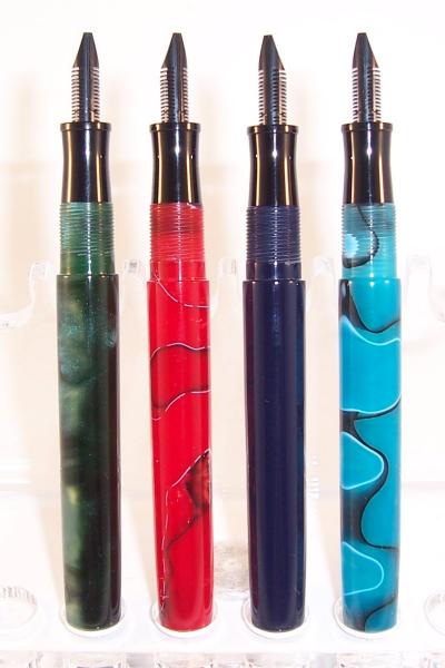

In preparation for an upcoming pen show I made these pens yesterday and there wasn't a mandrel in sight and they were made on a Jet mini lathe. I'm working on the caps today and don't plan on using a mandrel on them either, just my trusty Beall collet chuck. These front sections are not made by me but even the ones I make do not need a mandrel.
If interested in an alternative to using mandrels PM me and I'll share some thoughts.

The nib holders sold by Lou are "stepped" (e.g. the diameter changes several times across the length of the piece), so I think what Alex is looking for is some guidance as to whether or not any mandrel he might make to support a custom front section he is making might also have to be stepped in order to properly support the piece, or could he get by with some sort of expanding gizmo, etc...

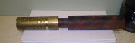

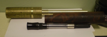

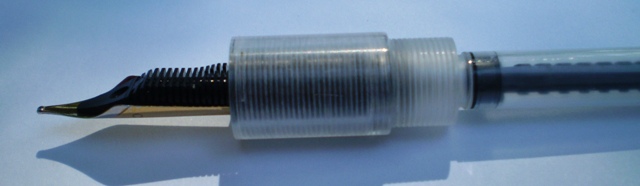

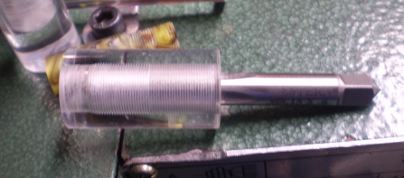

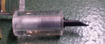

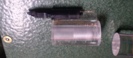

like this? for holding the body.
or this?
I have made something similar, substitute tap for brass mandrel, that holds the section.
PTJeff
Jun 13, 2007
228
Berea, Ohio, USA.
Let me start by clarifying your question
How should a mandrel for a close end fountain pen for Lou's nib holders plastic should look like?
To me this is 2 questions.
1. "How should a mandrel for a close end fountain pen"
this represented by pic's #1 and #3
and
2. "Lou's nib holders plastic"
This is what we call the section. The section holds the housing, which is what Lou sells and that is what pictures #2 and #4 represent.
