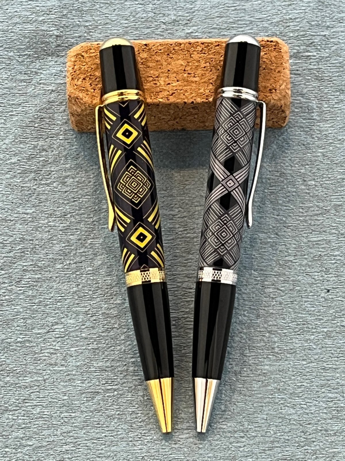

For anyone looking to add something new to your pens, I will be demonstrating how to Thread Wrap your blanks to give a whole new look to your pens. From start to finish this demo will get you started on your journey to something new. Thread wrapping is not new to pens but there are only a few turners that I know of willing to take the plunge. Johnny Max was the one that inspired me to go this road, (or is it a rabbit hole) either way it is worth a look.

I won't be going to MPG (not this year anyway - perhaps a future event) but I looked at the schedule of demonstrations.
Yours would be one that I'd definitely want to see, these pens look great. A future rabbit hole for me, perhaps!

I'm in !!
These are absolutely beautiful. very talented.

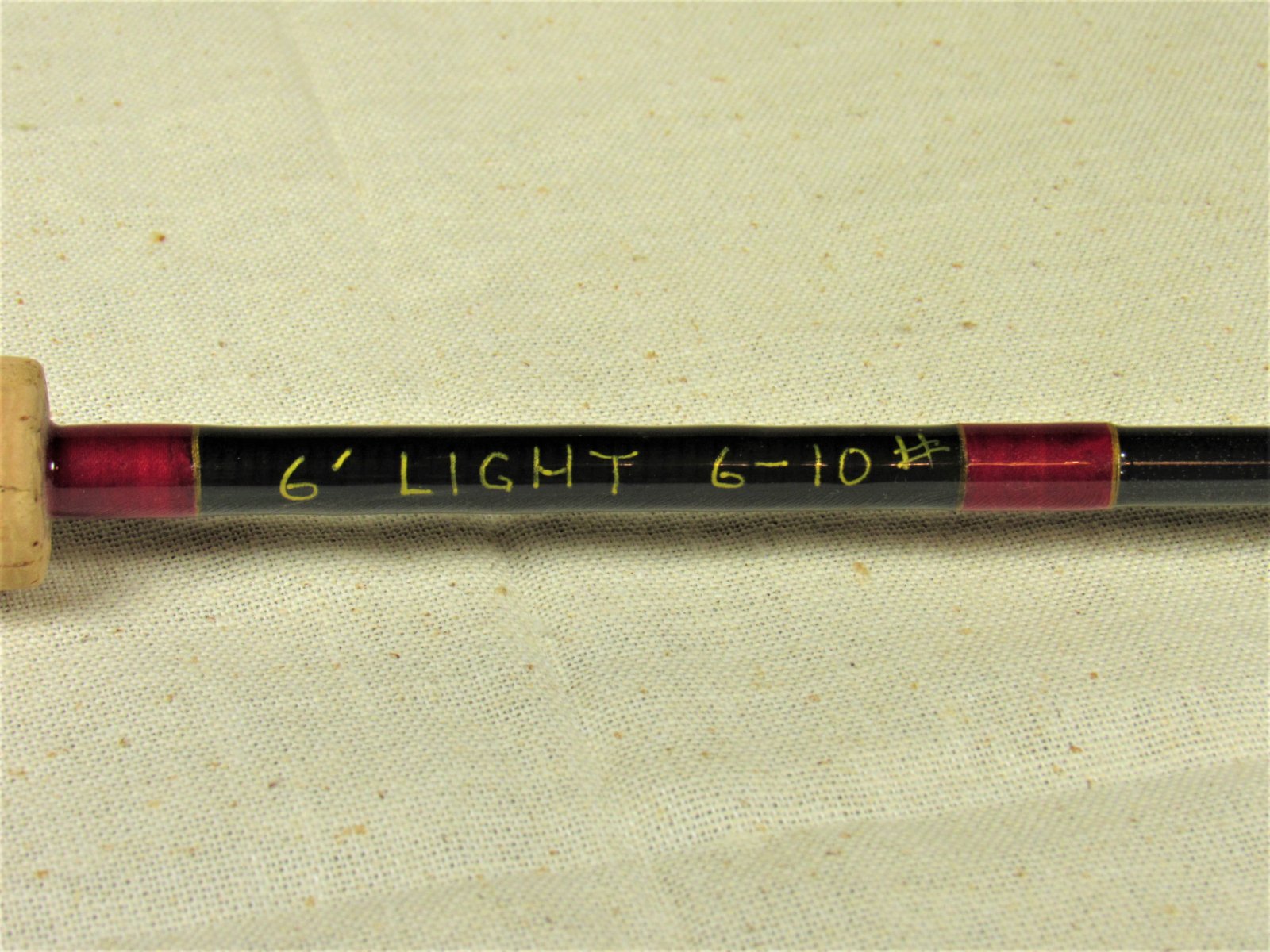

This is done for high end custom fishing rods. Very labor intensive and adds big bucks to the cost. There are several YouTube videos for it; also see www.mudhole.com which is a large supplier of rod building components.
That is correct. Although there are many places to get thread wrapping supplies Mud Hole is my go to place for thread & information.

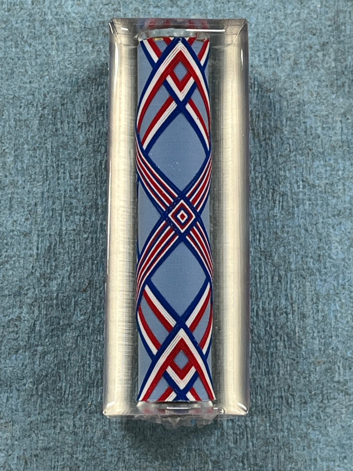

This blank just came out of the pressure pot this morning. It is what I'll be demoing. It covers X's and squares. Running thru the basics of what equipment is needed, and what equipment makes the whole process easier. Those two are not always the same. And the order of everything. If you miss a step you end up stepping backwards.
One of the very basic things to remember is there are only 2 way to wrap a thread on a tube. If the threads runs parallel to each other, that's a spiral. If the thread crosses itself, that's an X. Take that one step farther, if you surround the X, with two other X's, that's a square. After that, your imagination is your only limitation. It's that simple, kind of, sorta, well that's what I keep telling myself. This is going to be fun.

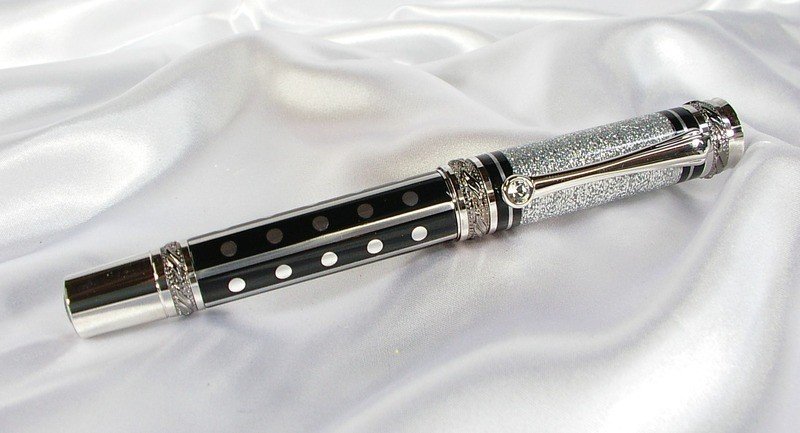

:):):) Not even close to being that simple. I have ordered alot of other stuff from Mud Hole over the years. I bought a few books on the subject too. You need a pattern sequence. Then at times you have so many bobins of thread just laying there and forget which one goes next. I watched videos and no it is not that easy. At least for me. Thus I never got into it. Ted tried giving me some pointers but I am too thick headed I guess. I admire those that can do it and some of the designs that they come up with. I remember seeing many many years ago my first encounter of a pen that had this on it. No one else was doing it for I asked around who it was but no one knew. It was shown on the AAW turning site. It is a talent for sure. I know Ted said he had to find the right resin because some threads would fade when dipped in a resin. That is another thing, the right thread means alot. I have a bunch of thread somewhere. In fact that is what I used for the cap on this pen.

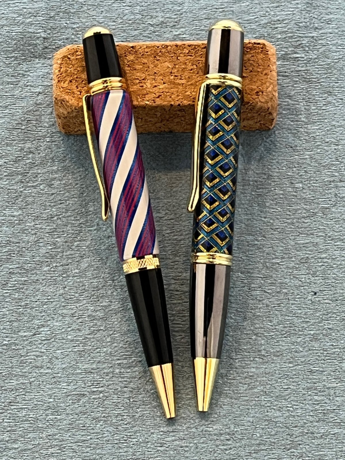

I'll reference Ted Sachs some 11 years ago (thank you for putting that link in this post) that it is more difficult to put into words how wrapping is done than to watch it in person. So, even more reason to come to the MPG and watch the demo. Here is another picture with a spiral and X's. That is taking it to it's basic designs.

Just to clarify, there is Thread Weaving and Thread Wrapping. The two are quite different in their process. Thread weaving is very in-depth as far as individual threads and computer programs just too keep all the single strands of thread straight. That process makes my head hurt just thinking about it. I am NOT doing that one. I am doing Thread Wrapping, where you take one thread color and wrap 1-2-3 or 4 times around the brass tube before grabbing a different color. Hope this makes sense.
RNelson, understood. Did wrapping but avoided weaving.
Did not know that. I am guess in your example, the barber pole is thread wrapping and the box design is thread weaving. That is more what i was thinking about because I seen photos of guys that have lots of spools laid out to one side when making a pattern. I guess in my pen example that is thread wrapping being I used one color thread.
