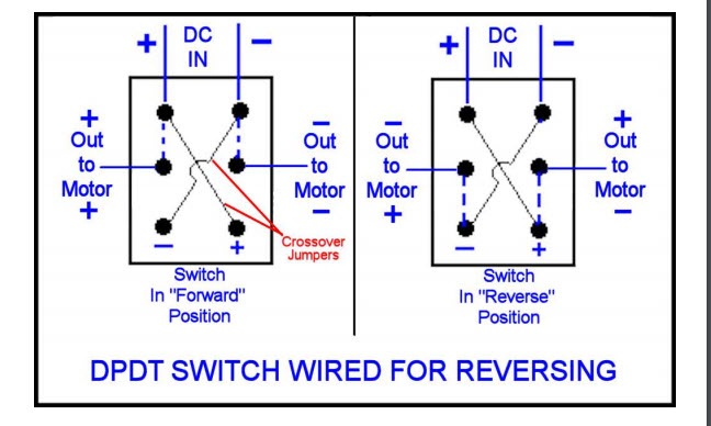

Hello,
Firstly I purchased the following toggle switch
https://www.amazon.com/gp/product/B001PNHBW6/ref=oh_aui_detailpage_o00_s00?ie=UTF8&psc=1
You place the switch between the the power out to the motor and the connectors on the board. You need two extra wires (I used two 6" approximate pieces) with connectors, (I used some I had in my workshop, standard terminal crimp type, you will see what I mean when you open the power box up. Just make sure you disconnect the power and the motor first. Look for the cable that comes from the motor into the box(It splits off into 2 wires) , these wires will be connected to the motor connection as outlined in the drawing I attached (just make sure you know which one is positive and which is negative and connect accordingly).
You connect the power from the board (That you disconnected the motor wires from) to the switch where is says dc in. The plus and negative are labeled on the control board that you unplug the motor wires from. The whole mod takes only a few minutes. It took me longer where to decide to place the switch, I did not want to mount it outside the control box. I then drilled a whole next to the speed control to mount the switch. NEVER switch the direction of the lathe while it is moving. WAIT till it stops then flip the switch down or up to the required direction. The center point of the switch think of as neutral,. I then printed two labels using a label maker (FWD, REV) and placed accordingly. If you have questions just ping me pmbroth.ny@gmail.,com
Brian

4. There is no reversing function, and there is a hack for that also.
