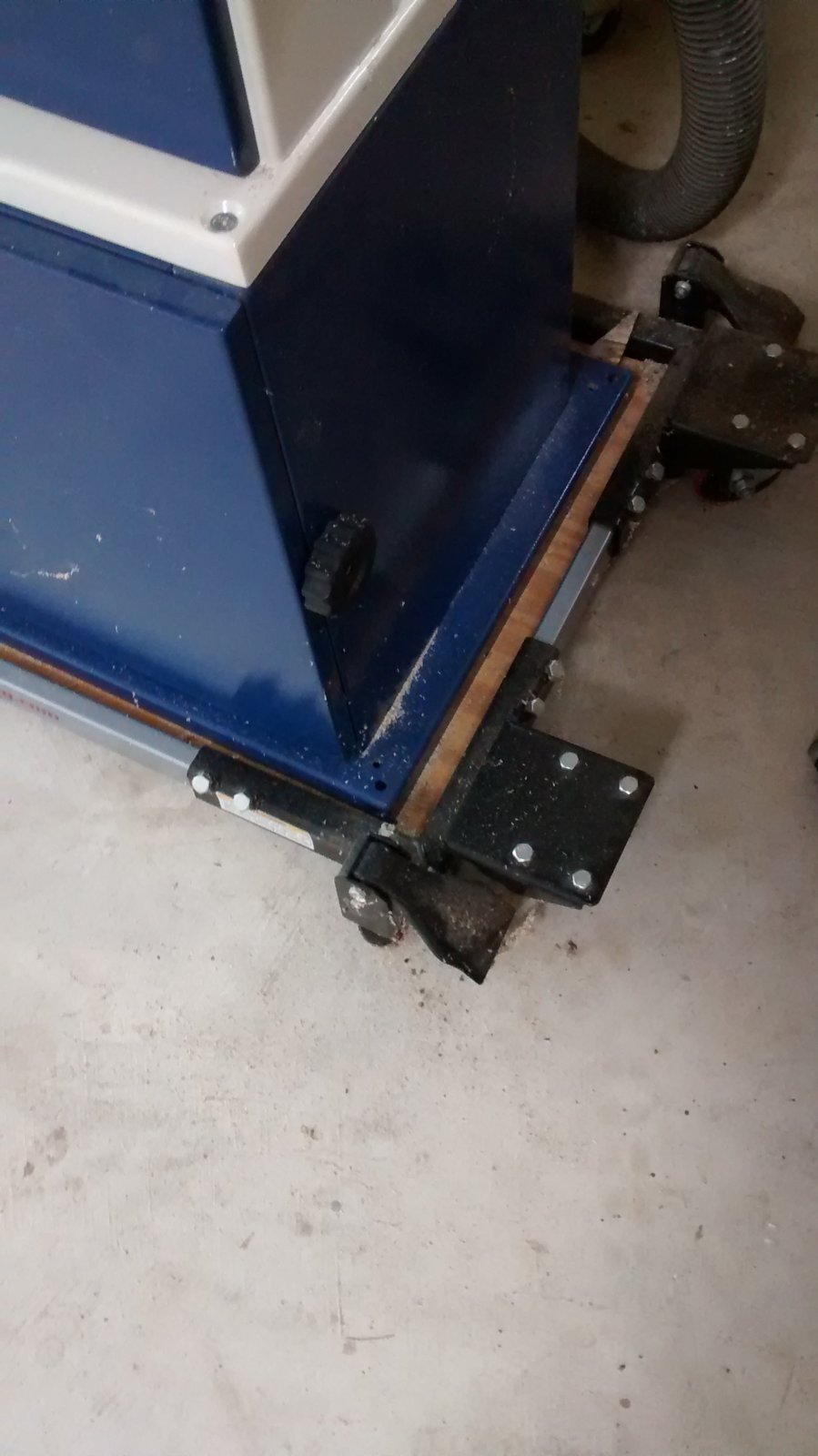

- after fretting over the exact same problem with the base on my Rikon I ordered the Bear Crawl anyhow. My first thought was since the bars are metal/independent I could simply cut them to length and make the base the exact size required for the band saw base. Then I got to looking at it after my trial assembly and thought, that's a lot of work to get rid of what essentially amounts to an inch each side. So I decided to make the base as small as it would go and simply drop a pc of 3/4" ply in the bottom and set the saw on that. Problem solved https://www.penturners.org/media/img_20191102_150627594-jpg.35169/
- although the saw is not mounted to the plywood nor the plywood to the Bear Crawl, I have no tipping of the saw in use or movement. And I have shoved some pretty big logs through it. But, you could mount the saw to the plywood and the plywood to the Bear Crawl base and have essentially the same solution as the Bora base you cited and a lot sturdier side rails with the Bear Crawl base.

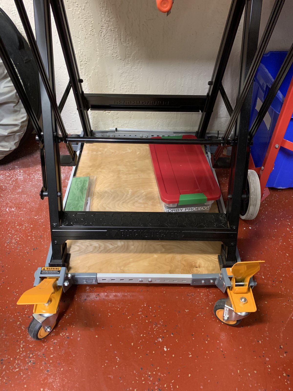

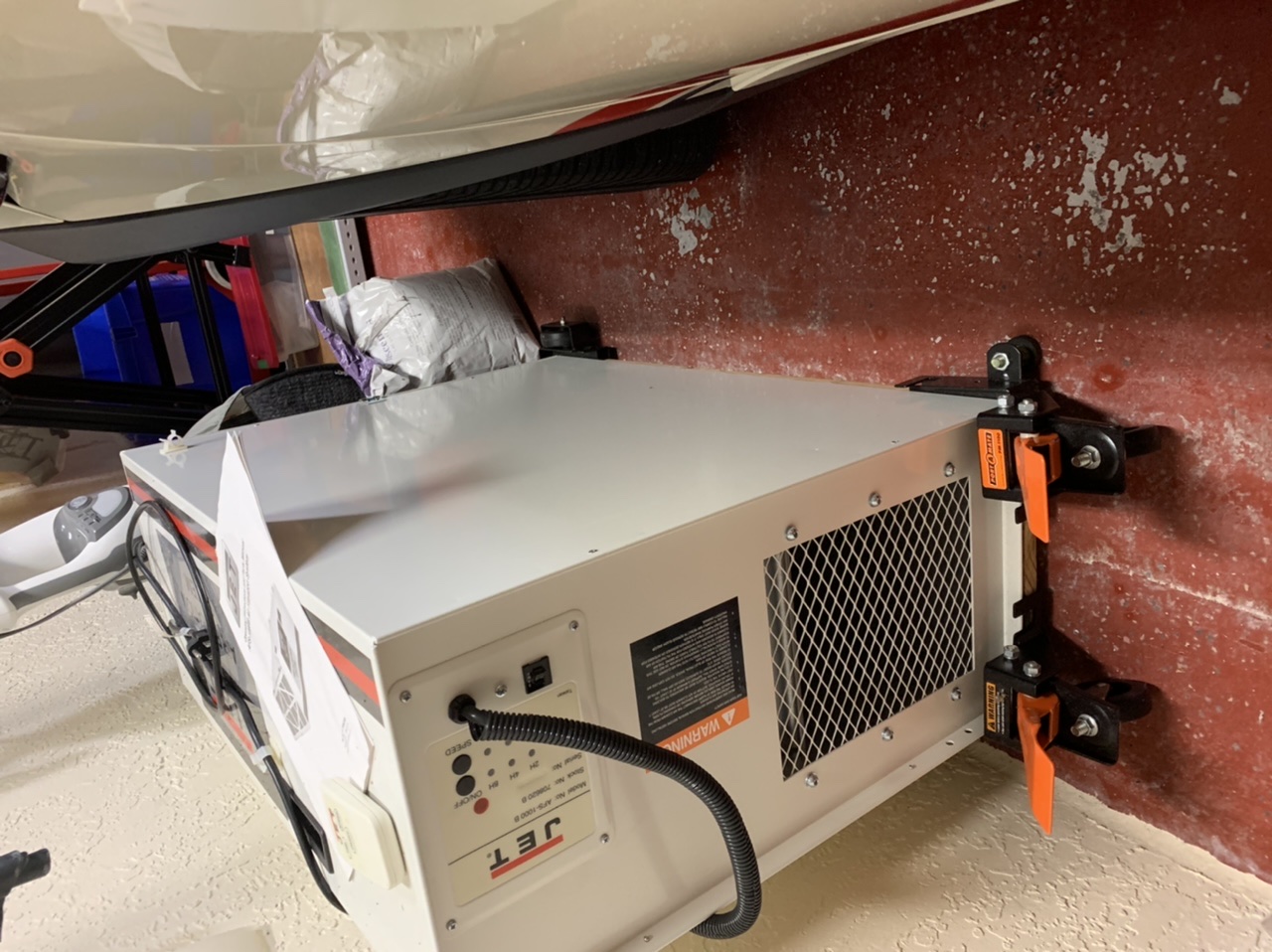

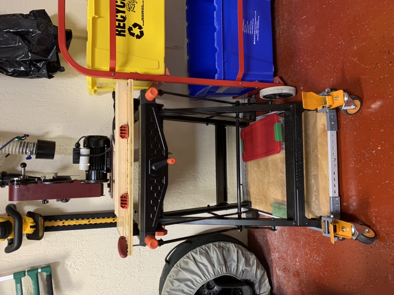

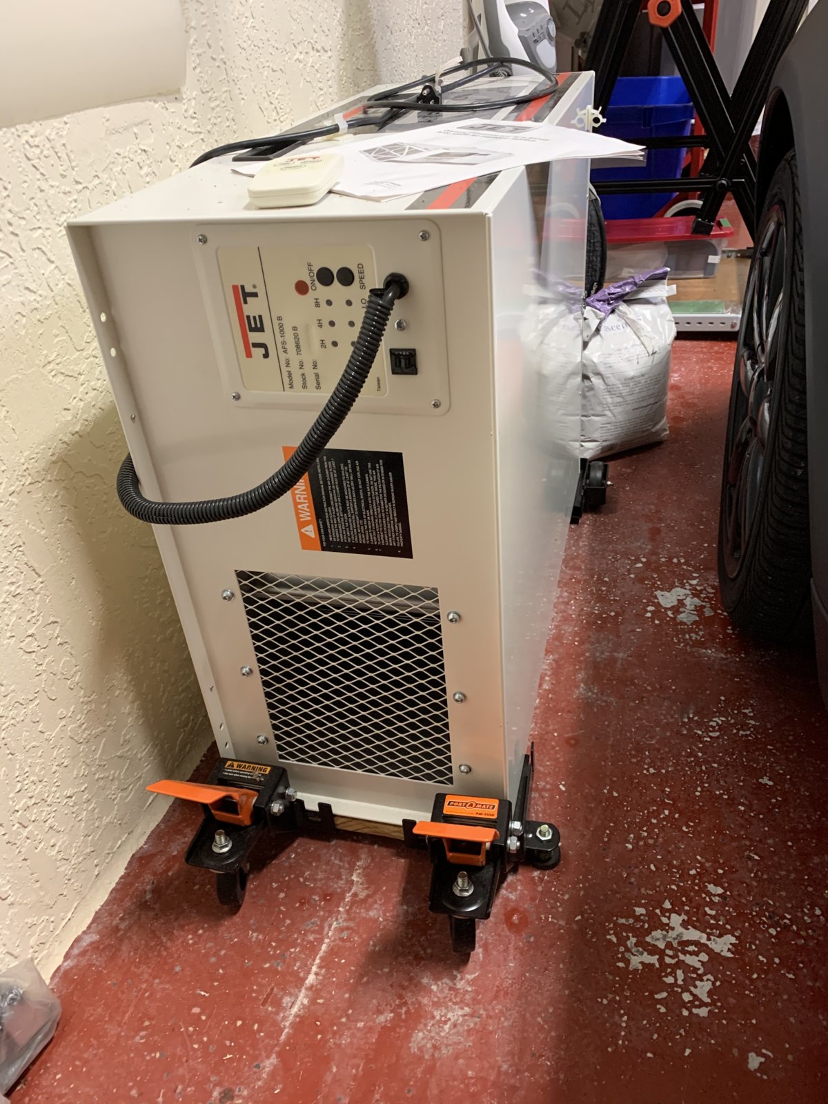

I have the PM1100 and the PM2500....would buy both again. The 2500 can be figured to a limited amount of sizes...(Check your project footprint). The PM1100 is as Long & Wide as the board base being used. Sorry about pics. Will figure out how to rotate
Better pictures. Hope they help
