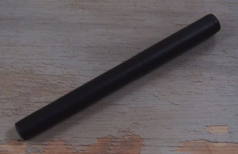

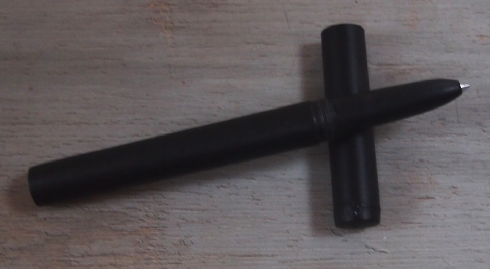

I am playing with a slimmer Rollerball using 1/2" round aluminum stock and powder coating. The 1/2 round stock does not leave much room for more contouring, particularly on the upper barrel. This is my first try. I think the nose cone needs more taper and I could taper the lower barrel. Would add a clip or roll stop and use more vibrant colors. Any thoughts, criticisms or comments.

I use 10 x.75 inside 12 x .75 single cap thread or 12 x.8 triple cap thread, on a pen with .510 od body and .565 od cap. (apx 13mm and 14mm)
I use 8.5 x .75 inside 10 x .75 cap thread on smaller bodied pens and caps.
That allows me to make them either roller ball or Fountain pen and still use a converter.
I use a through hole of .307 to allow the converter to pass through on the 8.5 threads.
I use 9 x.75 or 8 x .75 if I have no need to worry about it being used as a fountain pen.

I like it. I made one similar in shape and size out of a RAW kit and pheasant wood. It feels great in the hand, but without anything to define the cap or a clip its not obvious that its a pen when closed.
Taper the nose cone and add a few details.
Nice work!

My comments are only to the color, finish and profile - I have little experience to add to the other issues.
From what I see, a black matte finish - I LOVE that! The basic profile of the finished pen I also like. A slight taper at each end might be nice, but as displayed, it's very nice.
Very nice, Cody.
I'd love to see a version with a slight taper at both end, same finish and no roll stopper or clip! (How's that for a request!!)

Love the matte black... makes me want to see how it would look in matte purple (hint hint :wink: ). I like the look of the closed pen a lot, but I agree that more of a taper on the nose cone would look a little better.

Love the body and cap shape. I too think the nose cone could use more of a taper, or maybe a dished area like a fountain pen section then the short taper to refill.
Loving the flat black. I'd like to see you get crazy and add accents in red.

As a lover of the aluminum Raw kits, I really like this. Personally with a pen as simple as this, I think a small roll stop would look nicer than a clip.
