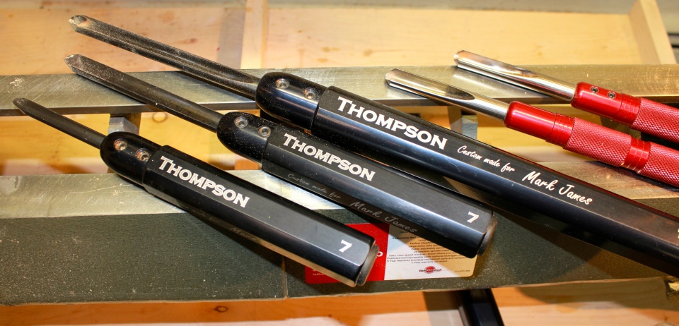

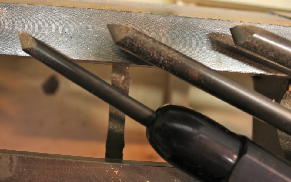

Top quality steel and holds an edge well. Doug Thompson is great to work with. He has several videos available with demos he has done for clubs.
His tools are my goto collection. My favorite is my detail gouge. With a Thompson handle it feels very natural.
