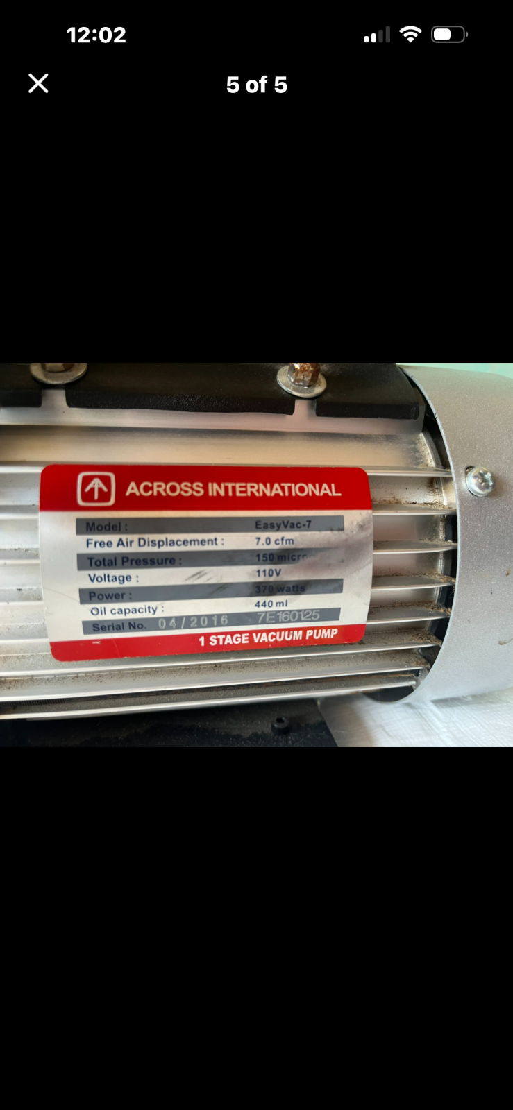

This vacuum pump..
speedybtx
Feb 4, 2026
45
Van Alstyne Tx
Price is good 😀 probably too good.
$40
Probably a 40 minute drive each way.
First thing I thought of, was how to test it !!
There are also several Robinair's listed, typically $100.
Not as close by.
Two harbor fright stores local… 😆

A vacuum pump is for removing residual air from something generally for stabilizing. A pressure pot is used for putting items under pressure not vacuum. Vacuum will create bubbles and bubbles have a tendency to seize up vacuum pumps if you dont see them before they get in the tubing. That is why vacuum chambers used for stabilizing have some method for seeing what is going on in the chamber.

While the pressure pot could be used for vacuum I wouldn't recommend it for stabilizing wood as it requires visual monitoring. At first the fluid has a tendency to foam. Later you need to see when the bubbles have stopped coming out of the wood.
As to the pump, I am on my third (one was robin air). Buy once cry once. Get the one recommended by Cactus juice.

Be patient and look for a good one. Watch for a JB Industries unit. These are the industry standard. All the AC Pros use these. They last for ever and can be rebuilt. The import machines are mostly junk and non serviceable.
A quick look on FBMP in my area yielded this listing. The two "Platinum" units are model DV-200N. This is the unit that I have. The JB Platinum DV-200N is a commercial pump that is made to be left running for DAYS to evacuate the refrigerant from large commercial air handling units. They retail for around $800 new and can be had for $600 new if you look around. I see them on FBMP all the time in the $200-$300 price range. This listing, at $100, is a rockin' deal. I know that it isn't in your neck of the woods, but as I noted above, just be patient and you will find one.
