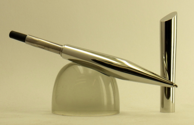

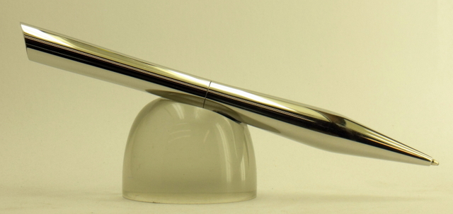

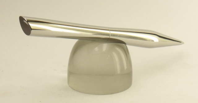

I was so impressed that I actually made this slimline for his Slimline Contest.
But I stopped entering contests a while back....so Derek, I offer this one to you for your great work so far. If you want it, just send me your address.
It is made from two pieces of stainless steel.
It uses the tubes, mech and refill from the slimline kit. That's it.
The top end has an angled concave closed end.
The holes for the tubes were drilled on my metal lathe and all the shaping was done with a couple if files and tons of emery wet'n'dry....and elbow grease:biggrin:
If anyone is looking for inspiration for making a cool unique slim, then just search for Jay Pickens. IIRC, one of his pens was on the front page on the day I joined. :biggrin:

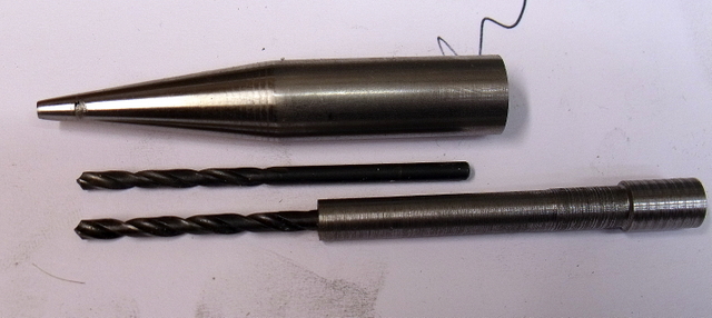

Although this pen is very basic, it did give me a small problem...
Because the 'nib' and the lower blank are the same piece and I wanted a long tapered point, I had to step drill for the refill.
The tip of the refill hole and the brass tube hole were both easy but as you can see from my first attempt, I had a blow out when I tried to drill the size for the refill thicker part, with a bit that was long enough but too big.
The solution, ( which I've done before :rolleyes: so should have known better)was to make a drill bit extension for the correct sized bit.
Took me about 3 minutes to make the extension but about an hour to remake the nib.
Why is there never enough time to do a job properly, but always enough time to do it again????:confused::redface:
Pete, I did put some CA in the hole but then I couldn't get the shank of the drill in and had to the drill the CA out again.
I then had to gently press the bit in ( I used my drillpress ) Seems solid enough to drill out the existing hole from 2mm to 3.2mm. I've used Loctite ( blue ) on slightly bigger sizes before.
Cheers:smile:
