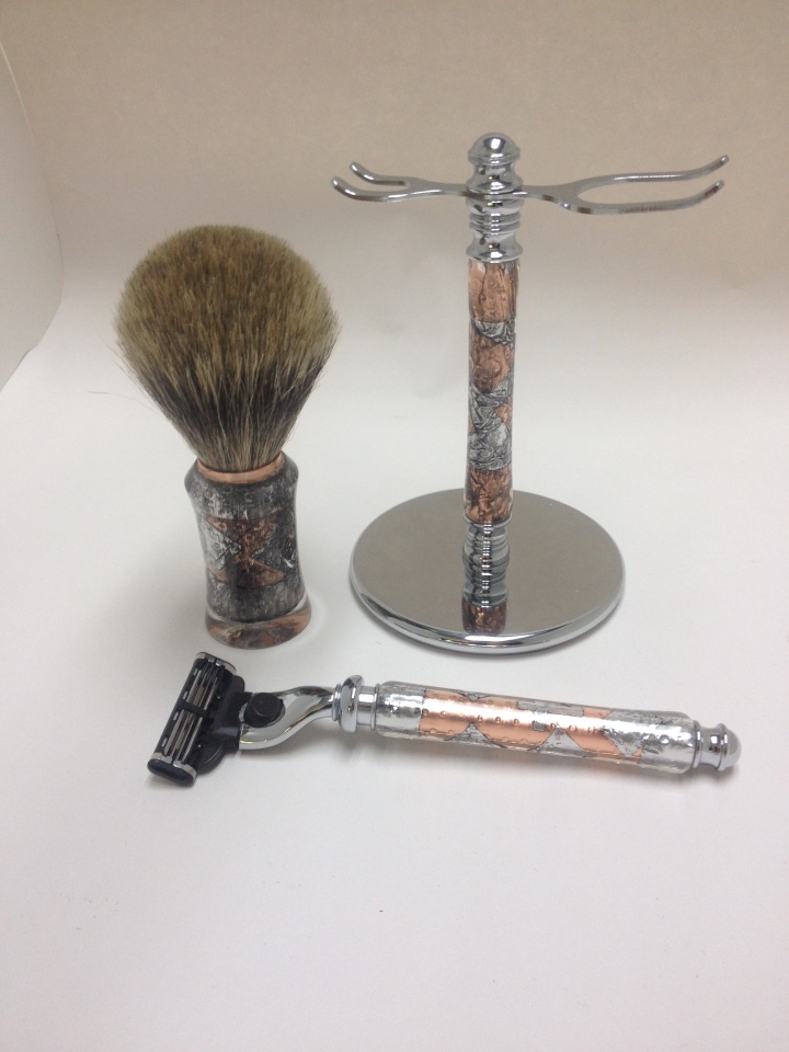

Steampunk. Been working on steampunk blank for the shaving brush for a while now and have about got there. Biggest problem was cracking for no apparent reason. It looked as if it had been dropped but it actually cracked while in the curing process. But I think I`m close now.
Comments welcome. Thanks for looking.

Never had one to crack in the curing process but have had a few resin blanks crack cause I started the components a little crooked or when pressing the components in, the tube expanded causing the resin to crack.

Harry the problem (I think) all along was heat. I do not heat the PR now and none have cracked. Thanks for the comment.
