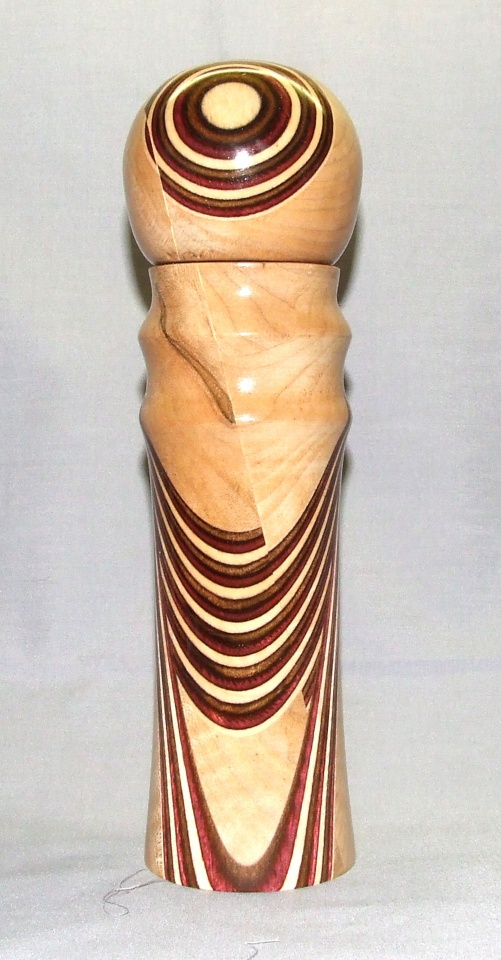

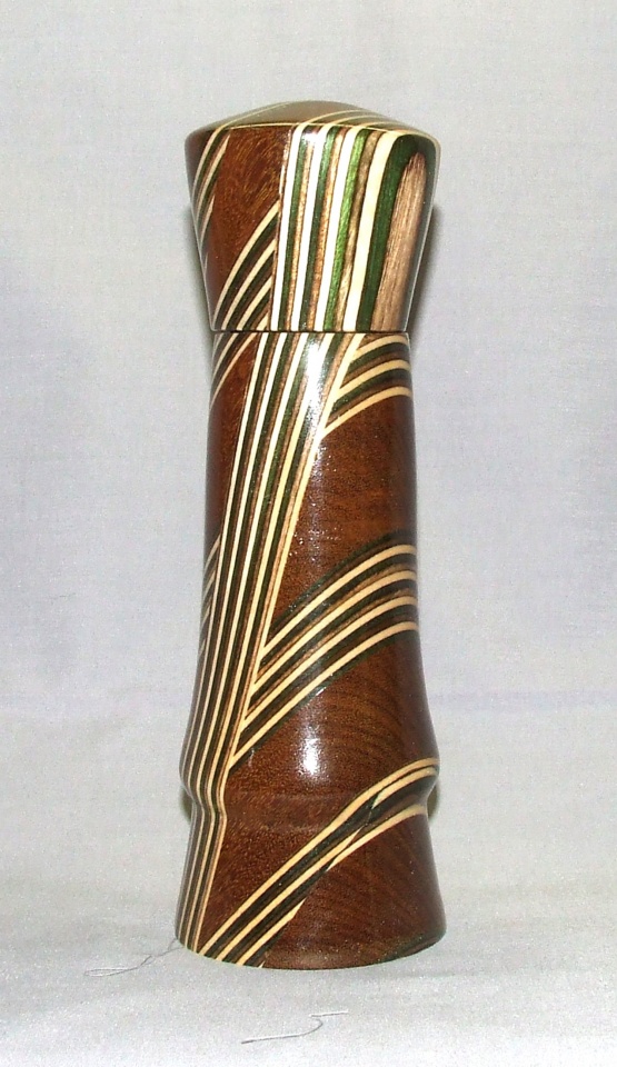

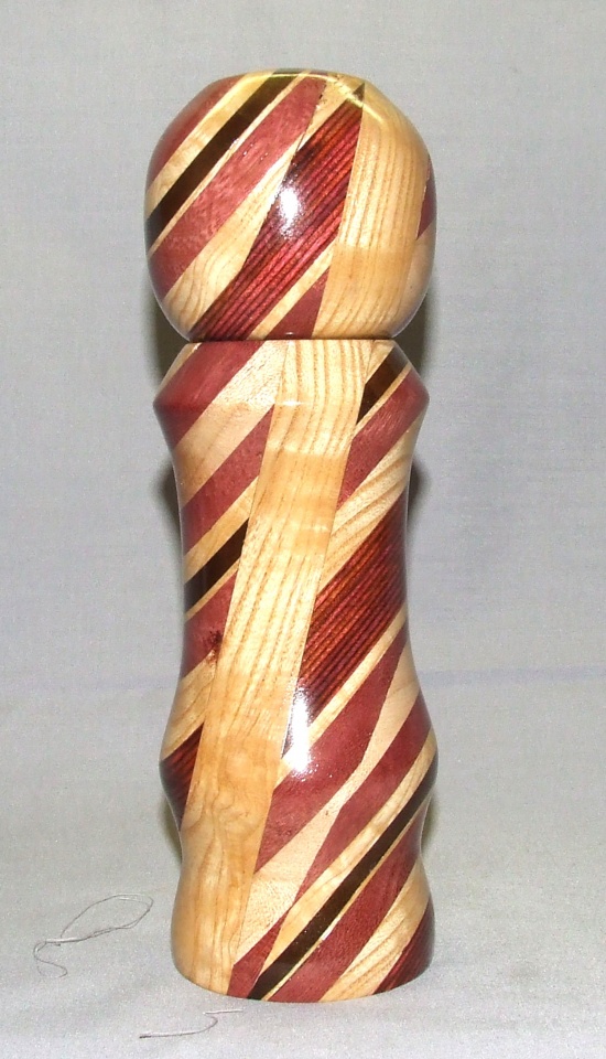

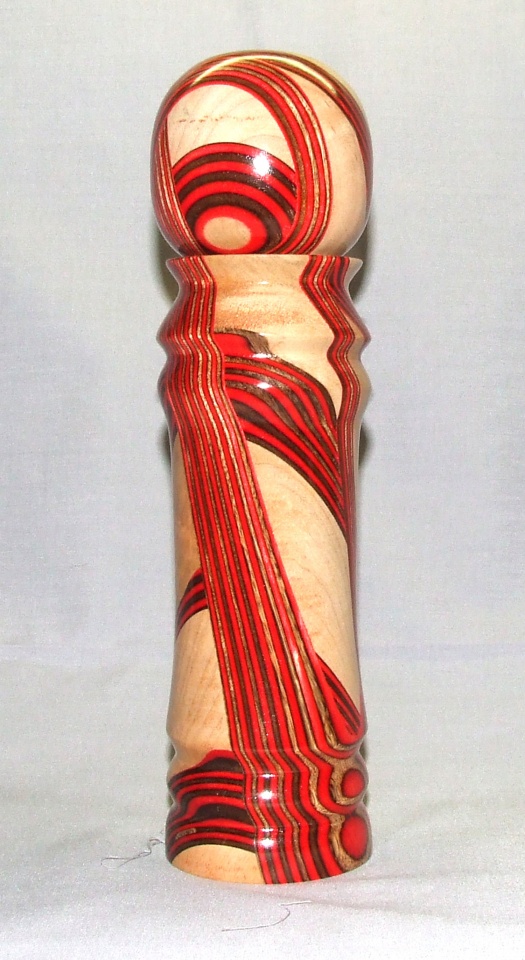

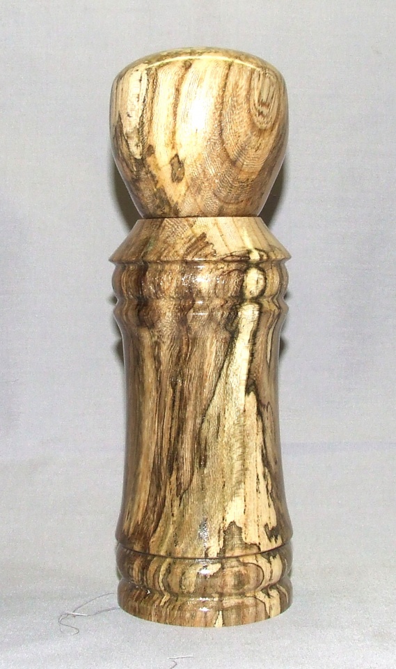

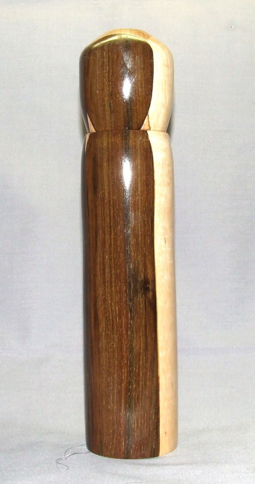

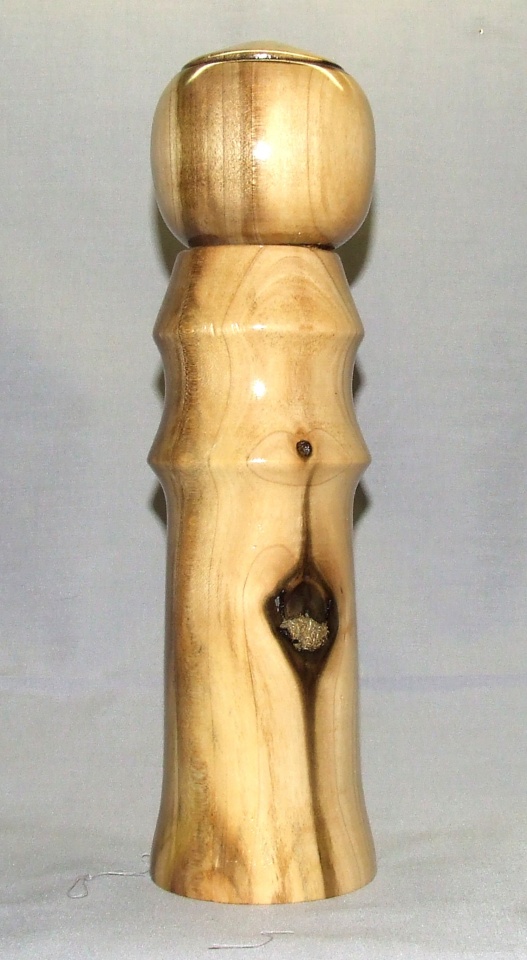

Getting ready for a show at the local Mall next weekend... haven't heard for sure that I've been accepted, but they have asked me several times to participate, so decided to this year... It's inside the mall and runs from 10 am to 9 pm... going to be a loooooong day. Can't let Dianne go with me as she'd never last all day with her back and such hurting the way they do... she'll stay home and maybe Ed, my step son, will be home for that weekend... He's a long haul driver and has just switched companies, and they seem more concerned about their drivers than his previous company... he's asked for the weekend, so maybe he'll be here...I won't have any pens at the show, I don't make pens much anymore, just pepper mills, bowls and wine glasses, plus a few other things....

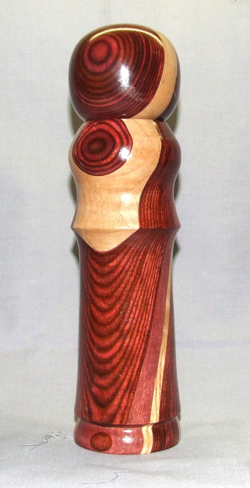

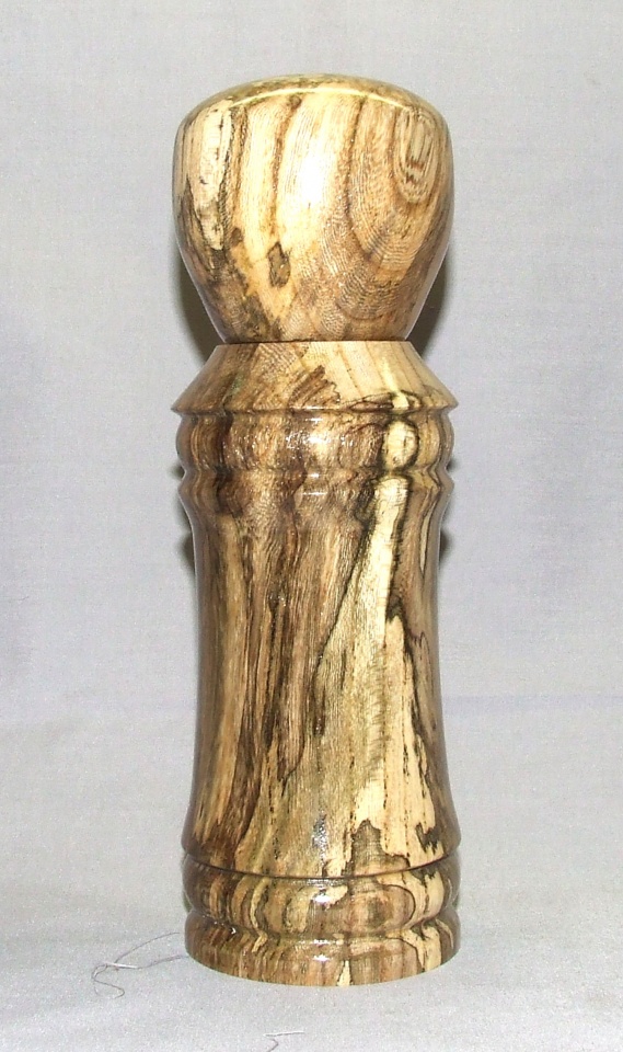

These are the latest mills.. they are all crush grind mills and range from 8 to 10 inches tall, all finished with two coats of Old Masters Sanding sealer and 3 or 4 coats of Minwax Wipe on Poly....
1. Spalted Hackberry, 2. Spectraply Red Rider & Curly Maple,
3. Spectraply Camo Supreme and IPE, 4. Spectraply Royal Camo and Maple, 5. Spectraply Winewood, Purpleheart and Maple, 6. Maple, cocobolo and Brazilian Ebony over an Red Oak core, 7., Greenheart Poplar with a knot hole on one side (not shown) partially filled with brass filings and 8. Ash, Maple, Purpleheart, Spectraply Winewood and Brazilian Ebony.
I did all the glue ups... Nrs 2 and 4 didn't quite come out like I envisioned, but still look pretty cool with all the stripes running across each other.

The glue ups are pretty simple, just a series of cuts and re-glues... I put together a 3x3x12-14 inch blank using what ever boards I have or want to include, then cut them in a diagonal from one corner to opposite corner at the other end. You wind up with two wedges... I then face the original flat sides and reverse the wedges to re-create my square blank. Sometimes put a board in between for additional contrast. When the glue has dried I cut the ends back to a square. Sometimes I will re-cut at a new diagonal and repeat the process...which I did on a couple of these.... for the color I used the 3x3x11 Spectraply pepper mill blanks and cut them to width I wanted to use. I would prefer the blanks were longer, but work with what they are. You could buy the panels already sized to width, but they are really pricey.
Sometimes I'll make a larger block, 3 x 12 or 14 wide x 12 or 14 long, then cut 3 inch blanks out of the width... you can use multiple thickness of board to reach the 12-14 inch width. You can also use long board if you like, I generally stay with the 12-14 inch length as it's easier to handle and most of my pepper mills are in the 8 to 10 inch height... there is some waste on the cuts when you square up the end of the blanks. And when you use the wider blocks, you wind up with the two wedges again and I've always used them to create the last blank.
