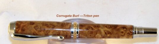

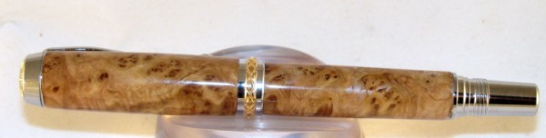

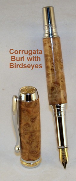

The prettiest pen I have ever turned.
Nature made it, I just found it---but WOW!!
Birdseye corrugata burl with the new Triton components---this is Gold "appointments" on a chrome body.
Comments welcome!!

Wow... That is a BEAUTIFUL! piece of wood... Expertly turned, I'm sure but that is really nice!!!
The color and eyes in there are something else.:eek:

Ed, it's the prettiest thing. You should be proud of it. Kit compliments well too. Info. for the chart?

Ed... you know I like you... we go way back... so with that am I safe to ask you a question?
Looking at it I see a dark area right at the finial, like either the blank burned when milling the end or possibly a bit of the bushing dust made the hop over to the CA when finishing.
Obviously a stunning pen, but you know me. lol

Well, the sky has fallen on that poor pen.
The CA on the barrel section is at least 40% separated from the wood. But the finial end is ok, the dark spot you see is part of the grain up there.
I rushed this pen so we could get pictures. I'll make another, but let the wood rest for a few days after it is turned, before I put the CA finish on it.
May knock this one apart and resand and finish the barrel--don't know yet.
Too bad--it was a pretty pen!!
That doesn't happen with resins!!!!!
