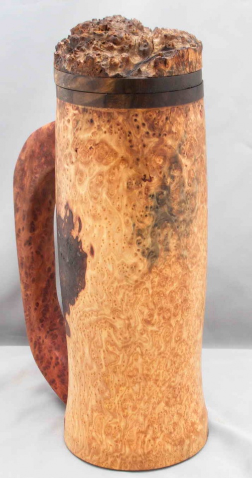

My neighbor commissioned me to make two beer steins. The one pictured is the completed first one. I have never made anything even remotely like this, so it took me a while to work out how to do one.
The stein is 11" tall with a natural redwood burl cap. It is 3.5" diameter at the top, slightly more at the base.
Construction:
I hollowed out the redwood burl and made a ring for the lid and stein out of walnut to give strength to the rim. The handle is heavily burled redwood as is the inside of the lid. The hinge is semi heavy deer hide. It is completely sealed with Mahoney's utility oil twice heavily to soak in and let dry for three days.
Comments, suggestions, and criticisms are appreciated.

Larry, very nice work. I like your use of the various materials. Gives me the urge to try one of my own.

Also think about using the SS travel mug liner instead of sealing the inside.
Hmm, that has got me thinkin' I may have to make one. :biggrin: Beer; Yummy!

The stainless insert wold be a much better idea but he wanted all wood. That is why it has been sealed with Mahoney's walnut oil. It will seal the wood and harden into it. It is not a daily use piece so should be ok.
The second all wood stein should be up in a couple of days or so. Probably after the weekend sometime.

Anyway, I'm quite impressed with this piece, the wood selection and execution are very good and a very "smart" piece, indeed, congrats...!:wink::biggrin:

Fantastic Work Larry! and very inspiring. Your use of multiple woods really catches the eye and that natural burl edge on the lid is awesome! A very well thought out and executed plan! I'm sure your neighbor will be envied by many. He just better keep a close eye on that one. :) Thanks for sharing.
