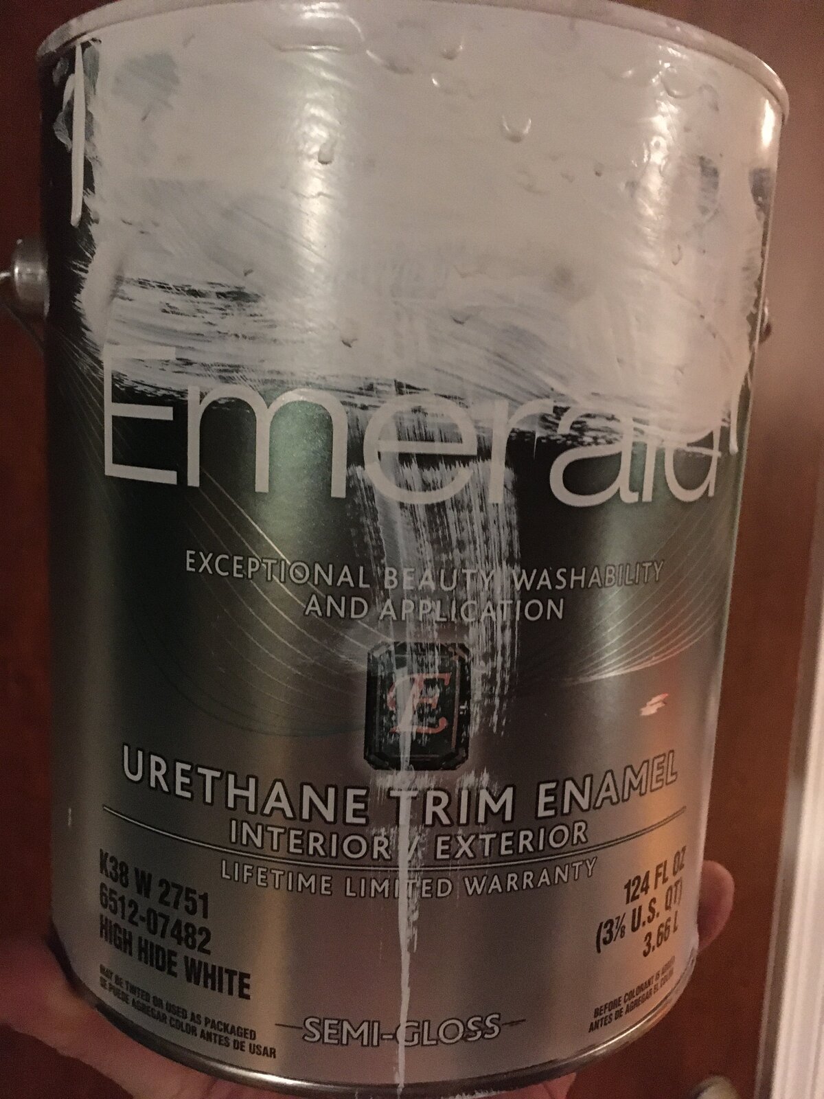

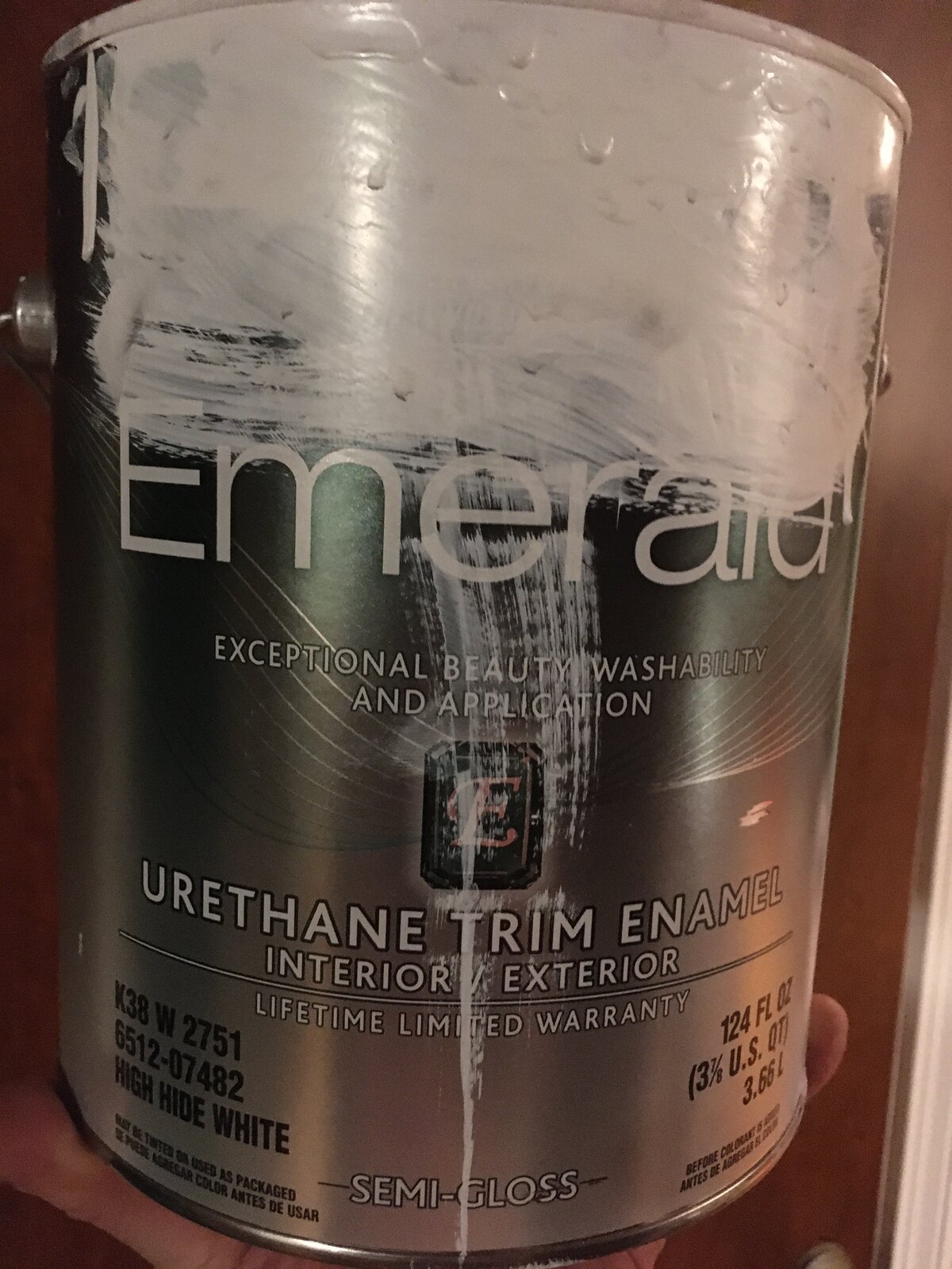

Sorry I thought the data sheet specified the exact paint I was using. Apparently not. Here it is..
That is supposed to be a really good product. I haven't worked in a store since 2013 so I am not as familiar with their homeowner style coatings. I am currently working in water/wastewater using SW Protective and Marine coatings.
I've sprayed that product with HVLP on furniture and thinned about 10% with water and added 8oz Floetrol per gallon (as instructions suggest). Layed down nice, recoated well after an hour and I was happy with the result. I would definitely use an oil-based primer on raw cedar for outdoor use. Speaking of Floetrol, I use it on brush work too. Seems to really improve the finish.
