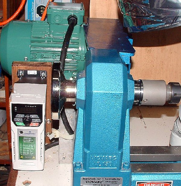

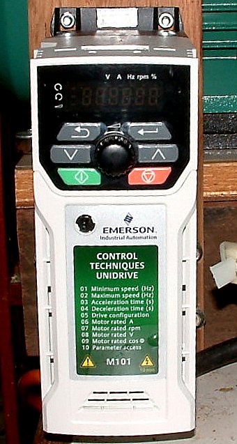

I solved my dilema by buying whats called a bare lathe fitting my own choice variable speed control and three phase motor and I am closer to be able to say my last lathe a short while back at 80 yrs. I chose a VicMarc Vl 150. It has precision that I crave.A consideration also is the shaft thread sizing to enable use of chucks accessories already in use..
Have fun I did.
Kind regards Peter.
PenPal
Nov 29, 2006
2,708
Canberra, A.C.T., Australia.

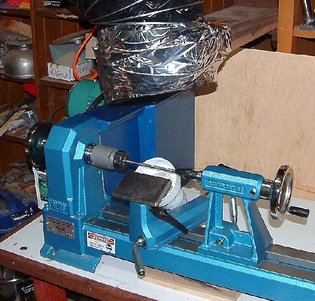

A few pics of my new VL150. The 10 inch high transmission tube goes to atmosphere eliminate CA probs.
Peter
VicMarc make a full range of lengths.
