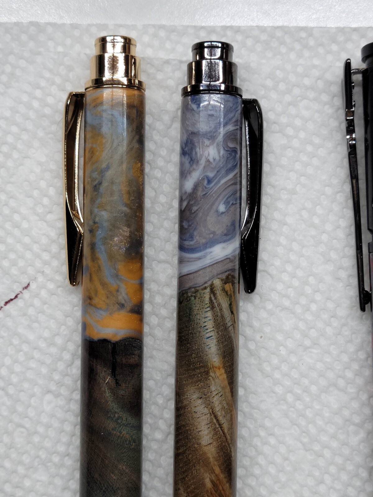

This is a tough one for me. I feel like I should know this better by now, but I can't find the right technique for this yet. I've bought some beautiful blanks with such deep vibrant colors, but the colors come out looking terrible on the finished product. Painting just isn't cutting it. Maybe I just need to go with a paint colored similarly to the color I want to bring out in the blank. Perhaps the Rollester was not the best choice for these. I painted the blanks, one white and one black. I don't recall which is which, though.
The main thing that bugs me is with making Jr. style kits. With less meat on the cap barrel, it looks more washed out than on the main barrel. Has anyone tried painting the cap blank a little darker?

I've definitely read (and probably started) plenty of threads about painting tubes. I just find it odd that these would come out looking so washed out even with painting. Maybe I need to use something metallic to add some depth?
