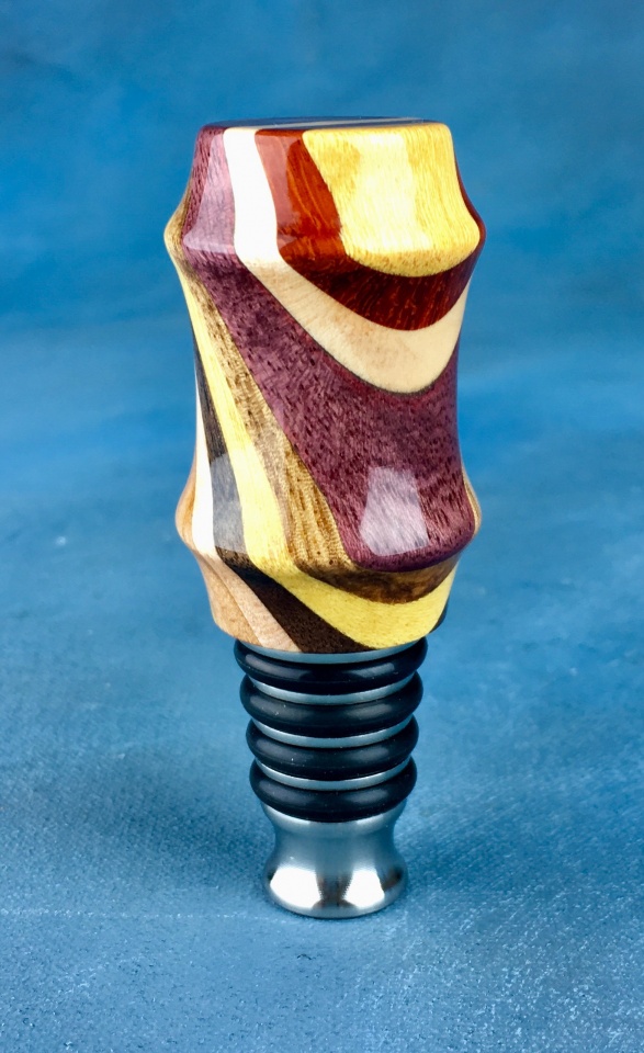

This stopper was sanded, finished, sanded and buffed to what you see in 15 minutes after turning. It received four thin coats of CA followed by accelerator, then eight coats of pen finish CA with accelerator after each coat. The pen finish is quite a bit thinner than medium CA and is easier for me to sand.
Your mileage may vary...
