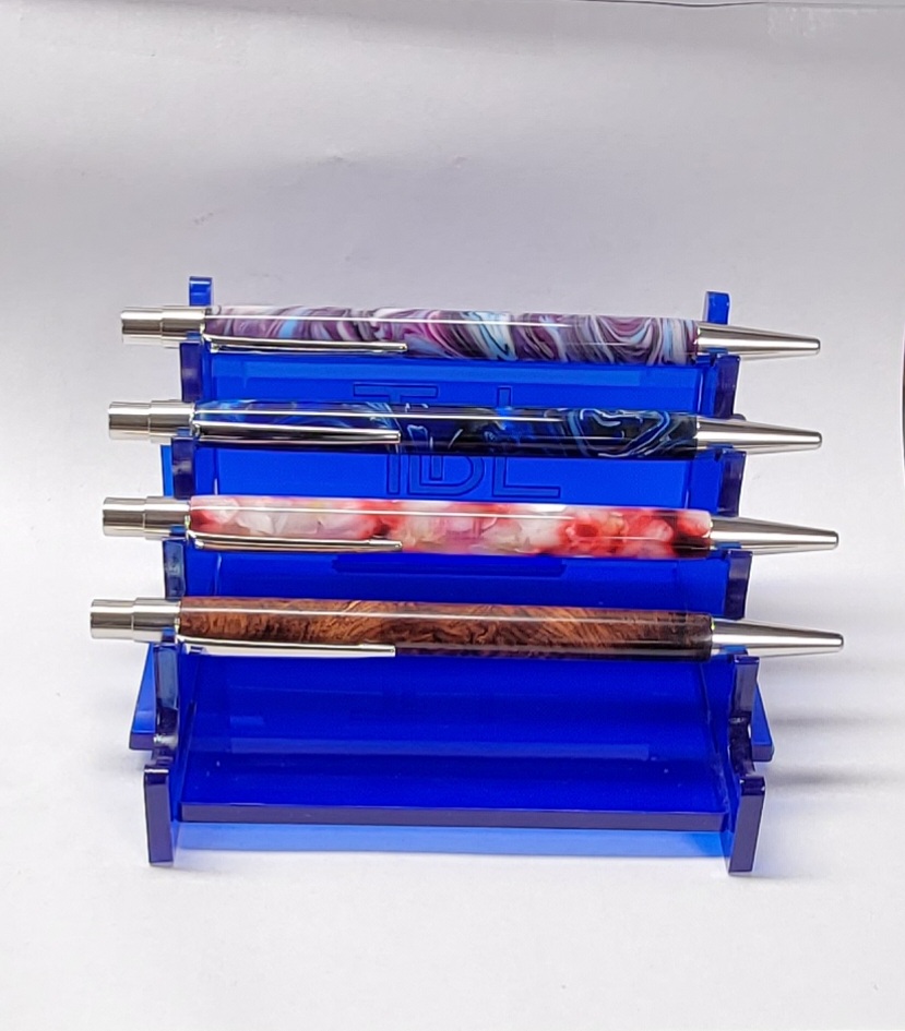

Hello,

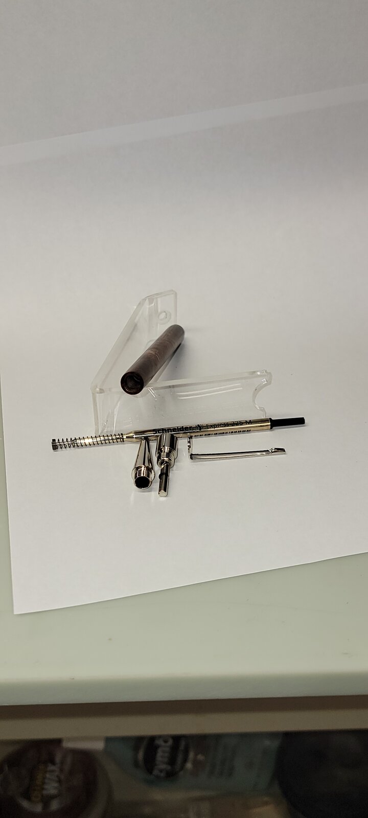

I found an earlier post from a member @wimkluck using hardware acquired from Germany and I liked the looks of it, so I started searching to find where to buy it. I found the site and corresponded back and forth with the owner with questions about sizing and the refills.
I decided upon the Berlin clickers without tubes or threaded inserts shown below and some of the other kits.

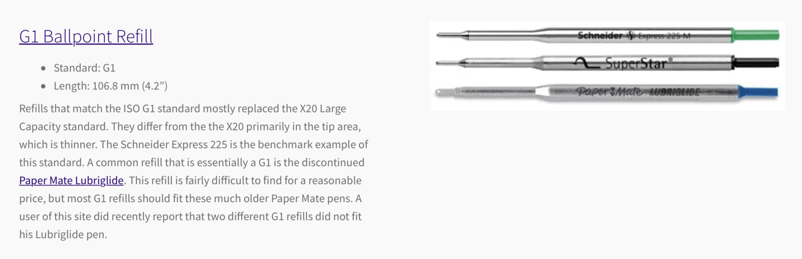

The Berlin uses the Schmidt SKM-88 and has threaded nose cone of the same thread as clicker. The hardware is .356 at the nose cone and around .352 at the clip and click mechanism. So it's quite thin. It achieves this thin diameter by using a non-standard G1 type refill. Papermate was the original maker of this style but discontinued them. Apparently a German company manufactures them now under the name Schneider Express 225. They are somewhat hard to get in the states, so I bought 50 at the same time as the hardware (and will buy more next time I order).
I have previously made several custom click pens using the Schmidt click mechanism and making my own threaded nose cone. But the nose cone for the Berlin is Top notch and I don't have to spend 2 hours turning, drilling, sanding and polishing. So I can make a quality thin click pen that looks custom but I don't have to charge custom pen prices.
Time will tell if the refill is an issue. But so far it writes great.

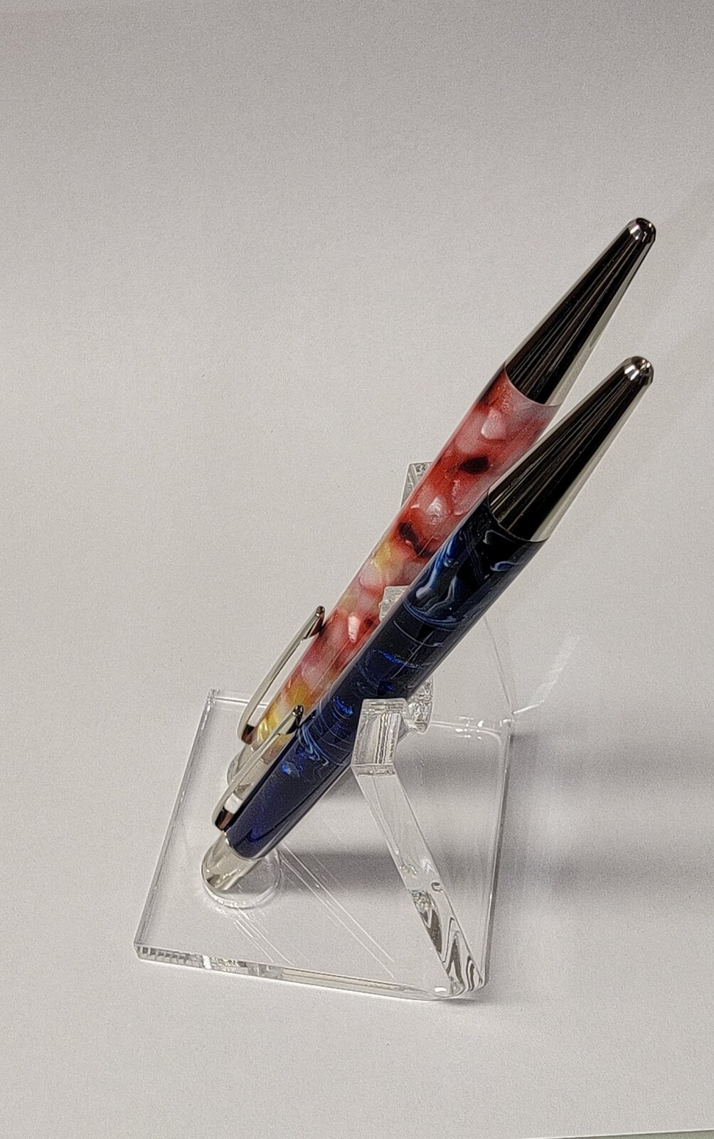

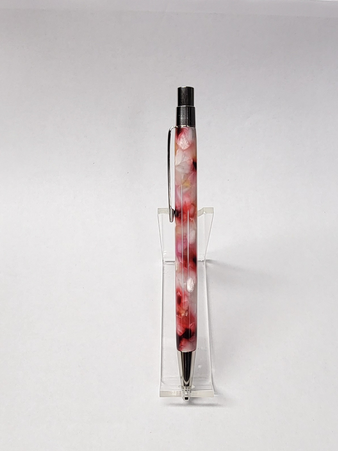

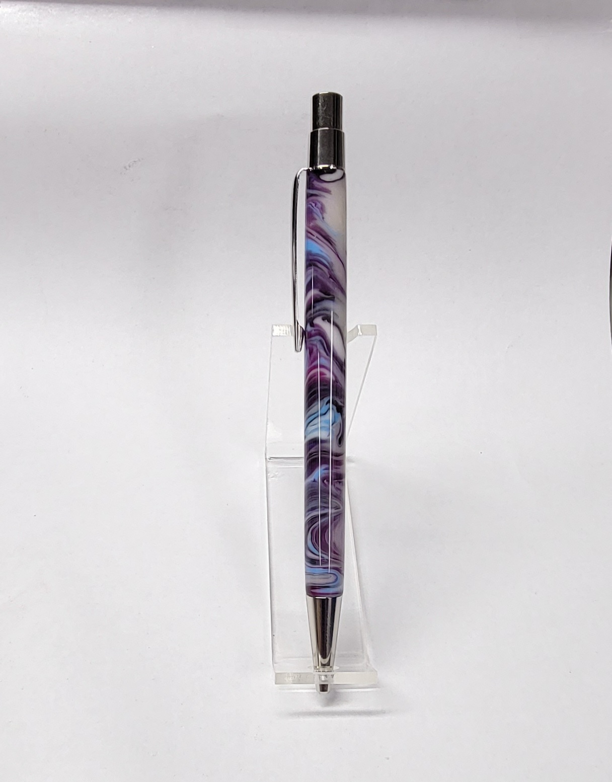

The purple pen is from the Pensmiths aka @Racer3770 called Wonka Berry

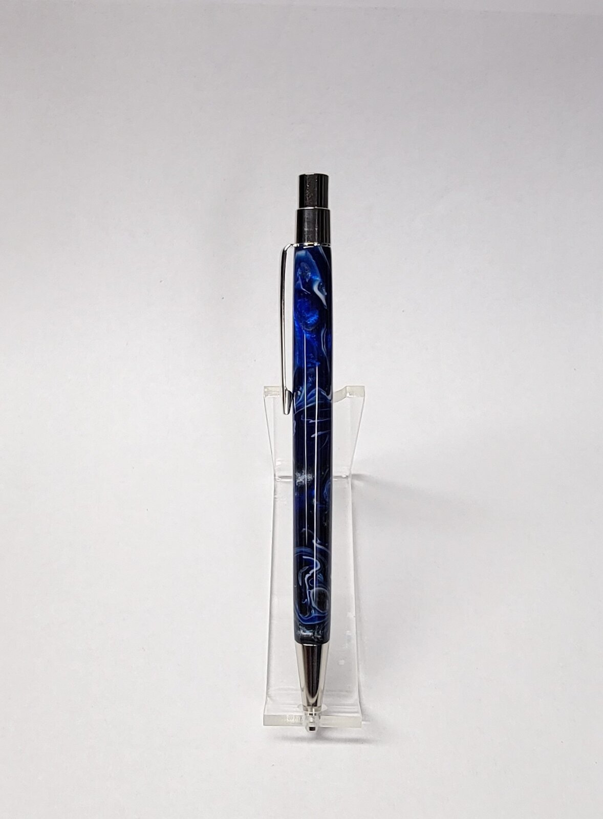

The blue pen beneath that is also from the Pensmiths called Blue Steel
The pink/red pen is Erinoid from The Turners Workshop in the U.K.

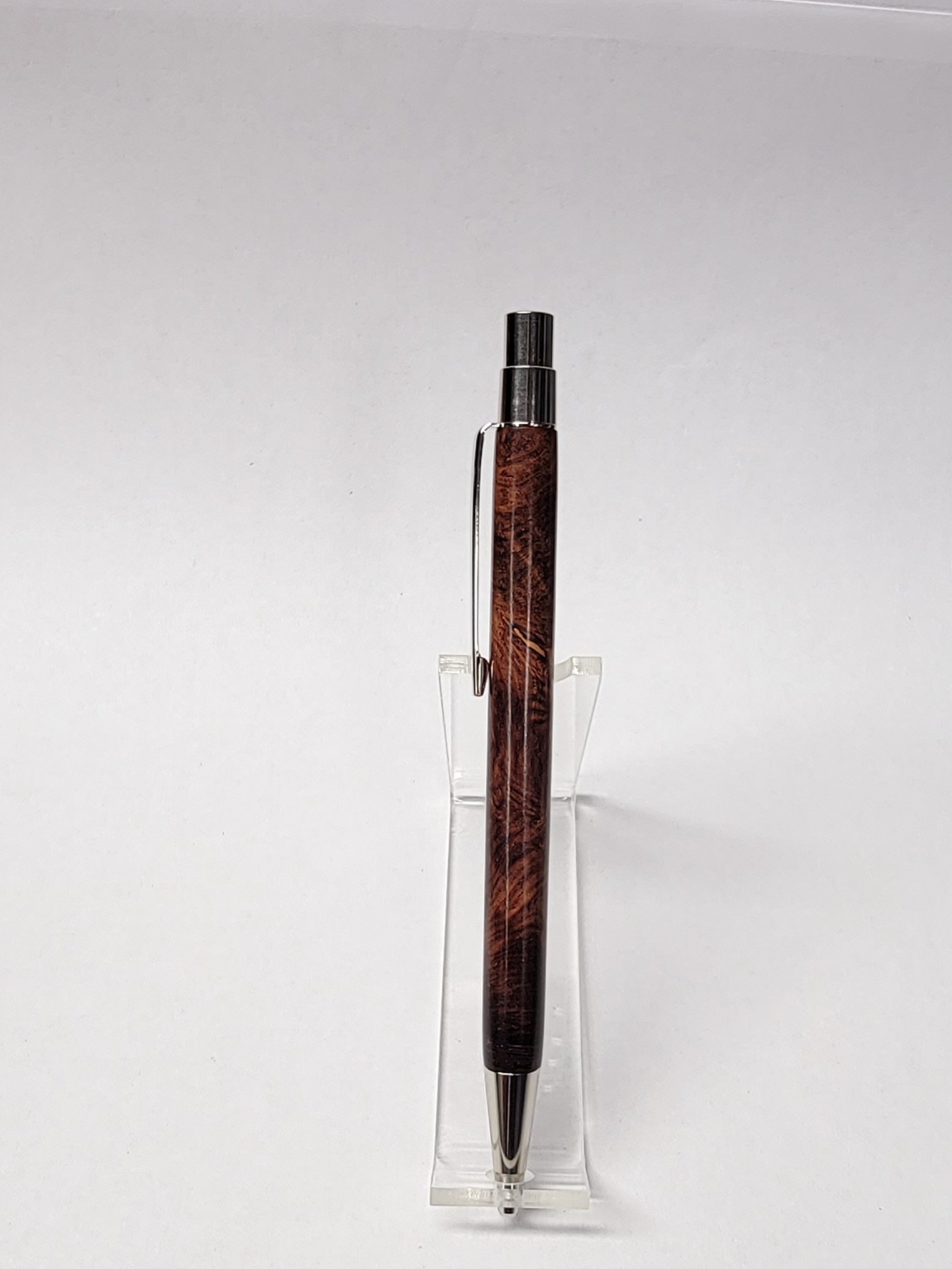

The wood pen is Honduran Rosewood Burl, no finish applied.

They offer 3 options actually:
Berlin with no tubes or threaded inserts - this is what I chose. You simply thread both ends of the body
Berlin with threaded tubes. The tubes are heavier than typical tubes. Basically 8mm O.D. tubes but Thicker to allow for threads.
Berlin with threaded inserts. Basically short threaded tubes.
I chose the no tubes or inserts option because I already very familiar with threading and already have tap and bits.
PLUS - the wall thickness is very thin if you use tubes or threaded inserts. Tube and inserts are approximately 8mm/.315 and the nose cone is approximately 9.05mm/.356. So super thin.
With the option I chose, I drill a hole a little over 5mm (can't remember exact bit I use off top of my head) all the way through. Then 6.25mm drill bit at each end. Then tap it. So pretty thick walls.

I'm a little worried about the refills being so expensive here, so that's why I bought 50. LOL
Yeah, me too. The best I could find was Amazon 10 refills for $30. And that is by searching for Schneider Express 225.
So my solution was to buy 50 extra in advance and sell to customers at 5 extra refills per pen, or something similar. And I'll likely be buying a lot more when I re-order. The refills cost a little over a dollar per if you buy from him.
