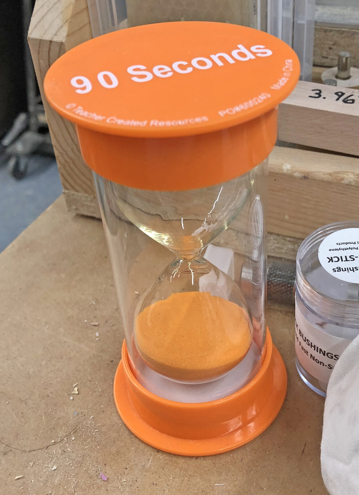

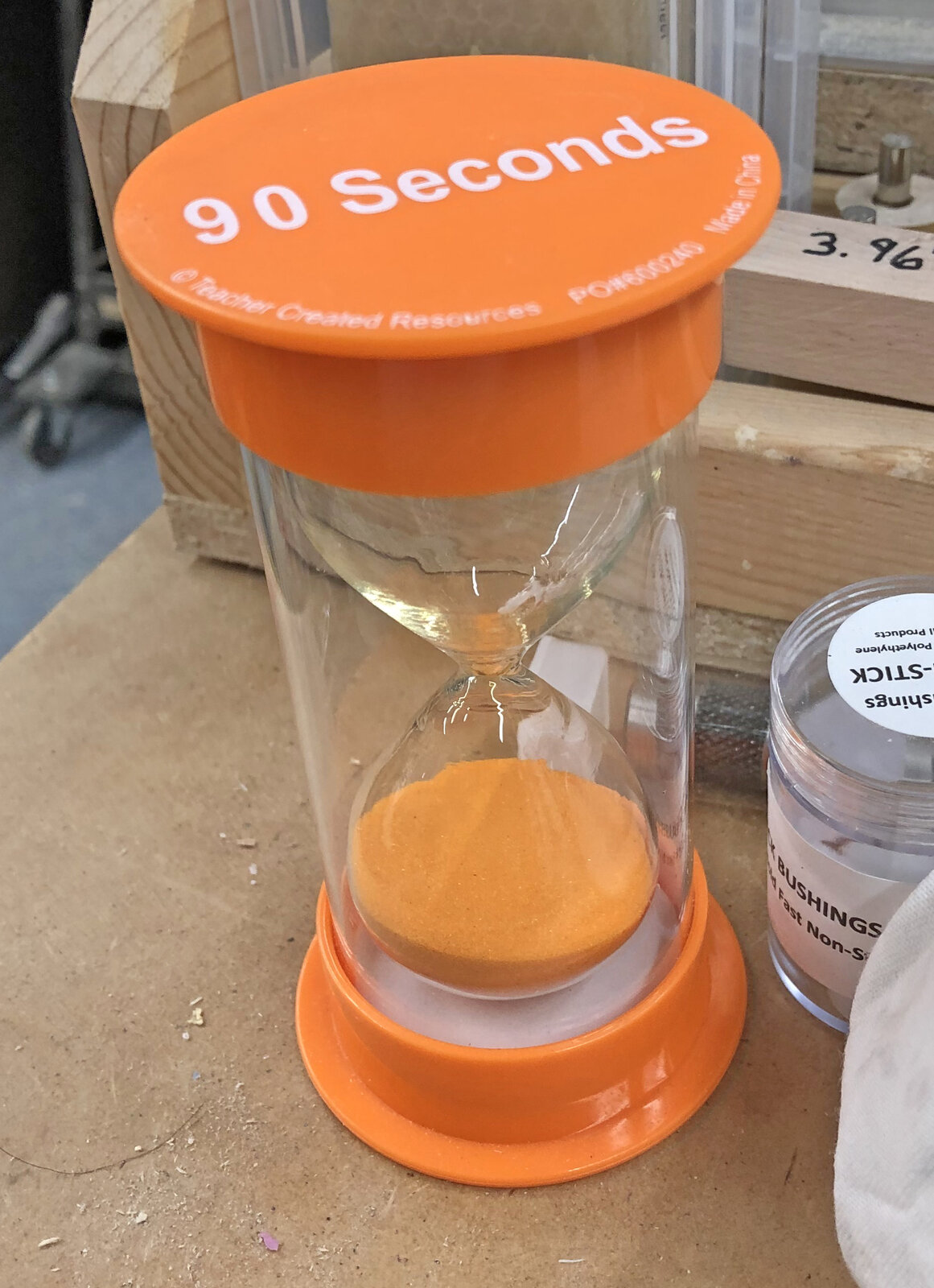

I just looked up the digital hour glass. Not to get off target with the original question it's still a digital timer. Doesn't matter what shape it's in. So my question back at David is it a digital timer or an hour glass?
egnald
Jun 9, 2017
3,119
Columbus, Nebraska, USA
Here it is - it's 5 inches tall and 2-1/2 inches in diameter. - Dave
