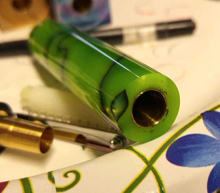

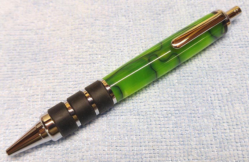

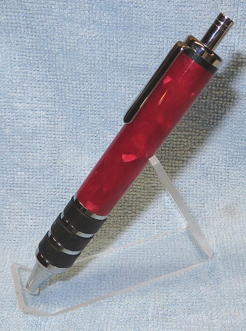

They're ugly, but the thickest I've ever turned are the Guardian Jr. and Guardian from PSI. They both use 8mm tubes, with the OD of the bodies being .625" and .555".
