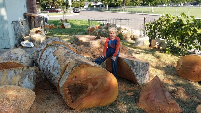

The owners took down the big sycamore that has been pelting the house with branches.

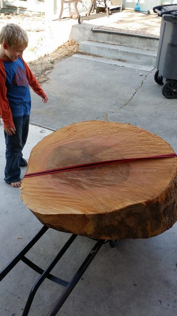

I saved off one big slice of the trunk to cut 6" turning blocks from.
This wood is wet and heavy!
What other pieces would you save?
I don't have much time. The owner has already told the neighbor they can take what they want for firewood.
How many pen blanks do you think that has in it?
Lots of logs to choose from

Be sure and seal the wood you get, so that it doesn't check too badly. You can use anchorseal, wax, or even paint.
There are a few interesting crotch pieces.. some with spalting starting..
The tree service is coming back today to grind the stump.
If they don't grind it down there is a big burl on the roots I plan to go after.
My wife already said NO to keeping more than a few pieces.
How long do I have before it starts to dry and check?

Quartersawn sycamore does make beautiful furniture lumber, but the main reason it is usually QS is because the wood is highly unstable. If you are not able to quarter-saw the pieces that you collect for your blanks, be sure to cut them way oversize because they will likely warp as they dry.

I would save as much as I could and tell the wife that it is free. Better then haveing to go and get it later. Paint the exposed grain and cover it with a tarp. Keep it out of the sun as much as possible. The tarp should be open on the ends until there is snow. Then cover it completely. After a year or so, then start cutting blanks. You will have a great time.

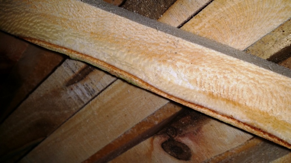

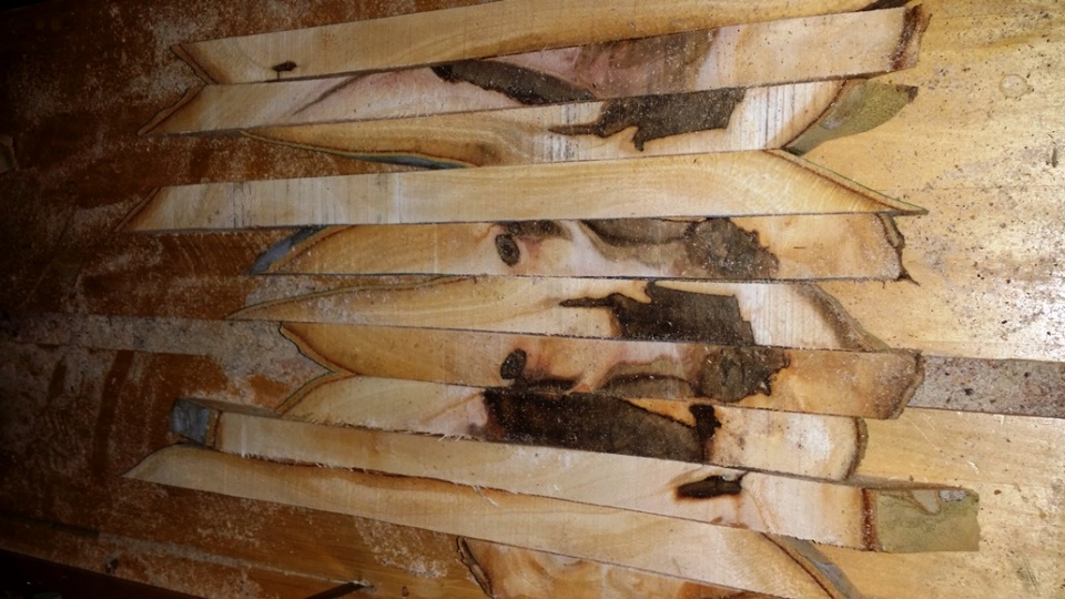

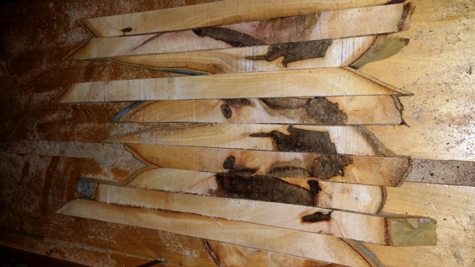

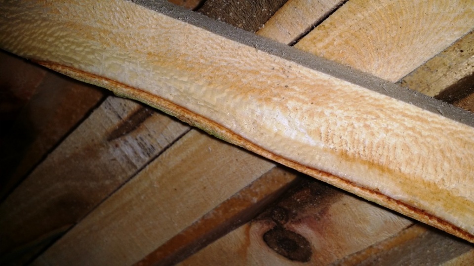

I found a 2-3" thick slice off a knot they sawed off so I cut it up into 1" blanks.
I'm not sure they will dry right or not but it's a peak inside.
Maybe I'll load up the big 10" vac chamber and see how good my vacuum pump is. I can get a good rolling boil on a quart jar of room temp water inside that rig.
