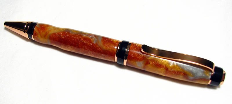

Do or do not, there is no try.. I have now moved up from Padawan to Jedi apprentice (ok enough star wars)... I know my skills have moved up a bit when I can turn acrylster w/o fear. I roughed this out with a gouge, then used a skew for most of it. It is molten metal on a copper cigar.

This is my favorite material and color! You did a great job, that cigar is spectacular. I have turned about a dozen of these and have only had one issue with breakage. I had one crumble when my pen mill dug into it. As always, it was mostly my error. Light cuts with sharp tools and you can't go wrong.

I came up with that shape as some people feel the cigars are too thick. It seems to give a good 'feel' that everyone likes so far. I suggest you try it Arthur.

Beautiful pen!! Nice kit choice with that blank! Acrylester blew out on me a few times until someone here said to not drill all the way through the blank. Now I just measure from the middle, (so where the pen meets matches up). Drill 3/16 or so extra, and cut off the end. No more blow outs since then. Round the corners off and use sharp tools.

PERHAPS, turning acrylester would be easier if tools were truly sharp. Can you cut paper with your tool? A tool that is sharp enough for cocobolo can still be a LONG WAY from acrylester sharp.
Just a thought, not a critique. I turn a LOT of plastics, if you are turning with a SHARP tool, the plastic looks wet. IF it doesn't look wet, the tool CAN be sharper.:D:D
