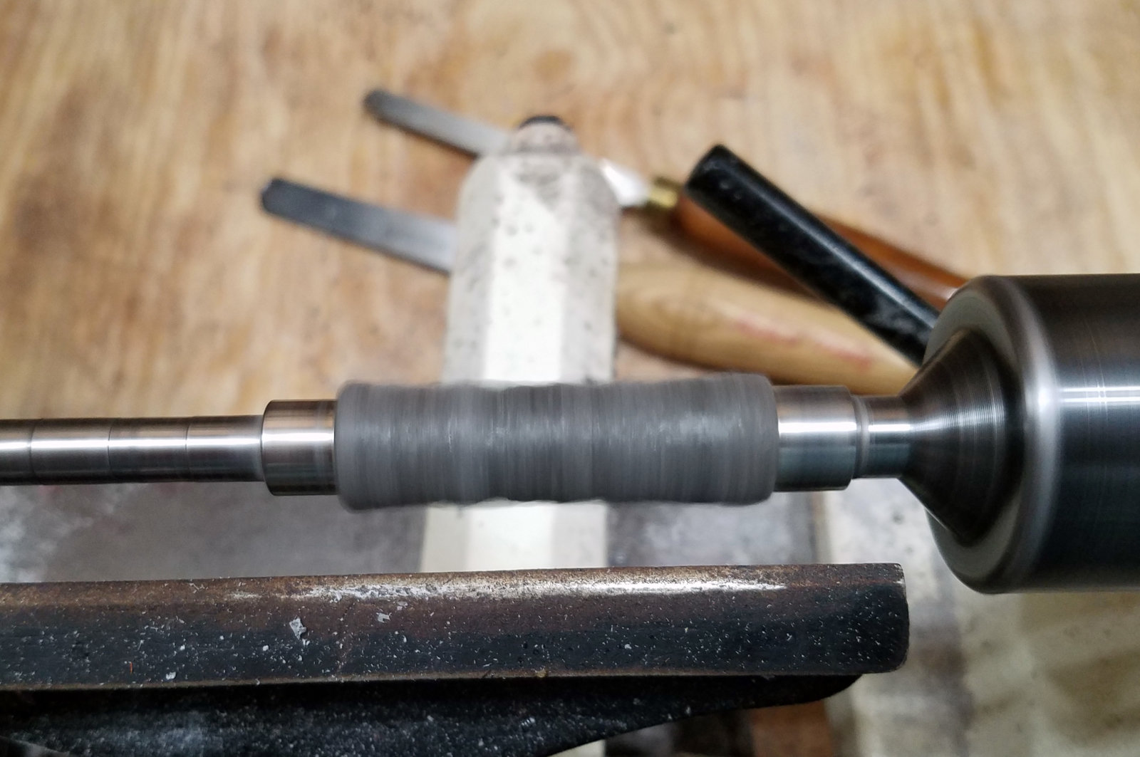

Here are two work in progress photos from when I was making the pen body barrel.
The first photo shows the barrel right after I finished covering it with shavings. At this point there was only enough CA (Cyanoacrylate or superglue) applied to keep the shavings attached to the brass tube. Also note that I am holding the barrel with another pen. Don't do this by hand or you will regret it. Trust me.
Once you have the barrel completely covered be shavings, you need to build up layers of CA until the CA completely fills in the gaps and covers all the shavings (at least 1/8" above the brass tube). You will need to do this slowly with thin layers of CA (I exclusively used thin CA for this project). If you cure thicker layers of CA you have a much higher risk of it burning when it hardens and turning white rather than clear. The curing spray causes a chemical reaction with the CA causing it to harden quickly and that releases heat. You just don't want it to get too hot so I repeatedly cure thinner layers of CA for best results.
At this point you will have an asymmetrical blob on a brass tube. It will look like something normally best stored in the bottom of the waste bin but that's ok. This is your diamond in the rough. The second photo shows when I first started turning the blob and it has all kinds of nasty lumps. You will need a very sharp skew or other cutting tool to start getting it into a rough shape. Just to clarify, when I say sharp the meaning is razor sharp that will cut hair off your arm. This will give you the best results. Stay patient and only take light cuts as you turn the cylinder down. It will not get very smooth due to the metal shavings in the blank so just get it to a symmetrical barrel shape as best you can. Take care when touching the blank while it is spinning on the lathe. The shavings in the blank can cut before it has been smoothed out completely so just be careful.
From here start working with 150 grit sandpaper and progress up to 400 grit. The meteor shavings contain iron and will rust quickly so do not use any water. WD40 seems to work best for me as a thin lubricant. Stop at 400 and inspect it for any inclusions or gaps in the CA. You will probably find plenty. Fill them in the best you can and repeat sanding from 150 grit to 400. Once you have a solid barrel, go up to 800 grit.
At this point you will need to apply a few clear coat layers of CA to protect the shavings from rust during daily use. I apply 6+ thin layers of CA and then go back to 400 grit to smooth it out. Progress up to 800 grit and then go through all the micromesh levels. Polish if you prefer and then carefully sand both ends flush with the ends of the brass tube.
