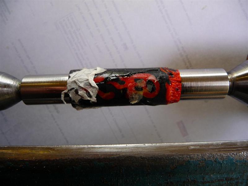

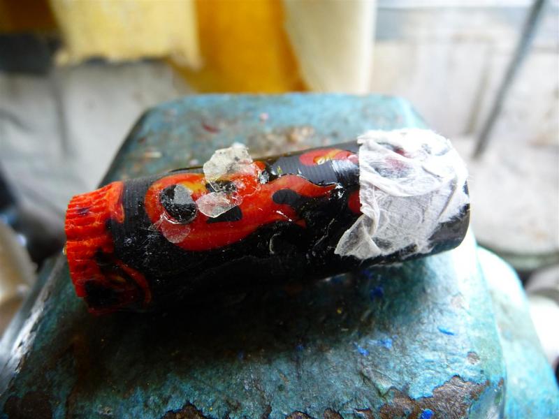

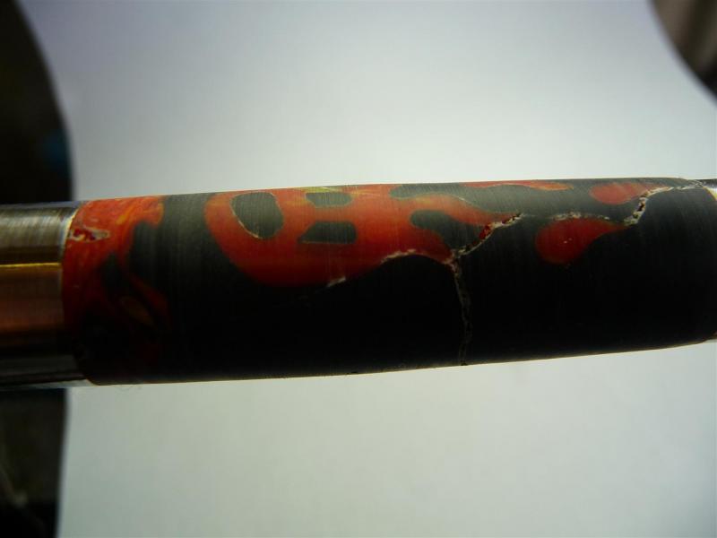

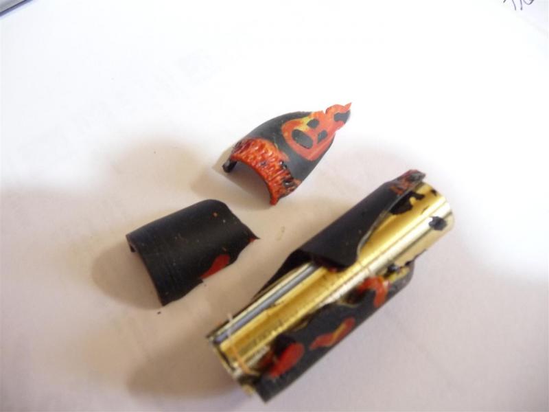

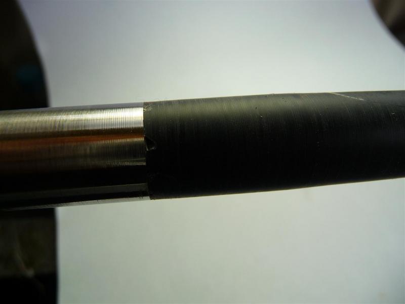

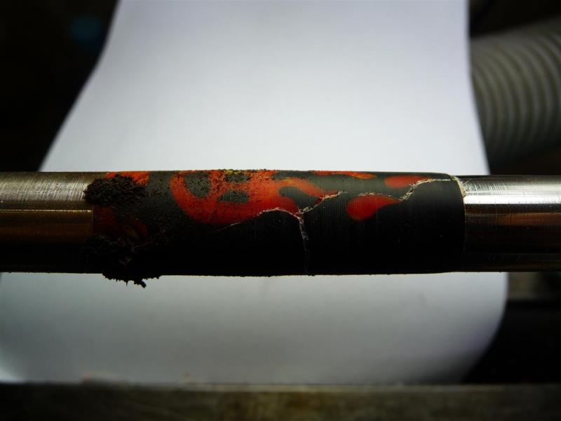

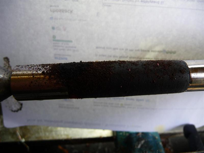

Ok, as promised, the story behind it all; there I was first thing in the morning, things were flying along very well, I lost concentration for a second and BANG;:eek::eek::mad::redface: see pictures 1 & 2; Well, after much searching found both pieces, by the way, the blanks had stacks of Epoxy, but I had spray painted the tubes, and the glue came away with the paint. So, with thick CA put the pieces back, my fingers stuck to the blank so had to pry them off and use some paper towel to hold the blank, that is why you see the towel pieces on it, pictures 3 & 4 ;

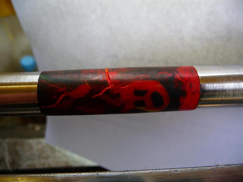

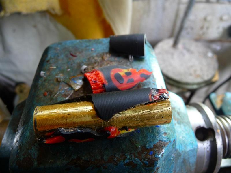

Now, in pictures 5, 6, & 7, I applied CA and Ebony sawdust to help fill the black portions that were chipped or missing.
