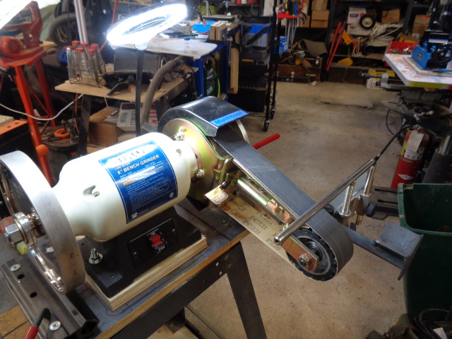

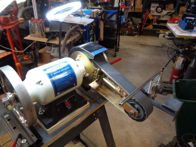

I finally got my Multitool belt grinder.Since I am not that good at free hand sharpening, I had to use parts from 3 sharpening systems.The Wloverine, Tormek and the Multitool.I hve already been using the Tormek and Wolverine together on my 8" grinder.So I modified it to fit the Multitool System.Now I can get a perfect flat grind on my Skew chisels.I hope it will be a little easier to use the Skew with a flat Bevel.I am still waiting for some finishing belts before I try it out.I would have went with the Sorby system But over 400.00 was a little high for me
